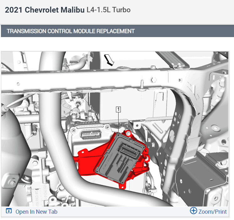

Where is the transmission control module at on the car listed above LT model.
Sep 9, 2024 at 3:21 PM
CERTIFIED EXPERT
53,855 POSTS

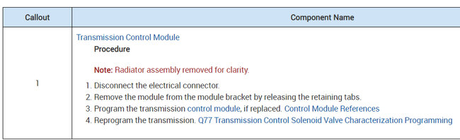

Sure, the transmission control module (TCM) is on the rear of the transmission near the main transmission electric connector. Here is the location and how to change out the TCM. Check out the images (below). Let us know if you need anything else.
