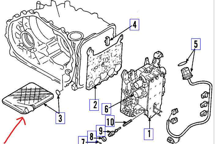

Transmission filter location?
2003 MITSUBISHI ECLIPSE
175 MILES • 2.4L • V6 • 2WD • AUTOMATIC
[email protected]
MEMBER
1 POST
FOLLOW
Where is it located and how do I get to it
Apr 8, 2026 at 11:30 AM
CERTIFIED EXPERT
53,855 POSTS
So the transmission filter is inside the case and is not serviceable. Check out the images (below). Let us know if you need anything else. Ken
