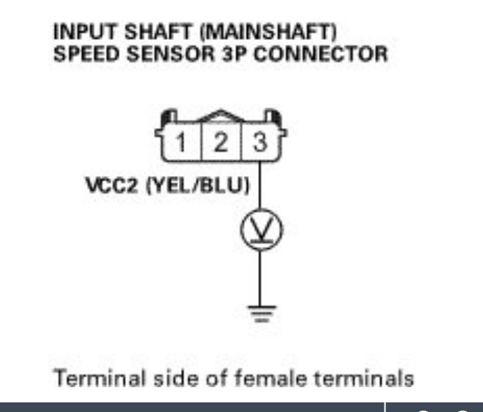

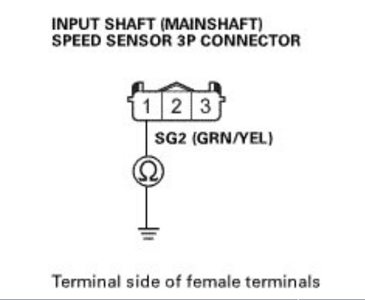

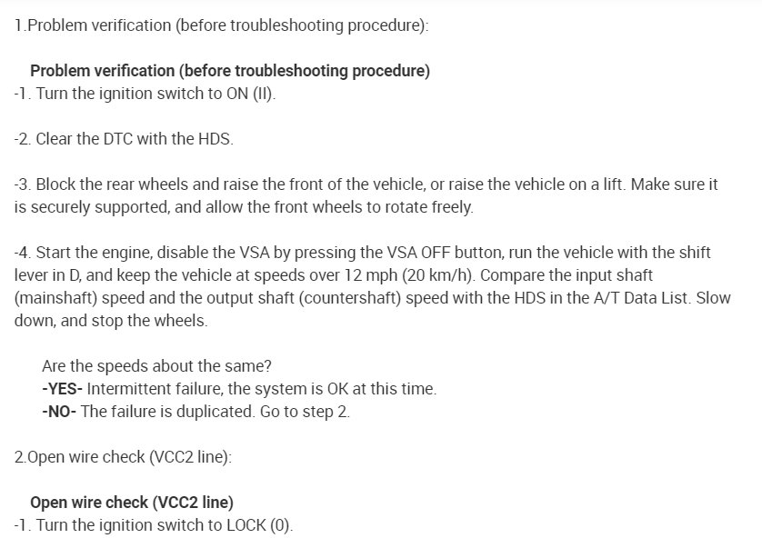

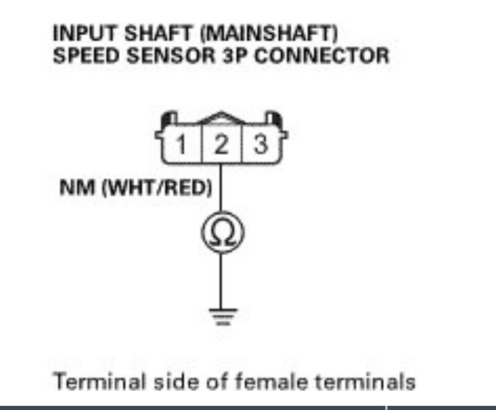

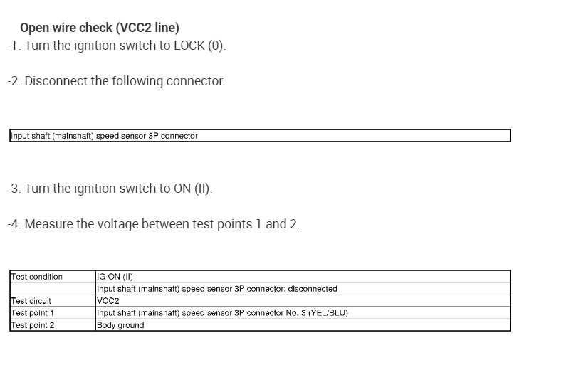

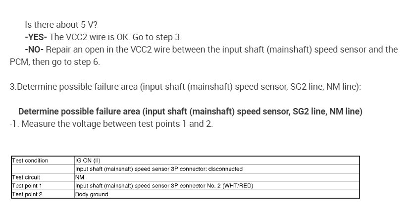

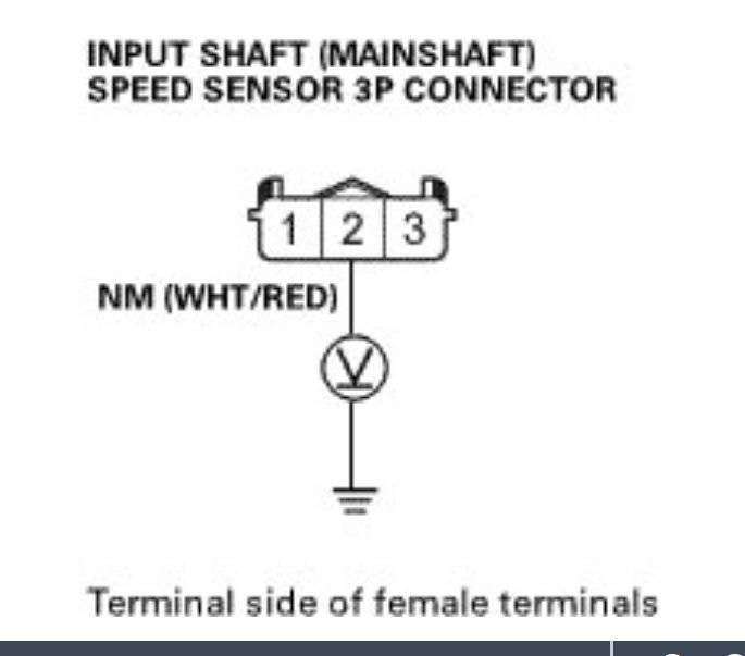

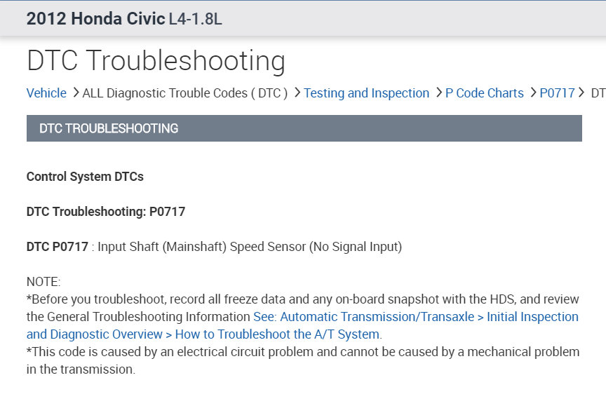

I understand automatics are frustrating, I've been dealing with it for three weeks already. My car was shifting and driving fine to my college but when I came back from where I parked it the car showed a Emission System Check display on the screen as well as a check transmission light. We first started by flushing the transmission fluid out and using Honda only fluid, restarted power and found out that when driving the D transmission option started to blink and my car did not shift past third gear. I went to do those free diagnostic for AutoZone and got the error code (P0717-Input shaft main shaft speed sensor (no signal input) three times. Now we switched the speed sensor but still does the same thing. I've read in some forums that some get lucky and it's the speed sensor but my speedometer works perfectly fine. The other options were some pressure switches for the third and fourth gear but when I check online I can only find a oil pressure switch. The other option is an infamous software update but that might be too far off it the same day it was working and half day started acting up.
Sep 24, 2020 at 10:54 AM (Merged)
SCGRANTURISMO
  • 4,897 POSTS

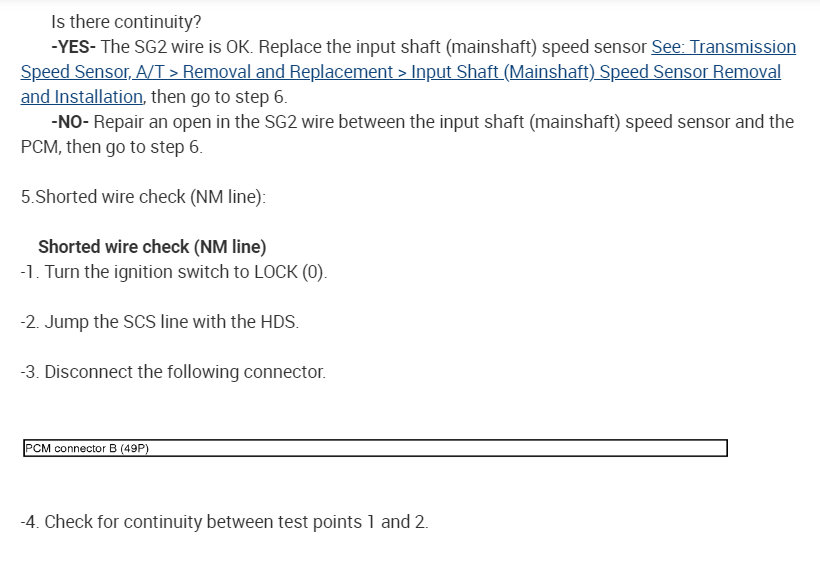

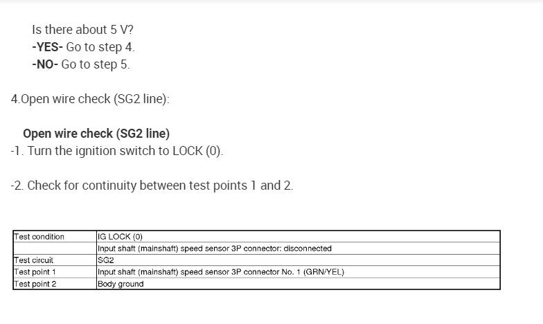

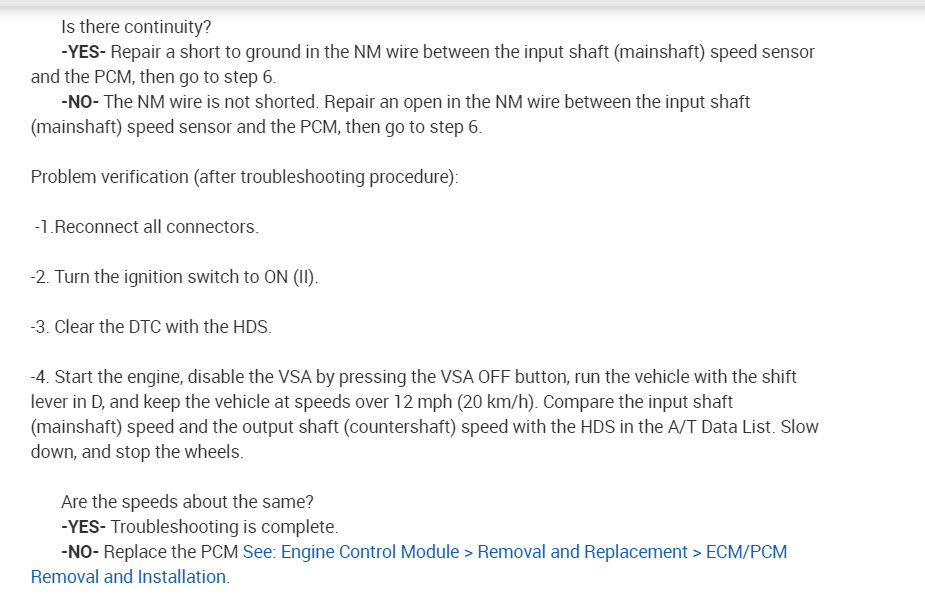

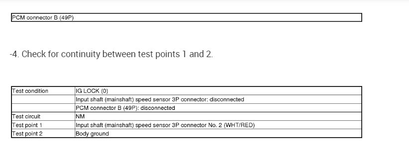

In the diagrams down below I have included the Honda factory diagnostic troubleshooting guide for Direct Trouble Code (DTC) P0717 for your vehicle. Please go through this guide and get back to us with what you are able to find out, or if you have additional questions or concerns.

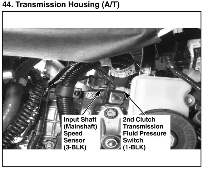

LSP1265
Where is the input speed sensor located on the car listed above LX sedan?
Sep 24, 2020 at 10:55 AM (Merged)
Welcome to 2CarPros.

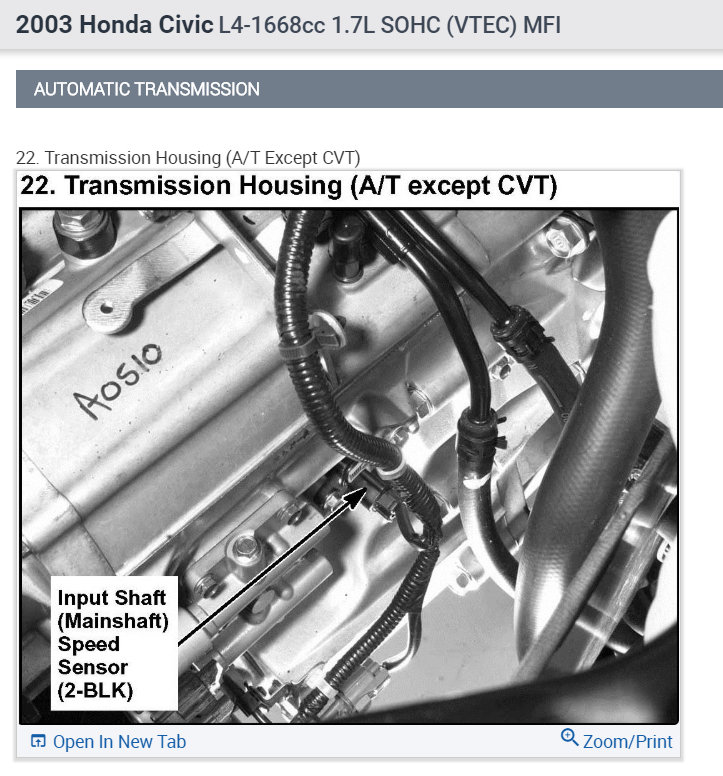

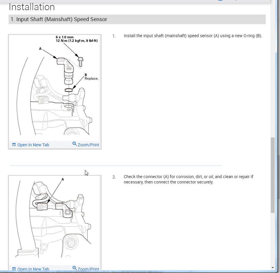

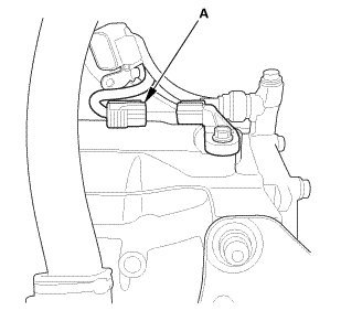

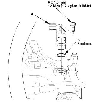

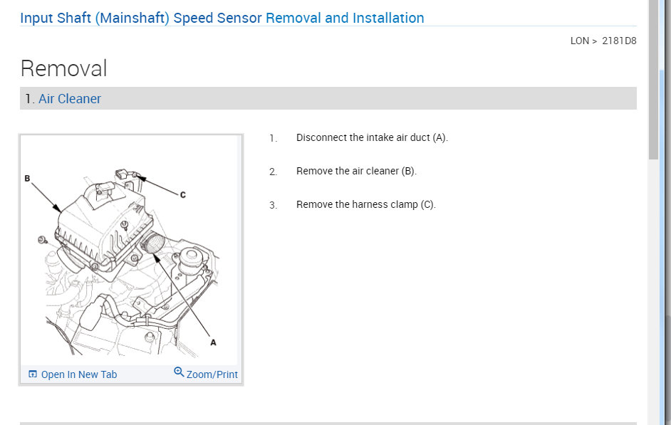

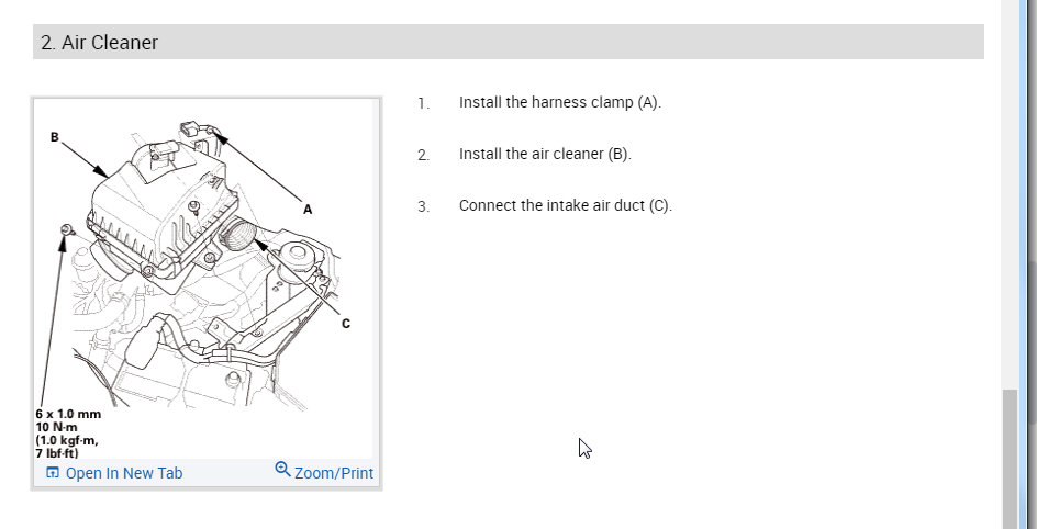

You have to remove the air box to see it. It's on the top of the transmission. Here are the replacement directions specific to your vehicle. The attached pictures correlate with these directions.
____________________________________________________________
Input Shaft (Mainshaft) Speed Sensor Removal and Installation
Removal

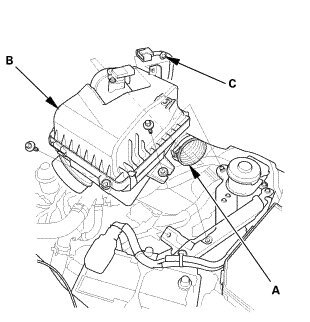

1. Air Cleaner
Picture 1
1. Disconnect the intake air duct (A).
2. Remove the air cleaner (B).
3. Remove the harness clamp (C).

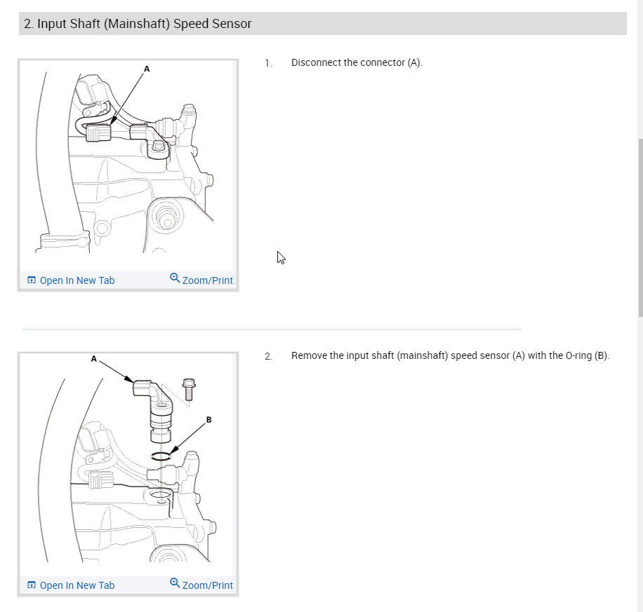

2. Input Shaft (Mainshaft) Speed Sensor
Picture 2
1. Disconnect the connector (A).
Picture 3
2. Remove the input shaft (mainshaft) speed sensor (A) with the O-ring (B).

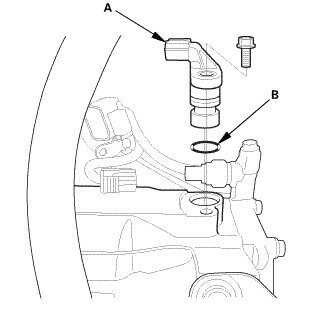

Installation

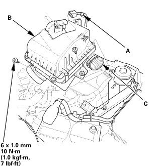

1. Input Shaft (Mainshaft) Speed Sensor
Picture 4
1. Install the input shaft (mainshaft) speed sensor (A) using a new O-ring (B).
Picture 5
2. Check the connector (A) for corrosion, dirt, or oil, and clean or repair if necessary, then connect the connector securely.
2. Air Cleaner
Picture 6
1. Install the harness clamp (A).
2. Install the air cleaner (B).
3. Connect the intake air duct (C).
___________________________________________________________________
Let me know if this is what you needed or if you have other questions.

JRHACK
Where exactly on the transmission is the speed sensor?

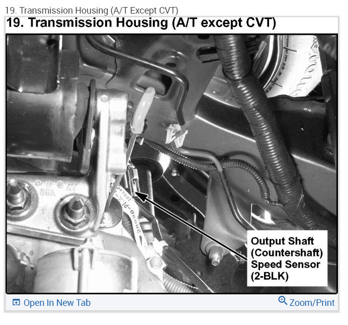

STEVE W.
  • 15,113 POSTS

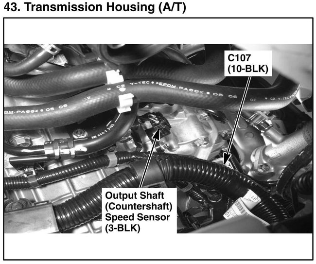

Which one? There is an input shaft speed sensor and an output shaft speed sensor. The input sensor is on the side of the transmission and monitors the main input shafts speed. The output shaft speed sensor is on top of the transmission.
What is the issue you are having?
JRHACK
it is the output speed sensor.
JRHACK
thank you Steve.
STEVE W.
  • 15,113 POSTS
That one is easy to get to. Speedometer not working or issues shifting?
