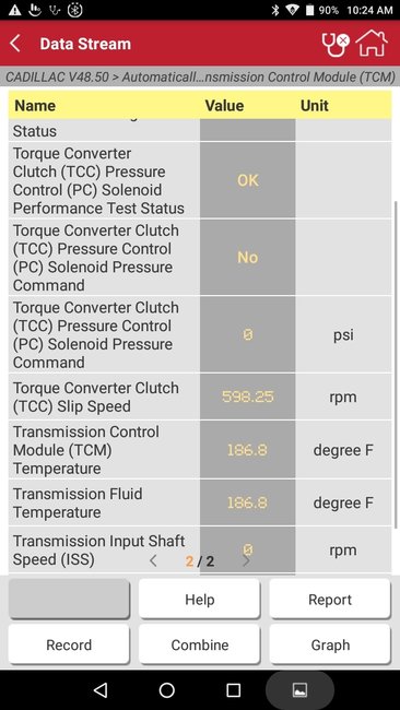

At this point the car would still shift into gear. I went ahead and reset the codes and to my surprise the car would not go into gear anymore after resetting the codes. i thought i was stuck there for good but after digging on the X431 Mini pro i was able to select the transmission module and go to the special function and shift the transmission gears manually, i went one by one up to six until i reached highway speeds. My first impression was the drive shaft of torque converter was toast, but my question is, why would the car run if i manually command the computer to change gears on transmission? After making it home safely i made the terrible mistake of parking in my home garage, lol, I can't back out anymore. I had more time to put the scanner again and on the live data section i noticed something that I'm not sure if is normal. here it what i noticed:
Torque Converter Clutch
(TCC) Pressure Control
(PC) Solenoid Pressure Command Value = No
(PC) Solenoid Pressure Command PSI = 0
would this be the problem why not is shifting to any gear? no matter what gear is selected that never changed.

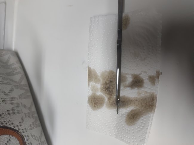

I have checked the oil and it looked black with some super small metal flakes.
here is a picture:

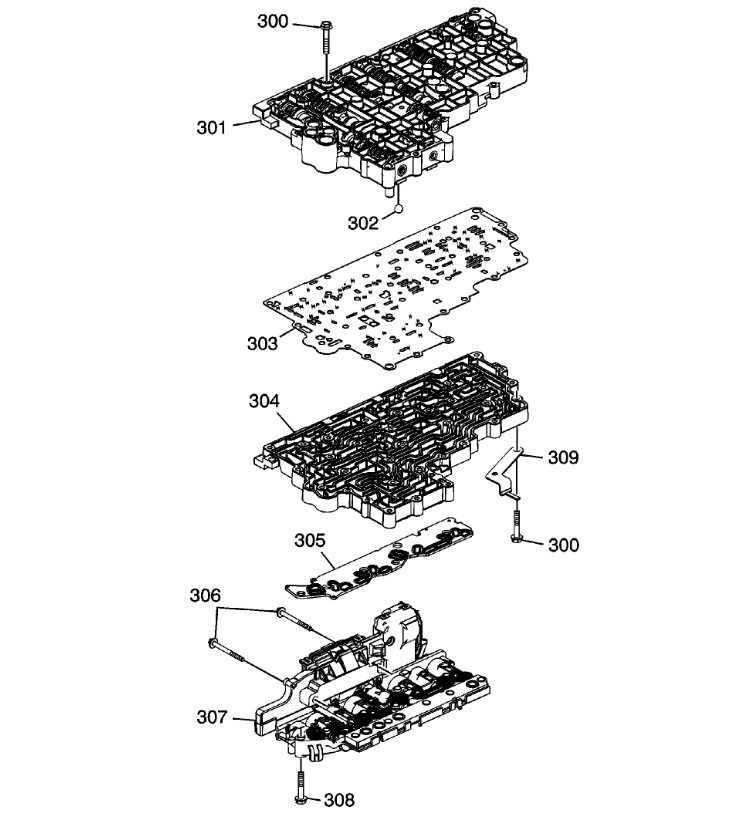

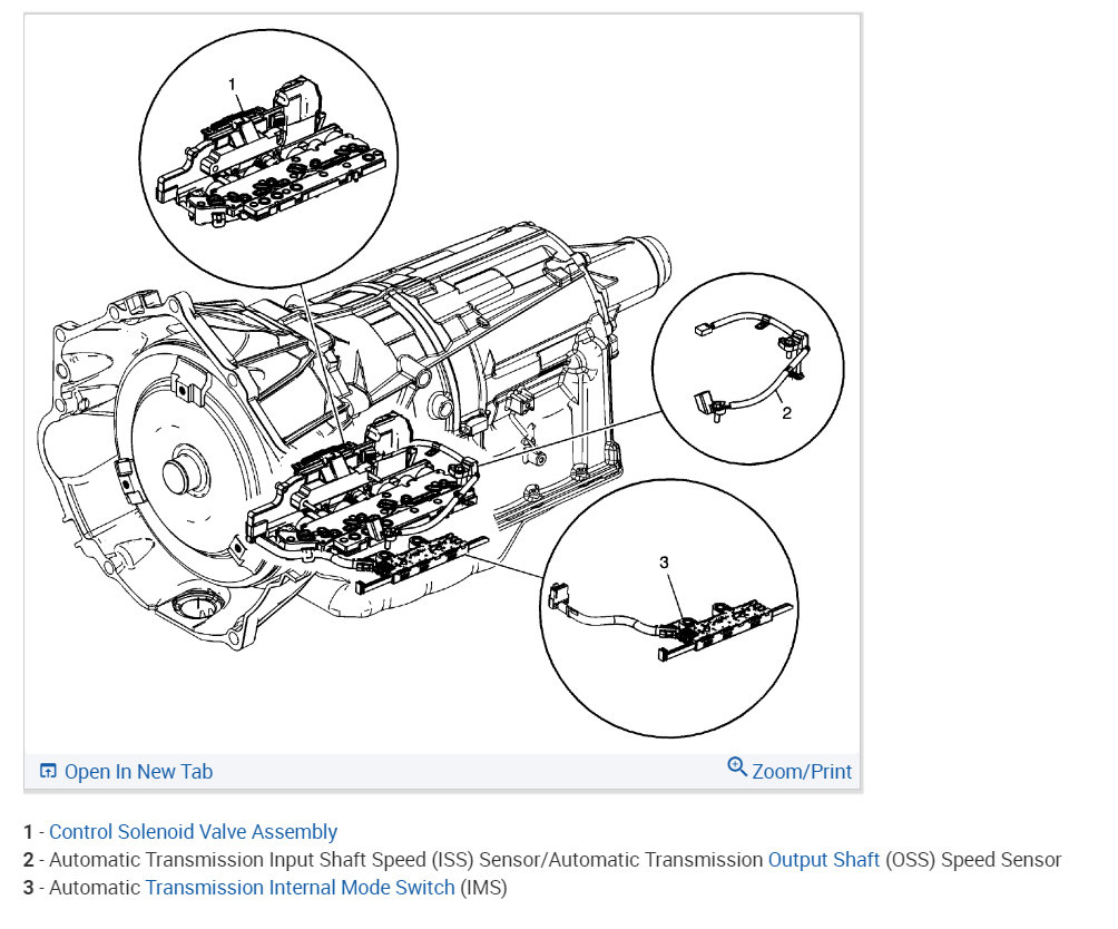

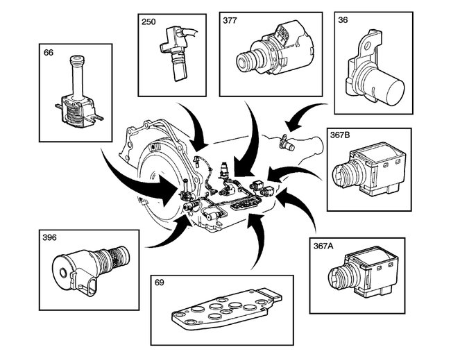

The transmission definitely needs to be serviced; this guide can help with diagrams below. also, the pressure control solenoid, this will happen if the fluid level was low? Here are the solenoid locations so you can replace them and at the same time install a new fluid filter with fresh fluid.

This guide will walk you through the transmissions service:
https://www.2carpros.com/articles/how-to-service-an-automatic-transmission
