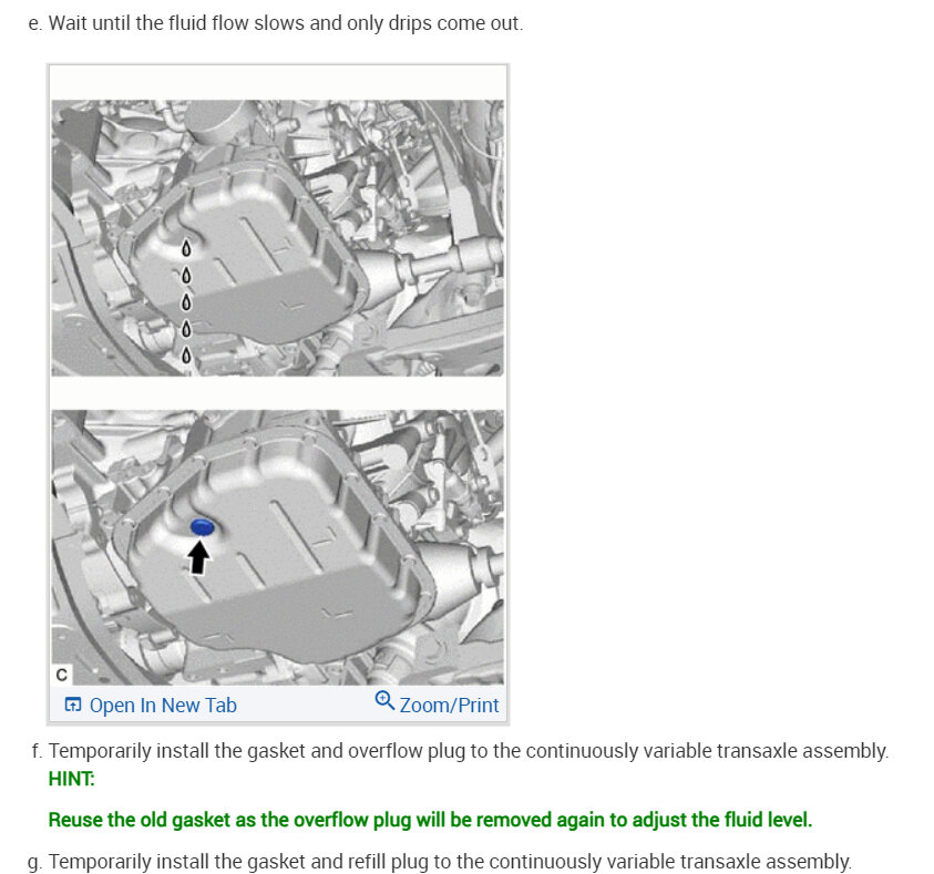

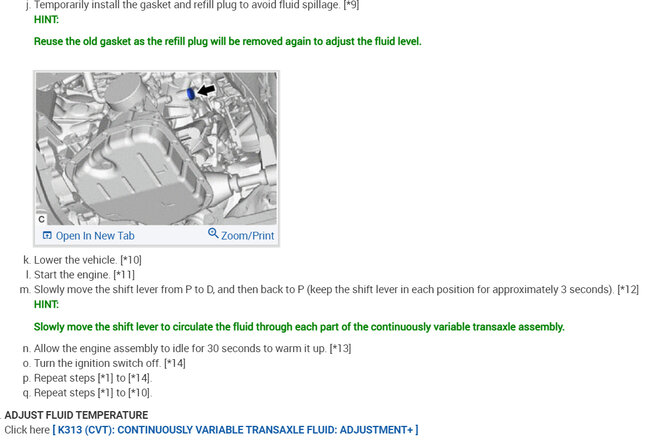

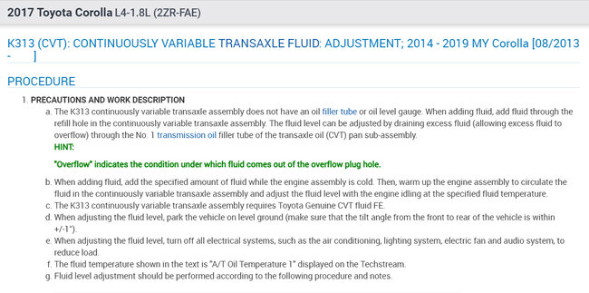

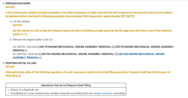

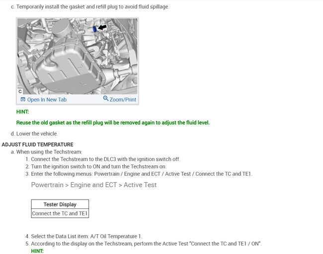

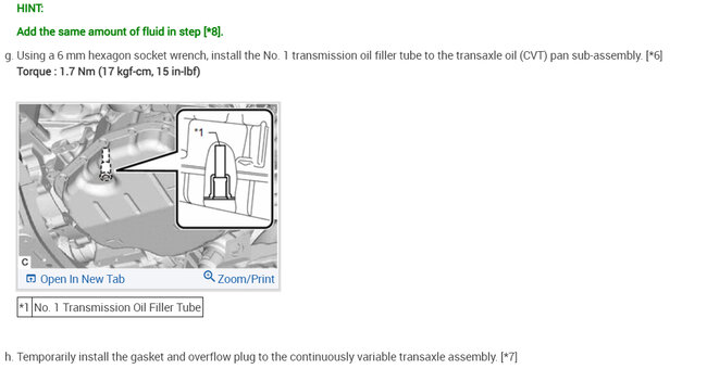

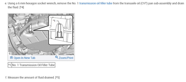

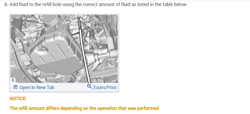

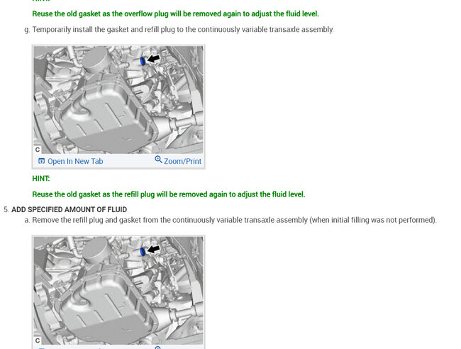

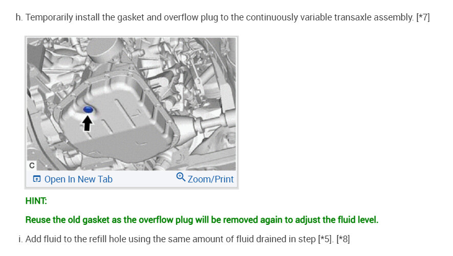

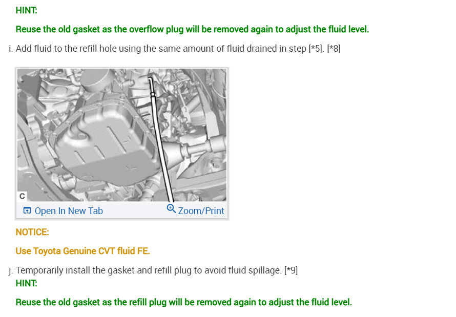

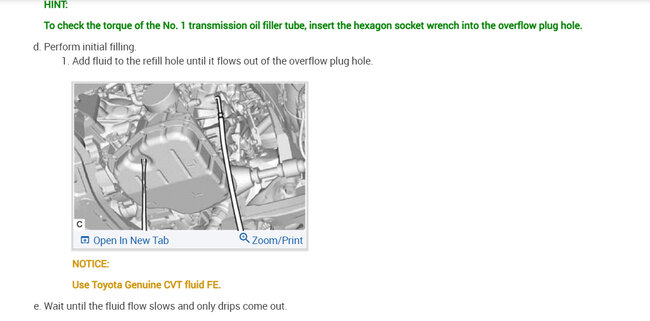

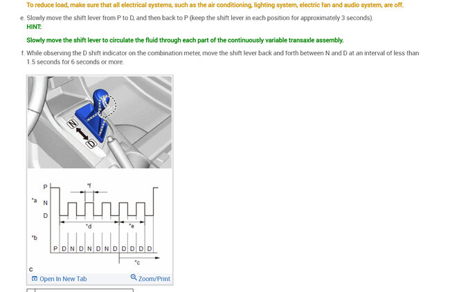

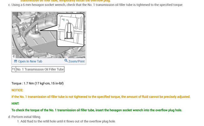

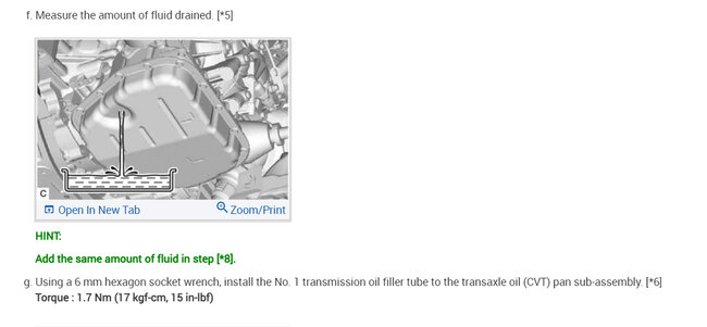

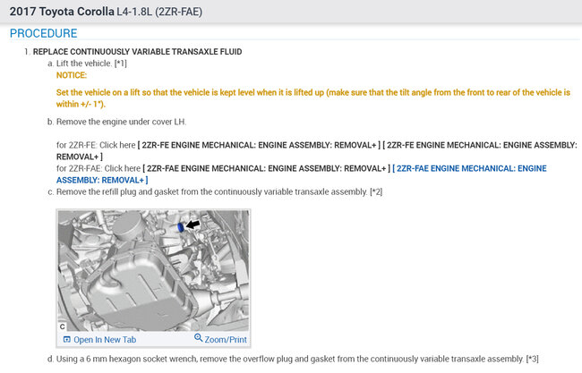

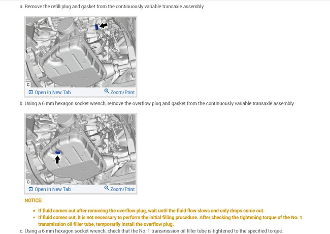

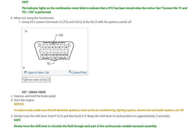

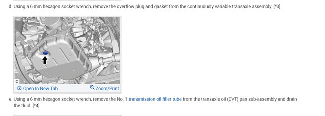

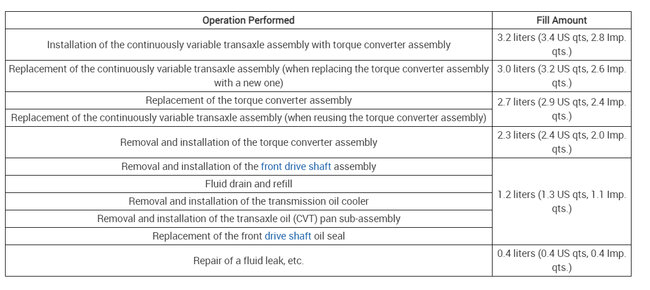

The first thing I would do is change the transmission fluid, here is a guide to help and instructions for your car in the images below:
https://www.2carpros.com/articles/how-to-check-and-add-transmission-fluid
and
let's run the codes as well to see if anything comes up.
