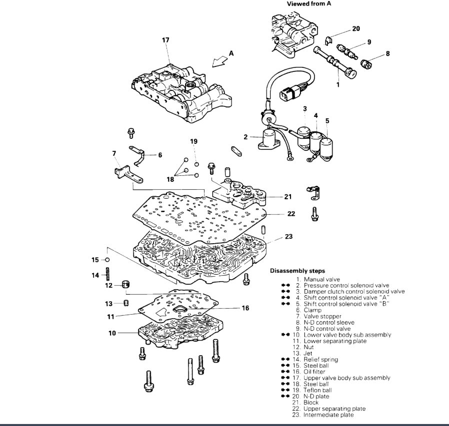

It sounds like you have a pressure control solenoid that is not working right, do you have a check engine light on? Here is a guide and diagrams below to show you the solenoid location:
May 20, 2019 at 11:30 AM

I did have previously error code P1750. I replaced the solenoid pack already and there are currently no error codes on my car
May 20, 2019 at 3:06 PM

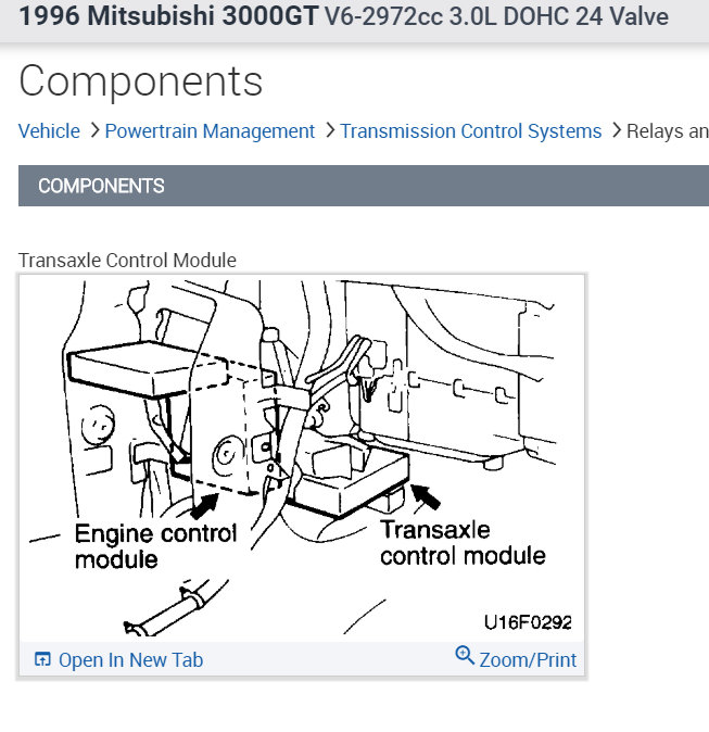

Could it possibly be the TCU?
May 21, 2019 at 6:20 PM
Yes it can be. lets try swapping it out for a used or rebuilt unit. Here is the location. Check out the diagrams (below). Please let us know what happens.
