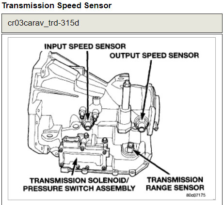

SHANEDCAT
my 2003 dodge caravan has the obd2 code p0725 come up speed input sensor parts store say they only have one sensor but manuel says there are 2 are they the same
Jul 6, 2020 at 1:55 PM (Merged)
CARADIODOC
  • 34,308 POSTS
Yup, there's two and they are different. Input speed sensor and output speed sensor. They refer to engine speed and axle shaft speed.
BMRFIXIT
  • 19,053 POSTS
check the picture
