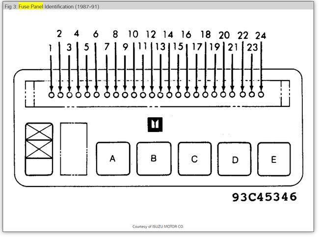

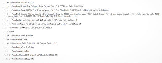

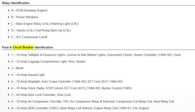

We need to fix the check engine light first so we cab see what codes are in the system you might have a bad ECM. There is a 10 amp fuse that controls the check engine light in the C-10 slot can you check it please?

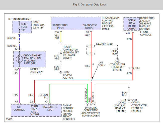

That could be a problem or the light is out. Can you check for power at the blue and yellow wire headed into the cluster for power when the key is on?

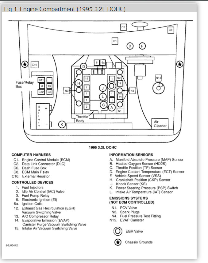

I have a TPS sensor coming but could it be the camshaft position sensor and where is it located??

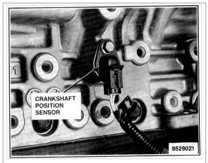

Sorry for the late response. I think you are right with the crankshaft angle sensor here is its location and guide to show you what you are in for when doing the job.
Mar 3, 2018 at 1:22 PM
GO20JETS
  • 9 POSTS
Yea, we already did that. We're gonna try the ECM. I'll let you know.
