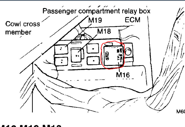

It is located in the passenger compartment relay box. I've attached a picture below and circled in red.Here is a tutorial showing how to test a relay:

Thanks Danny! I found it and got it replaced. Working fine now. I appreciate your help!

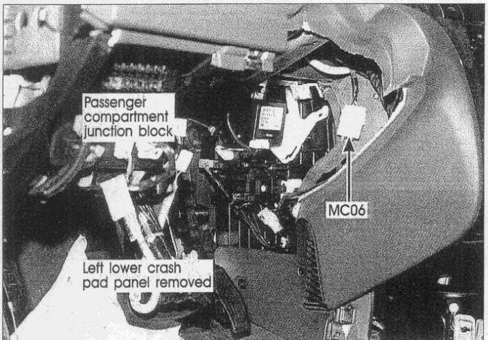

In under the dash fuse box or Relay is located behind the glove box or Found turn signal flasher above steering column on drivers side.
https://www.2carpros.com/forum/automotive_pictures/55316_fl34_2.jpg

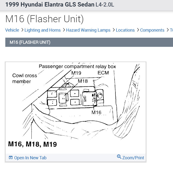

you only have one flasher, for both the turn signals and the hazard flashers (m16). Check out the diagrams (Below). Please let us know if you need anything else to get the problem fixed.

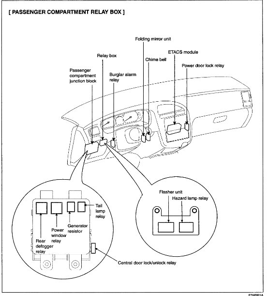

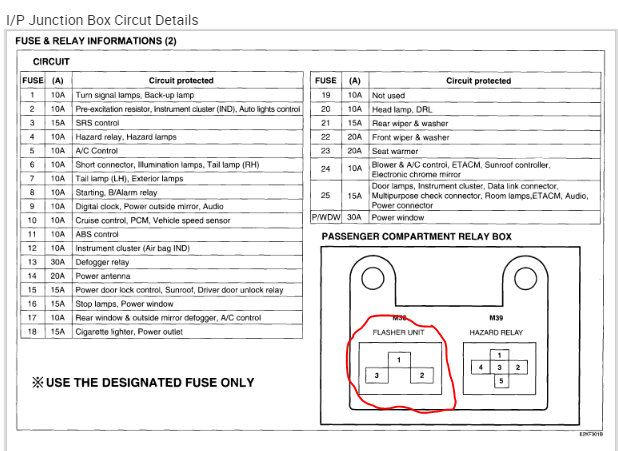

DANNY L
  • 5,648 POSTS
Hello, I'm Danny.
I've attached pictures below of its location as you requested.It's located in the passenger compartment relay box in location #M18. I've circled in red.Hope this helps and thanks for using 2CarPros.
