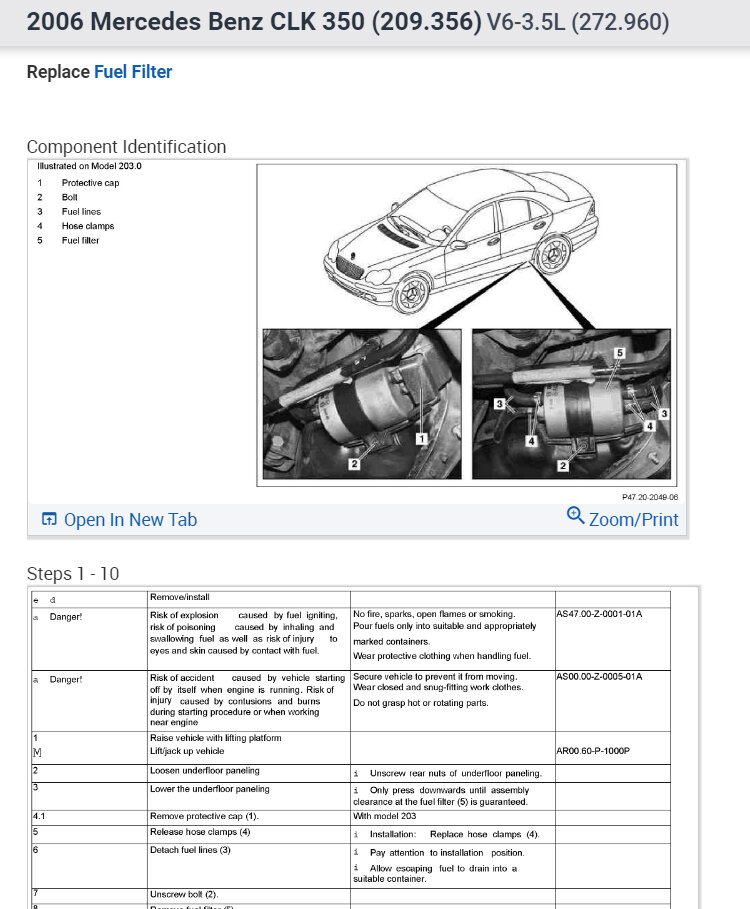

I need to replace my fuel filter and I can’t locate it. My car wasn’t listed in your database, it’s a 2006 Mercedes Benz CLK 350.
Nov 6, 2022 at 10:35 AM
CERTIFIED EXPERT
53,855 POSTS
It looks like the fuel filter is under the car on the driver's side rear. here is an image of the location and instructions on how to replace it. Check out the images (below). Please let us know if you need anything else to get the problem fixed.
