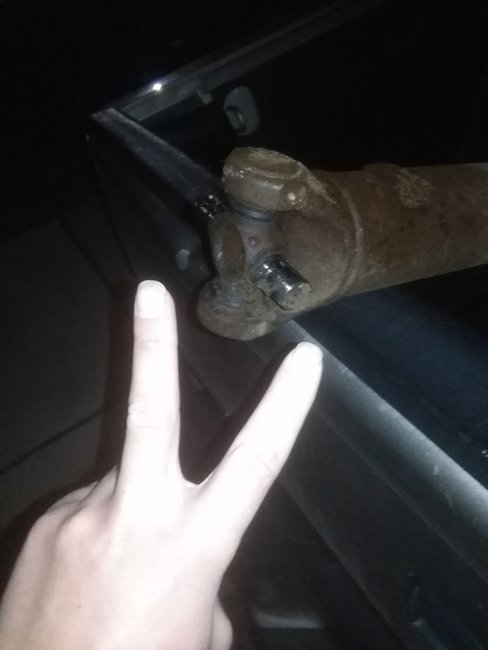

okay guys and girls, I have the vehicle listed above, the drive shaft fell off i am replacing it but the 2002 drive shaft has a different yoke connection. anyone know where to go for what I need? for those wondering my 2003 has a connection that doesn't match the 2002 drive shaft. i have called and visited 5 places today , sorry sir we don't have that, or my favorite that cannot be done.....

Could you take a picture of the two parts? The 2002 and 2003 used the same drive lines unless you have a part from a long wheel base going into a short box or a 4 cylinder with a manual transmission. How did the shaft fail? U-Joint or?

okay, Steve thank you for the question... the question... the picture with two fingers is the 2002 drive shaft... the other with three fingers is the 2003.. not sure how it failed, noticed a hard vibration then three days later on my local highway I watched from the review mirror the shaft drop, roll, and fly out. never found the shaft...

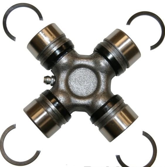

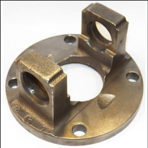

Okay. The failure is that the flange yoke on the 2003 failed and that let the U-Joint come apart. You are going to need a few more parts. First a new rear flange yoke like the first picture below and a new U-Joint like the second picture to replace the scrap one in your replacement shaft. Then you just need to unbolt the broken yoke from your truck. Remove the bad joint from the replacement shaft, then assemble all the parts to be able to reinstall it.

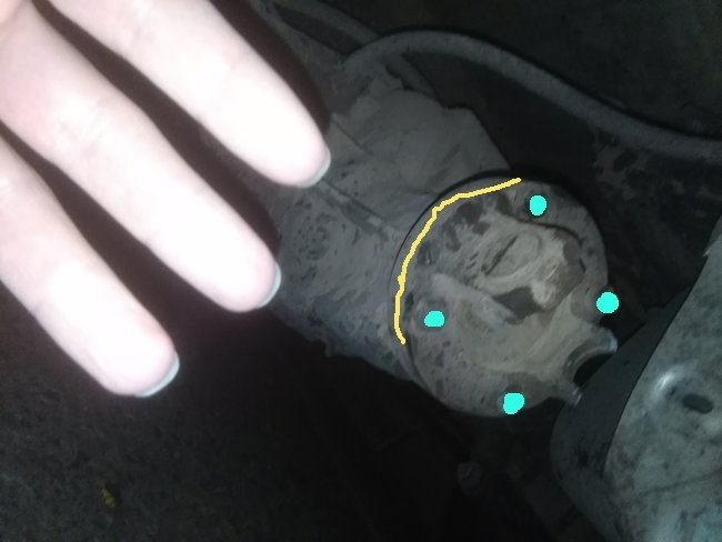

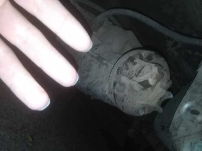

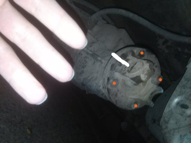

This shows how that rear yoke is bolted on. To start with you will want to mark the rear ends flange area so that you can install the replacement part so the U joint is in the same position it is now. See the edited one of yours. The orange are the bolts. You want to make the piece that flange bolts onto so the cap on the new U-Joint is in that same spot.

Now with that off clean the mating surfaces where the bolts go so there is no dirt or rust.

I liked to know where you got that picture of the yoke? that's the style on my truck. over the last weekend I beat the truck down got the broken parts off, counted the splines (27) a part by the number of 679-500 is in every system but its a (30) spline.
I'm having to look out side of Chevrolet to find this rear end yoke.so far i have made it to Dodge, but will the splines and size match up direct? i am tempted to burn my truck to the ground at this point.

That is a common GM part. Used on pretty much every S series. The piece in the picture isn't a splined part, it is a bolt on part that attaches to the yoke that is attached to the pinion gear. Remove the 4 bolts and it's off, you don't need to touch the adapter splined yoke on the differential.

Steve W. I had asked about that part because it's OE i found out yesterday from a buddy that my OE parts are no longer made and i would have to switch some things out.

There are millions of those yokes in salvage yards all over the world. If you want a new part you would need to look at places that sell 4WD parts and things like lift kits and driveline upgrades for one that is a bolt on. However for stock parts any salvage yard with Chevy S-10, Blazers, Olds Bravada, GMC S-15 or Jimmy trucks will have that bolt on yoke. I know of no splined yoke that will bolt on though. Just call a few salvage yards and they should have at least a half dozen on hand.
