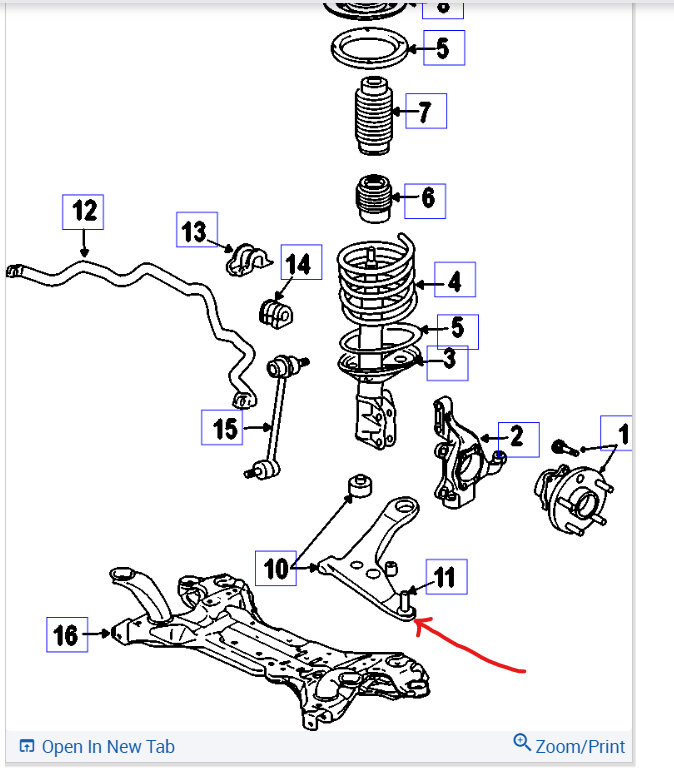

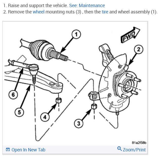

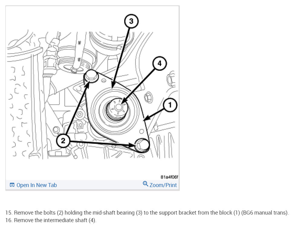

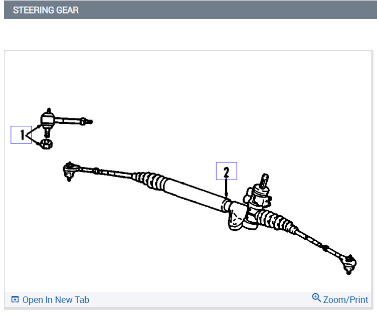

The first thing I would say is tie rods, did they check the inner tie rods? These can wear as well and cause the problem you are describing. I have also seen the lower control arm bushing or ball joint do out as well. can I ask if the car has new struts? This guide may help and i have included images below so we can be on the same page:
https://www.2carpros.com/articles/clicking-sound
and
https://www.2carpros.com/articles/popping-noise
Check out the images (below). Let us know what happens and please upload pictures or videos of the problem so we can see what's going on.

Yeah, they said tire rods were tight and looked fine. And new control arms and struts. And also, when i press the gas too fast sometime there’s a loud clunk.

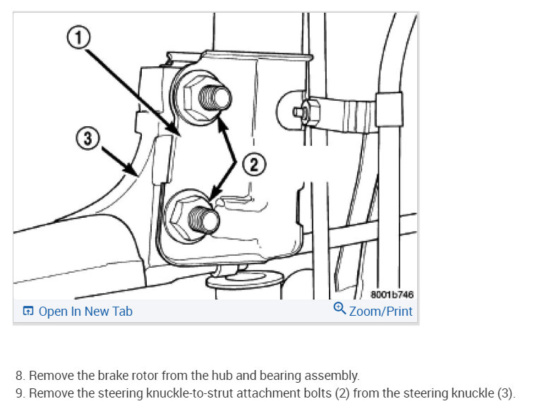

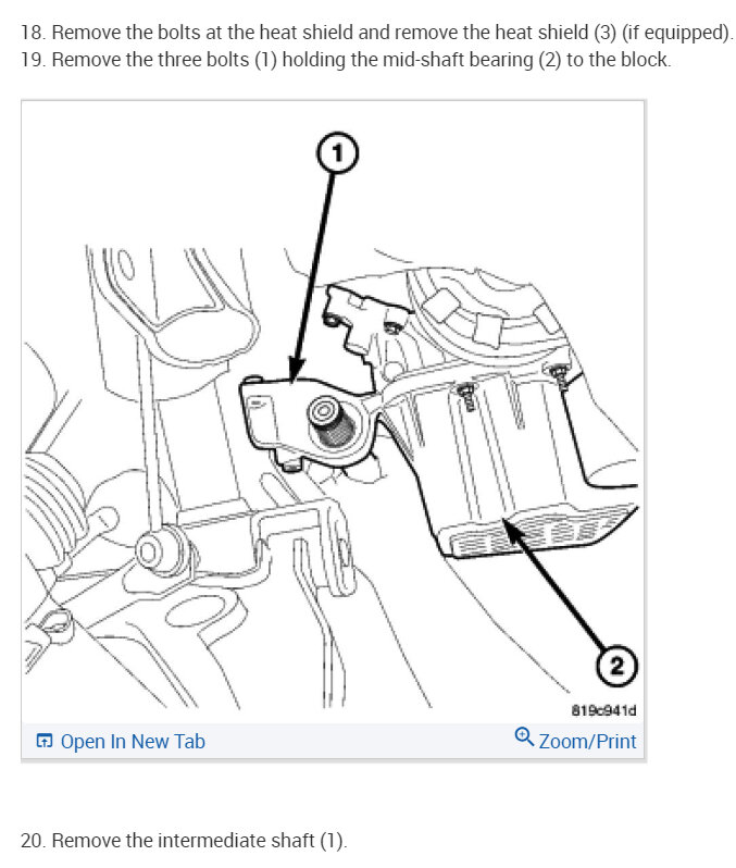

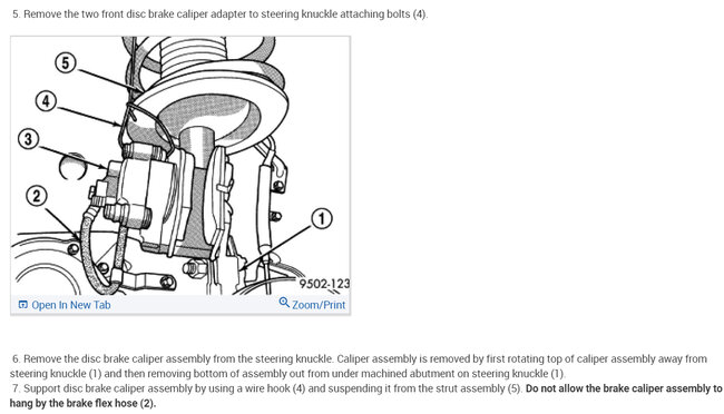

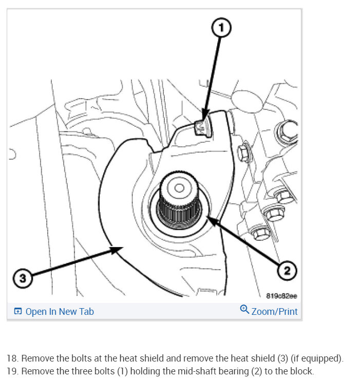

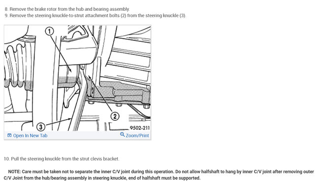

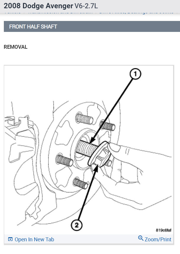

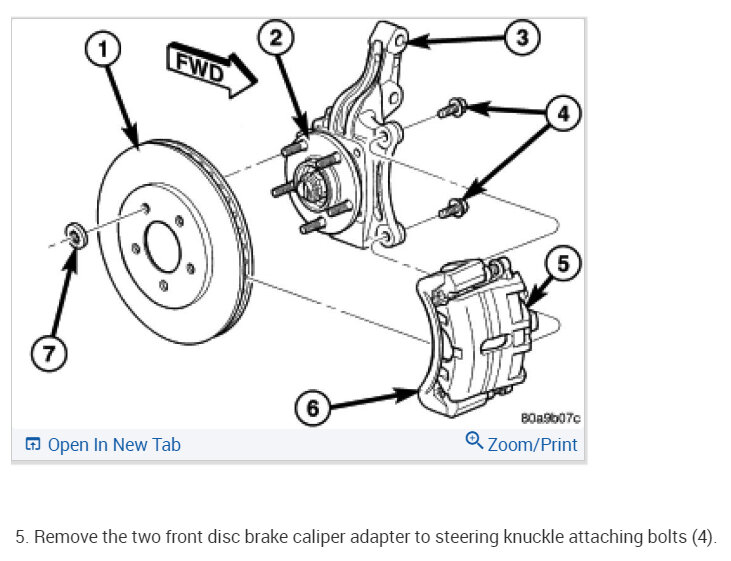

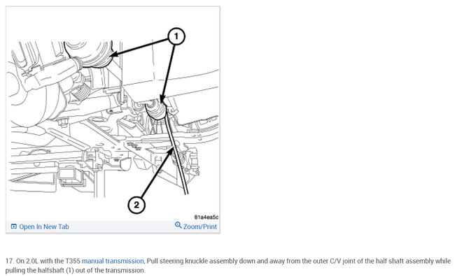

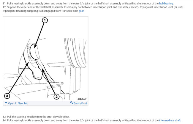

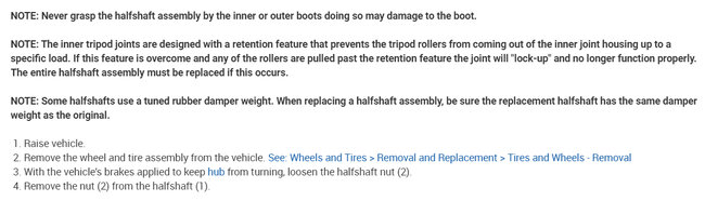

Yep, I need to agree with you I think the CV axle is bad which can cause this problem. I would replace both sides. Here are the instructions on how to do the job. Check out the images (below). Please let us know how it goes.
