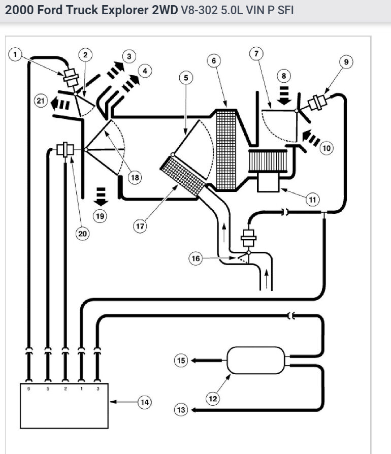

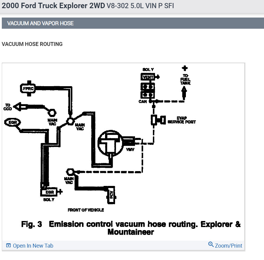

I am looking for a vacuum lines diagram to properly repair and replace multiple small brittle vacuum lines.
Jul 4, 2023 at 11:24 AM
Yep, here are the engine and HVAC vacuum line diagrams as requested. Check out the images (below). Please let us know if you need anything else to get the problem fixed.
