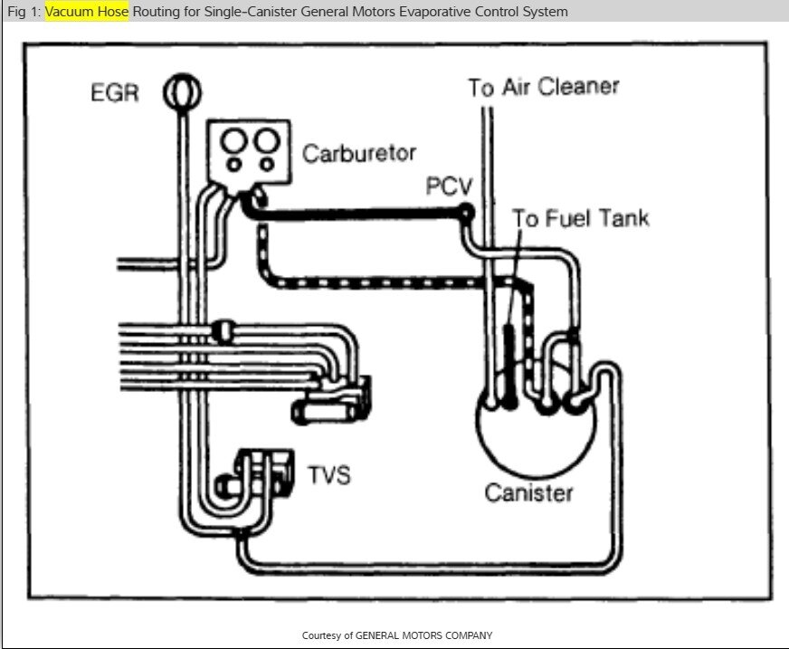

I found a vacuum hose routing diagram for you. Unfortunately, due to the age of the vehicle I have limited information on my end.
It doesn't look like it is complete, but it should get you started in the right direction.

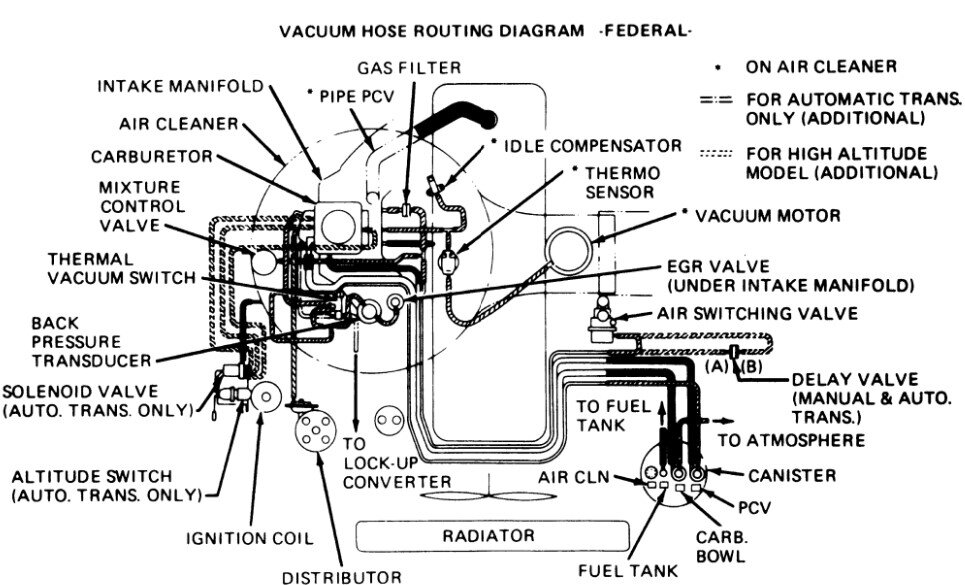

The second diagram has more info but is kind of a mess to follow, but I am adding it anyway, so you have as much information as possible.
If you would like to send me a couple of pictures of the engine, I may be able to help more. But for now, I would start to put in one line at a time and see what you are left with.
Looks like someone ripped out all the emissions stuff out possibly so you may not have certain components there to connect to. I am only speculating here though.
I will continue to look for a better diagram for you and will send it to you.
But like I said for now I would start with these two and see how you make out. You should be able to get a few lines in then we can figure out what is left.
Note-The part that says TVS in the first diagram stands for Thermal Vacuum Switch. I have included a picture of this part for you.
