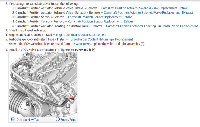

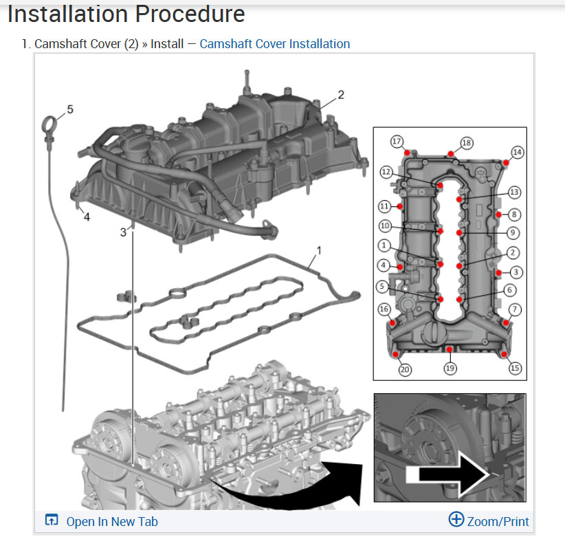

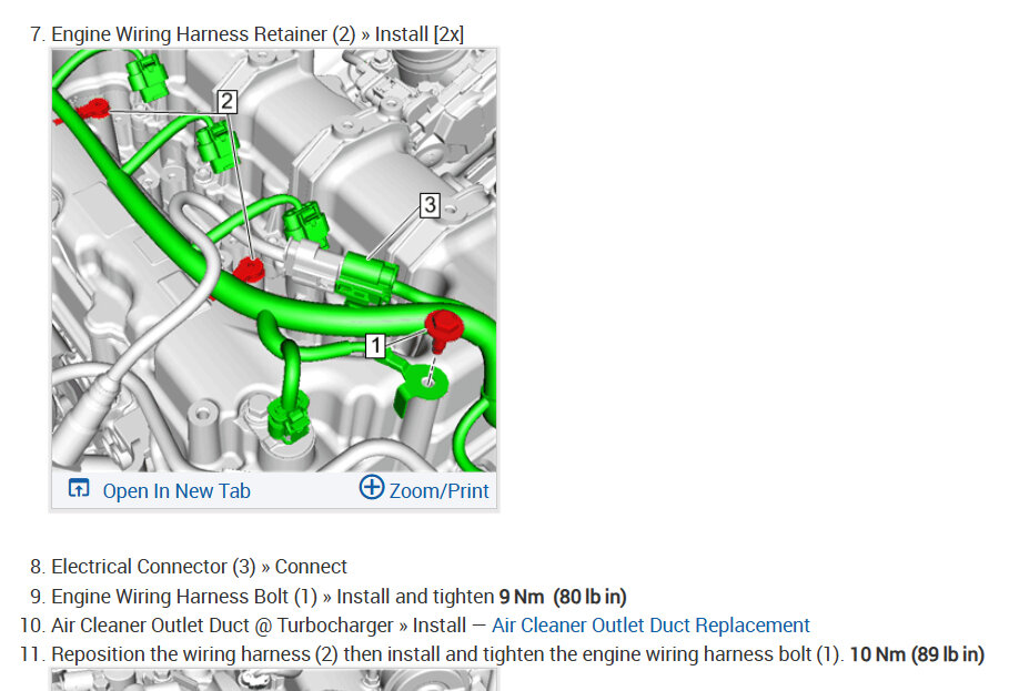

Sure, here are the instructions and the torque spec and sequence on how to tighten the valve cover back down. Check out the images (below). Let us know if you need anything else.
