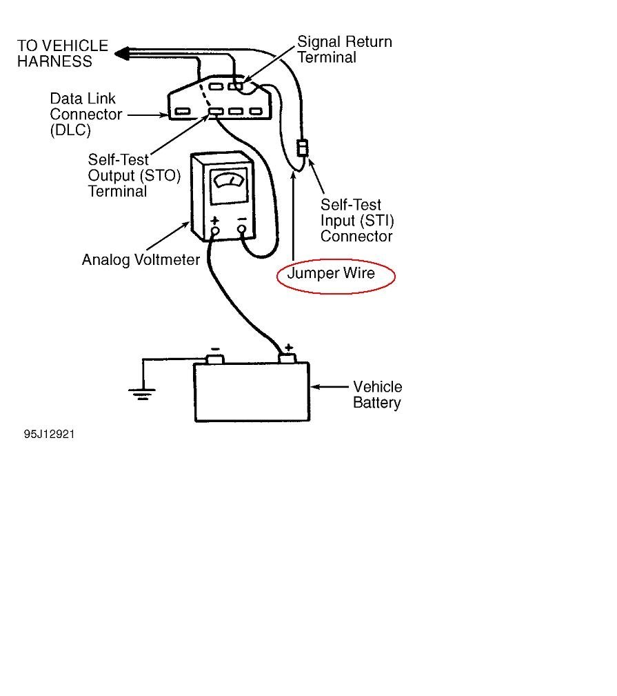

Without specialized diagnostic equipment there is no way to test the individual components. The way to start is always by reading the diagnostic fault codes. That was real easy to do on Chrysler products starting in the mid 1980s by just cycling the ignition switch. By the early 1990s you can do that on Fords too, but the procedure is a lot more complicated. To start with, you must fashion a jumper wire and connect it as shown by my red oval. This diagram is from Mitchell ProDemand. This shows an older-style analog voltmeter to read the pulses of the sweep hand, but you should be able to count the flashes of the Check Engine light instead. This is where it gets stupidly complicated.
The codes are three-digit codes and you'll be counting flashes or needle sweeps corresponding to each digit. Rather than retyping everything, here's a copy from ProDemand. See if you can follow this and get some fault codes. Without codes you'll need a scanner or you'll have to fall back on replacing random parts, and we never approve of that.
