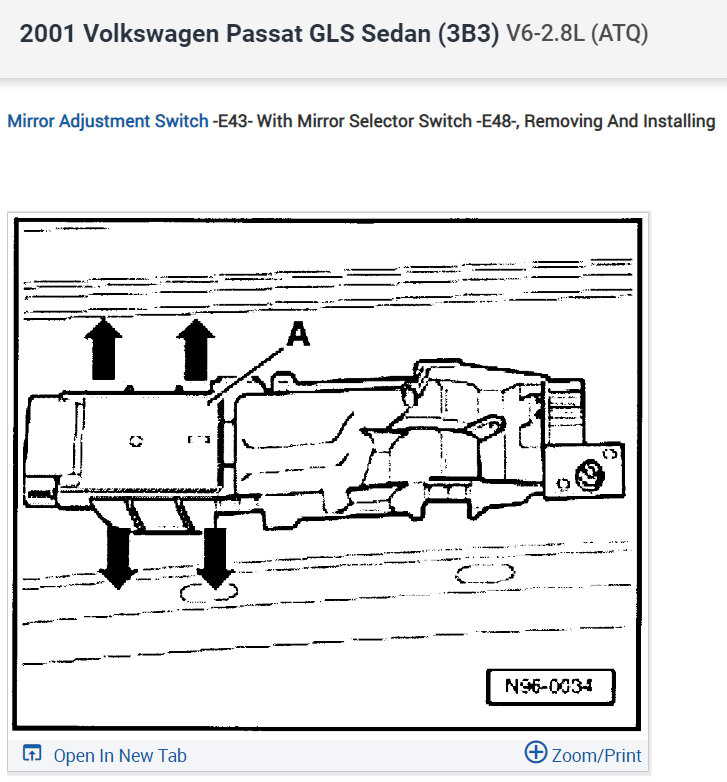

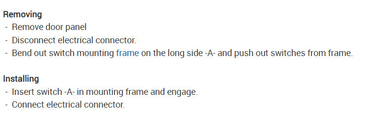

Looks like you remove the door panel and bend the tabs over and push the switch out
Dec 10, 2007 at 2:36 PM

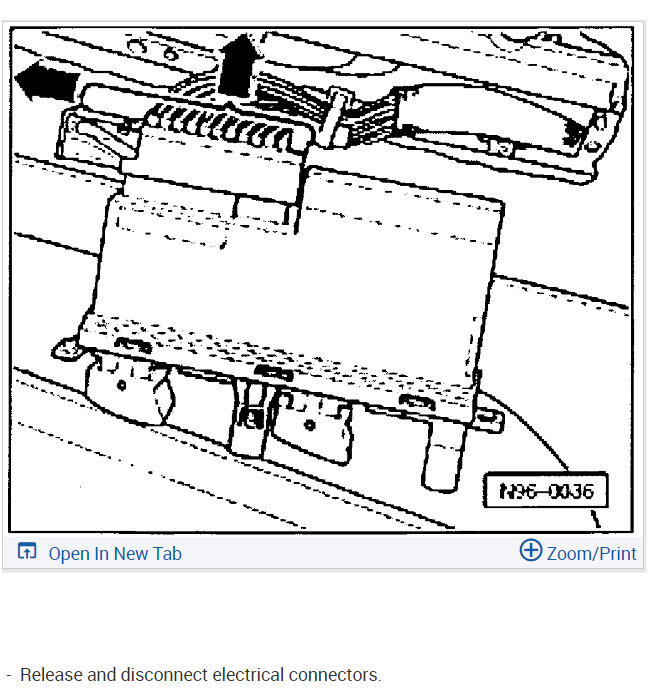

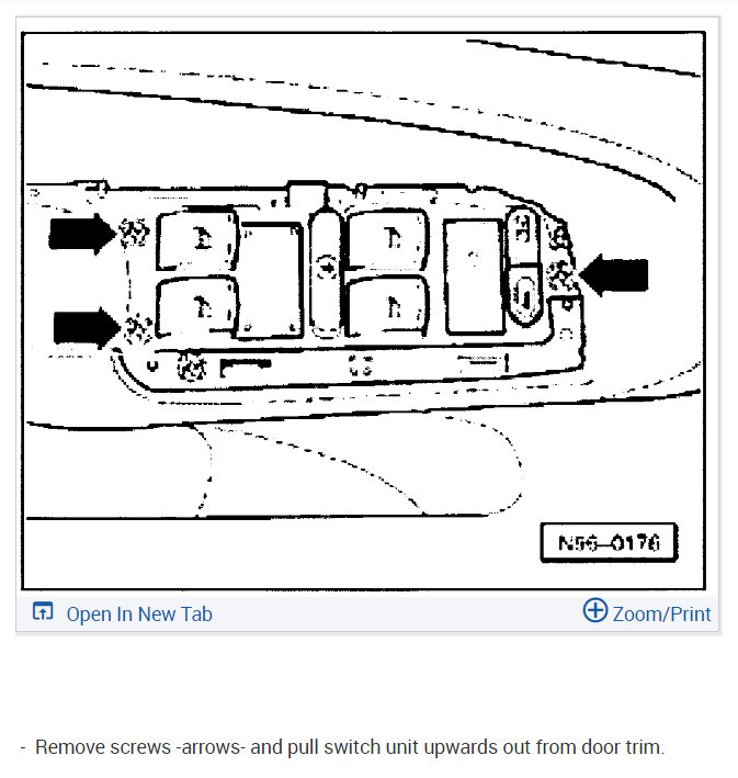

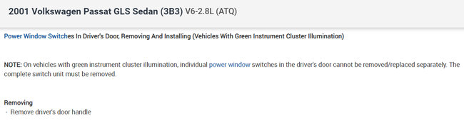

This switch is inside of the window switch, here is how to change it out. Check out the images (below). Please let us know what happens.
