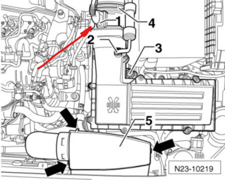

I am getting codes p0111, p0112, and p0113 on my 2013 VW Jetta Sportwagen with the 2.0 L TDI diesel engine, but I am unable to find an repair manuals or information on the location of the sensor.
I believe I have the CJAA diesel engine.
My best guess to the location is the air intake manifold, but I have no solid information nor have I been able to find the sensor location during inspection. I have the part already and am hoping to replace it ASAP. Vehicle still drives fine, but check engine light persist with an occasionally flashing glow bulb light.
Sep 5, 2025 at 7:02 AM
Ya yes, the air intake temperature sensor is inside the MAF sensor which gets contaminated by oil when the turbo starts to go bad FYI. Here is the location of the sensor. Check out the images (below). Let us know if you need anything else.

Thank you! I'm going to try and clean the MAF sensor today. And replace it if that doesn't work. I won't replace the turbo just yet till it gives me other symptoms.

The codes haven't come back since cleaning the MAF and I didn't notice any significant residue in the intake lines before and after the MAF to suggest oil is passing through in significant amounts. Wiring appears fine visually, but I did not check with a volt meter.
I'm still getting a flashing glowplug light occasionally though, so a sensor somewhere is still unhappy.
I've ordered a new Bosch MAF (and Bosch MAP since it's only $20) from Rock Auto that I'll install this weekend.
