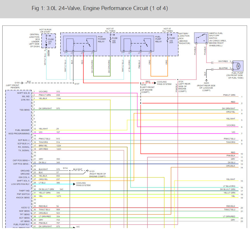

I have the car listed above SEL. A few weeks ago, a squirrel chewed some of the wires connected to my mass air flow sensor. So I got that fixed by a local shop. About a week later I drove close to 100 miles and after turning the car off at my destination, and got done, I got back in and started up the car, my car threw the check engine light and the oil light, and my car threw the engine safety shut off switch on. After a tow back to my hometown, Mechanic read code and diagnosed it as the oil pressure switch, so that was replaced. I also had the oil and filter changed at that time since I was close to due for it. Since then my car doesn’t seem to operate quite as smoothly as it should be or accelerate quite as easily (difference isn’t huge but seems a little noticeable). Also had one repeat of the check engine and oil light which a restart after a few minutes cleared it. But I am still having periodic hesitation and mild jerking upon accelerating from a stop (not every time just one here and there) after the car has been driven for a while and everything is warm, even though it’s been cold here. What should I do and what do you recommended? And should I try a fuel system cleaner?
Feb 20, 2021 at 8:06 AM

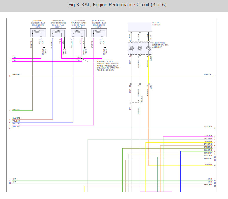

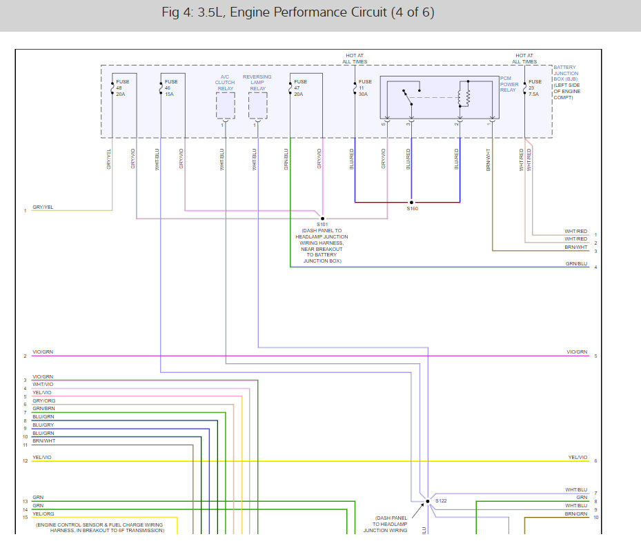

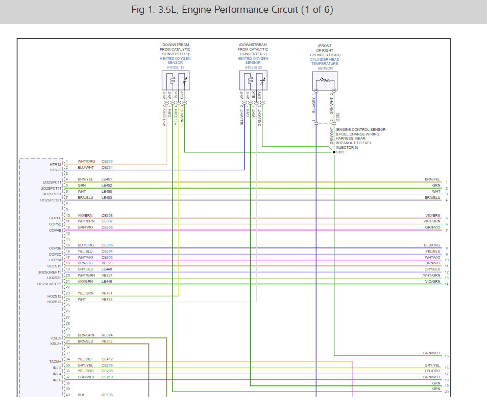

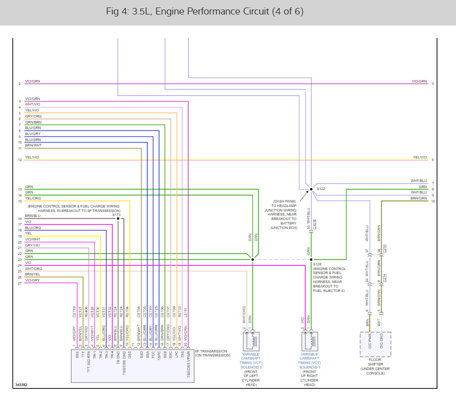

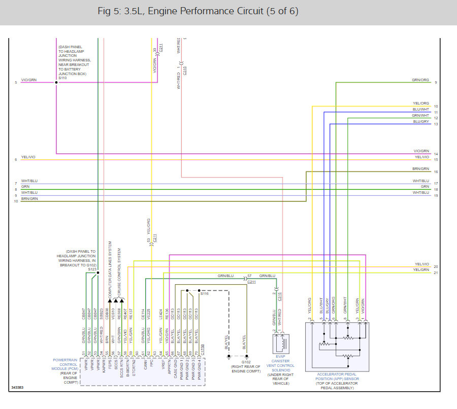

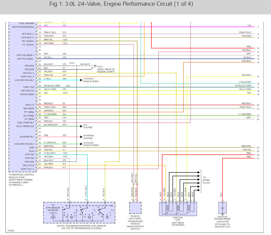

The first thing we need to do is get the codes this guide will help. It sounds like the wiring repair could be causing the issue. this guide can help confirm with the engine wiring diagrams below to show you how the system works:
and
Feb 21, 2021 at 10:20 AM
HLEGGETTE
Where is the ignition control module located? I cannot seem to find it. I need the ngien wiring diagrams so I can see how the system works.
Thanks
Mar 10, 2021 at 6:33 PM (Merged)
The ignition module is located in the PCM. Here is the engine wiring diagrams so you can see how the system works. Please tell me what the problem is.
Check out the diagrams (below). Please let us know what you find.
