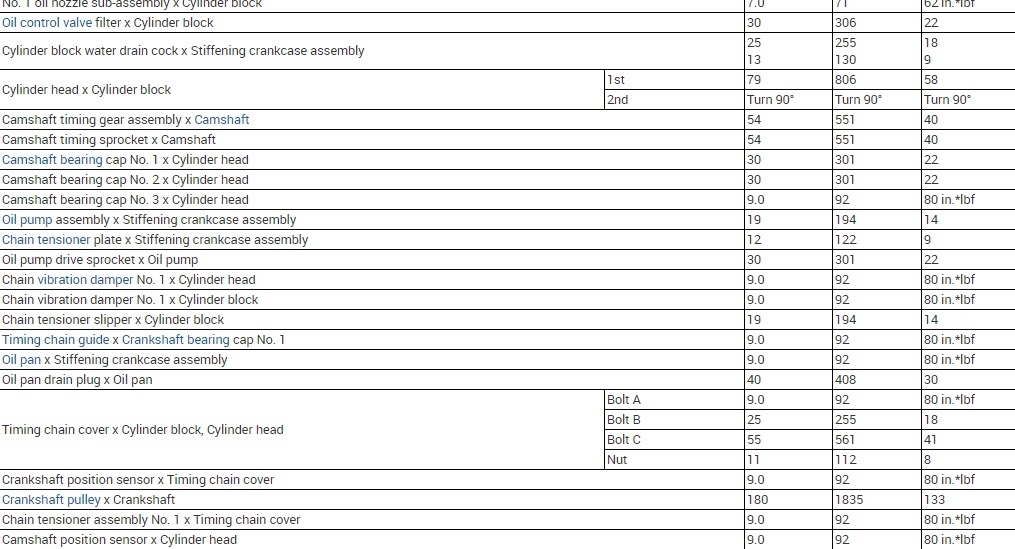

what is the torque for the camshaft bearing cap bolts?

i can't find out the right torque for the camshaft bearing cap bolts?

Here is what I found, along with a few other specs. Let us know if there is more info needed. Check out the diagrams (Below). Please let us know if you need anything else to get the problem fixed.
