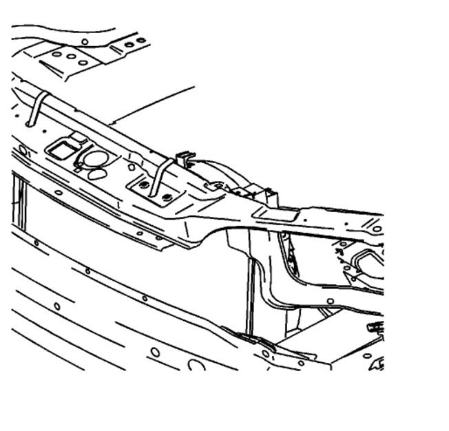

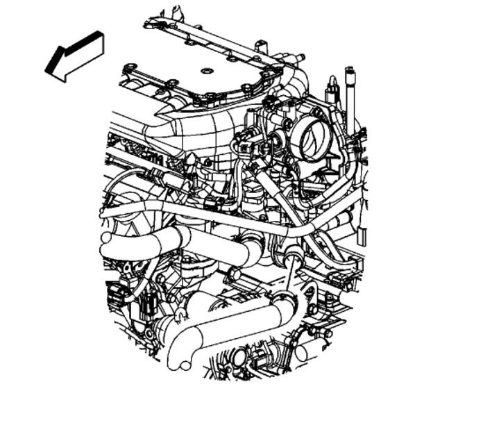

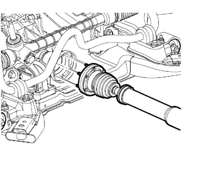

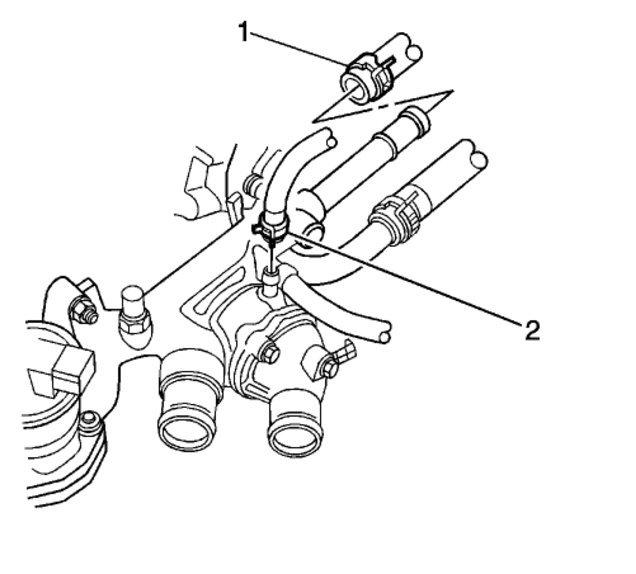

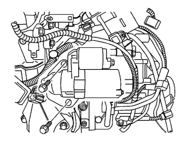

Here are some diagrams (below) to show you what it will be like on your car.
