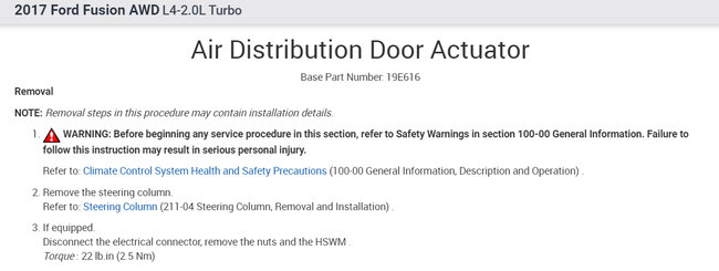

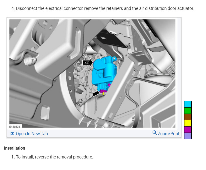

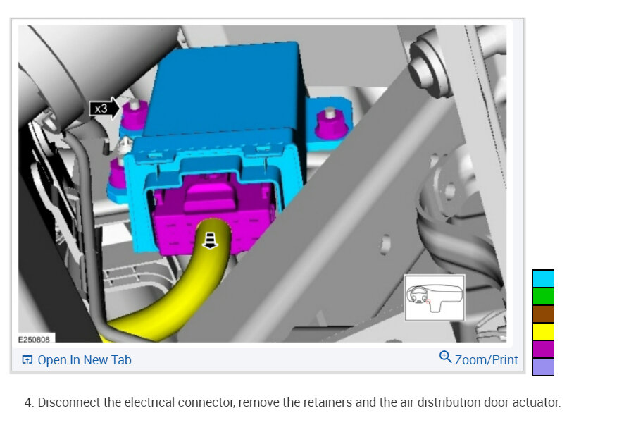

No air out of defroster. I want to know the location of the mode door actuator.
Oct 29, 2022 at 11:37 AM
DEAN LATINI
MEMBER
1 POST
I verify my question...Where is the mode door actuator for my 2017 Ford Fusion?
Oct 29, 2022 at 11:39 AM
CERTIFIED EXPERT
53,855 POSTS
They call it an air distribution actuator and it is under the dash on the passenger's side, here are the instructions on how to replace it in the diagrams below. Check out the images (below). Please let us know what happens.
