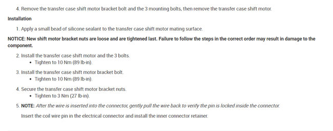

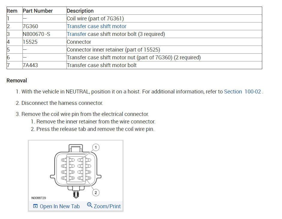

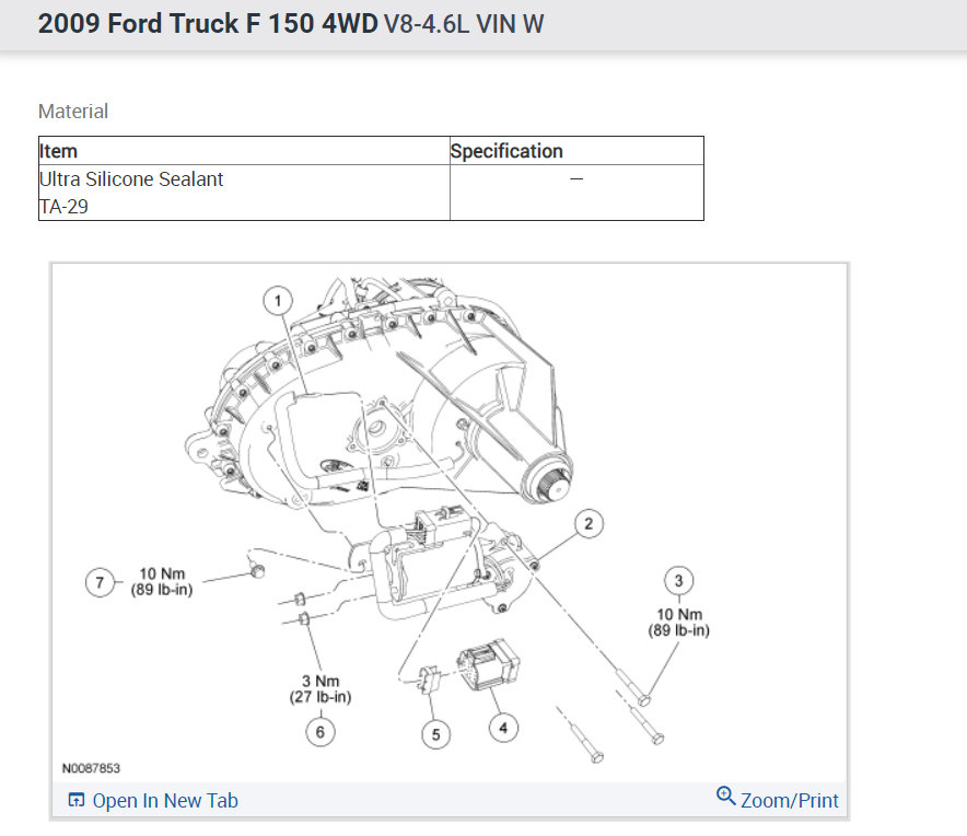

This happens when the encoder motor goes out and doesn't return fully keeping the light on. here is the location so you can check it out. Check out the diagrams (below). Let us know what happens and please upload pictures or videos of the problem.
