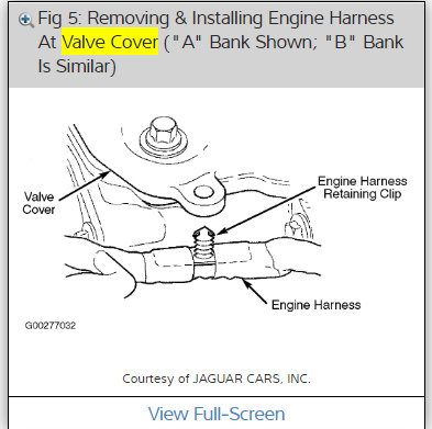

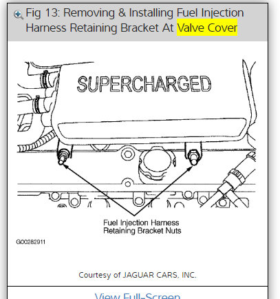

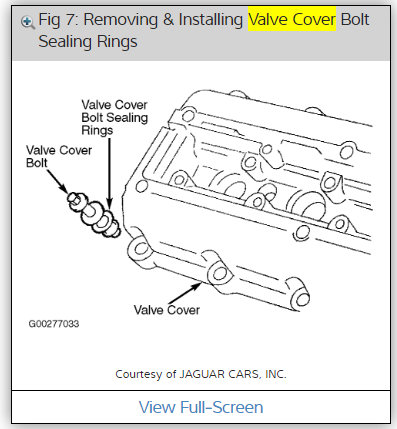

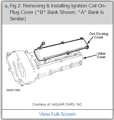

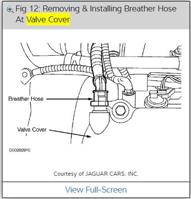

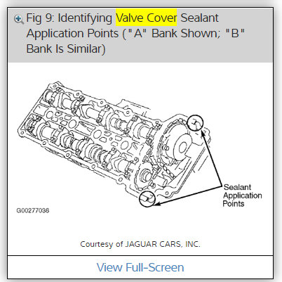

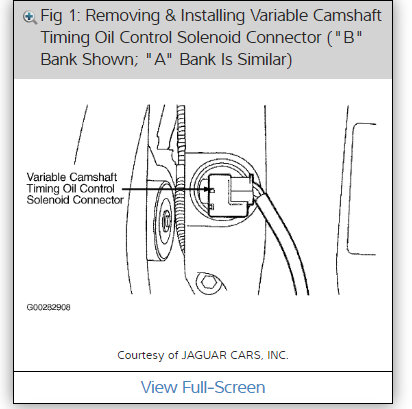

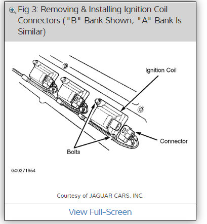

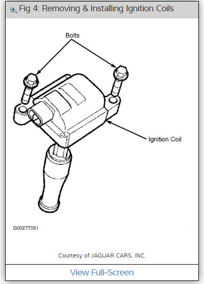

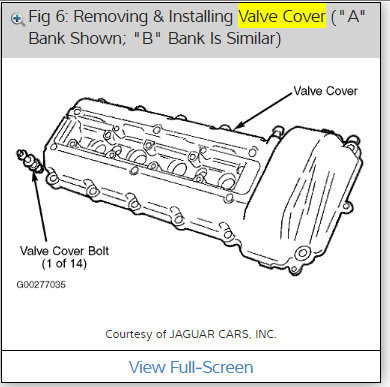

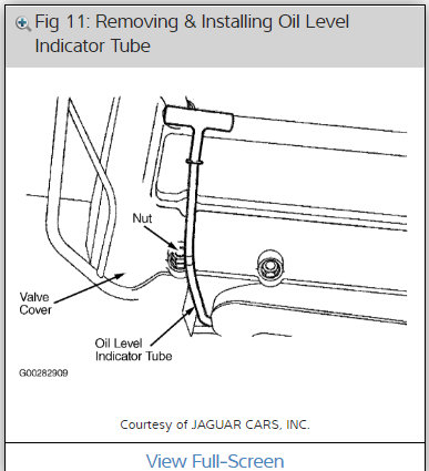

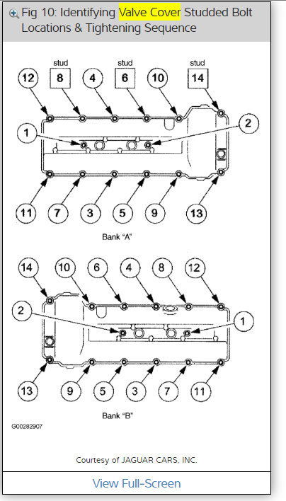

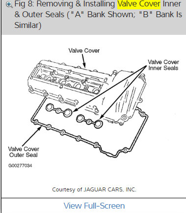

Good work. Here is a guide and diagrams below to help you do the job:
https://www.2carpros.com/articles/replace-valve-cover-gasket
You can get the gasket from Amazon or Rock Auto.
Check out the diagrams (below). Please let us know if you need anything else to get the problem fixed.
