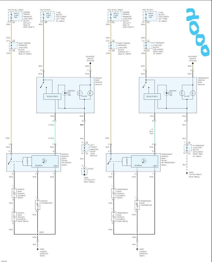

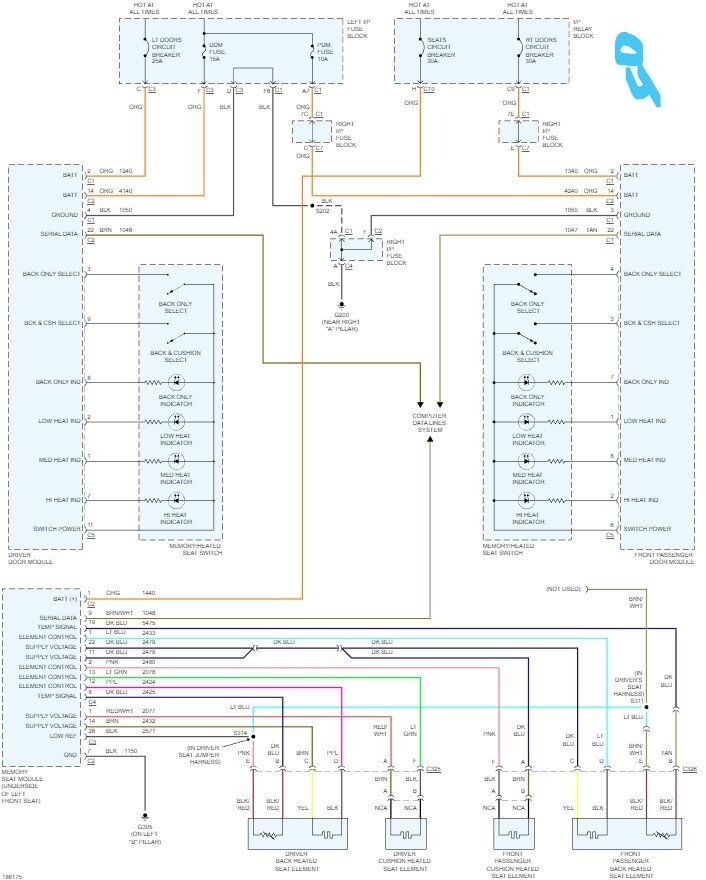

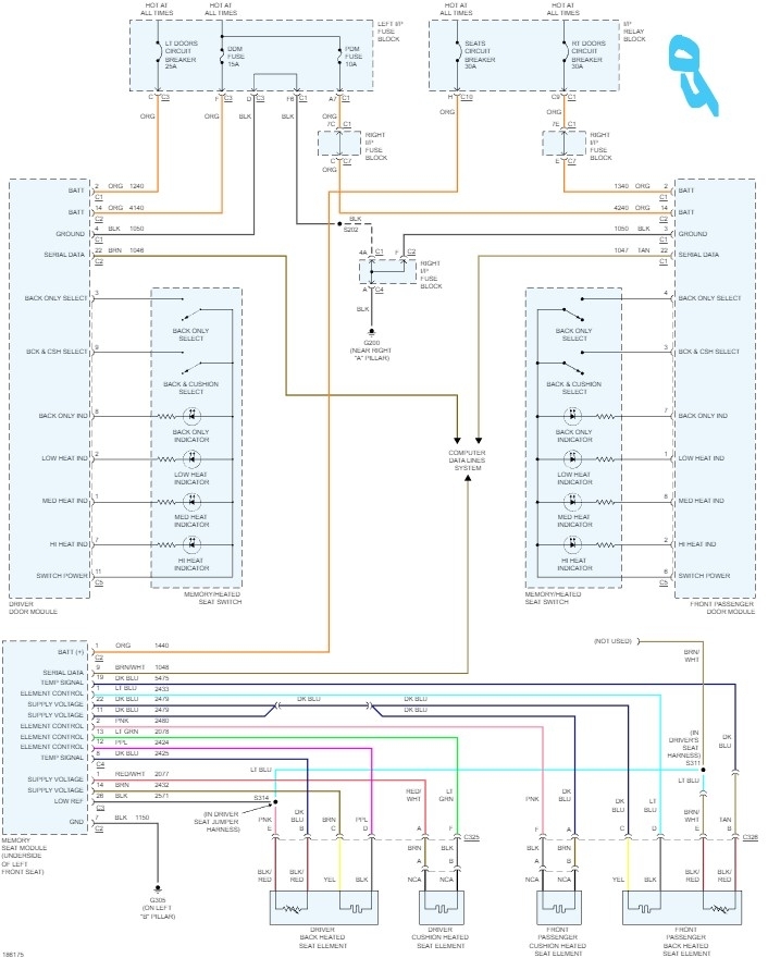

We’re trying to retrofit a 2004 Tahoe power passenger seat into the truck listed above. Bolts up fine as we were advised it would, but the wiring harnesses aren’t matching up. There doesn’t appear to be a memory seat for the passenger side on the vehicle harness side which is fine - but the connections for the seat heat are also different. The passenger side connector on the 2000 is a 6-pin connector with 4 wires actually in use (2 brown for hot, black and light blue for power to the heat relay and the switch connection, it appears). On the donor seat from the 2004 Tahoe, it’s a 16 pin connector with orange for hots, but can’t figure out which wires to leverage for the switch as there are multiple choices and the schematic, I’ve found doesn’t match color-wise. Photos below are of the 2004 Tahoe connector.
