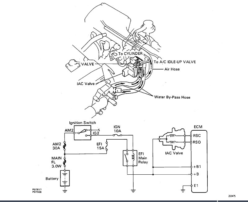

Car will only start by holding down on the gas a little. As soon as I release the gas the car stalls. What could be the problem?
Sep 7, 2019 at 1:18 PM
SCGRANTURISMO
  • 4,897 POSTS

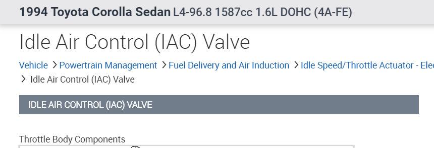

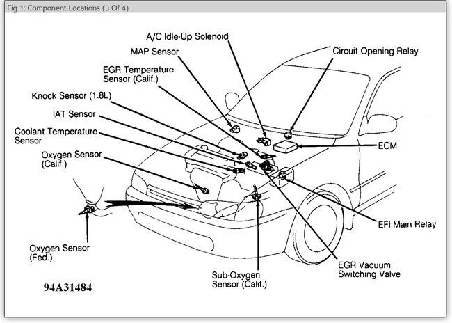

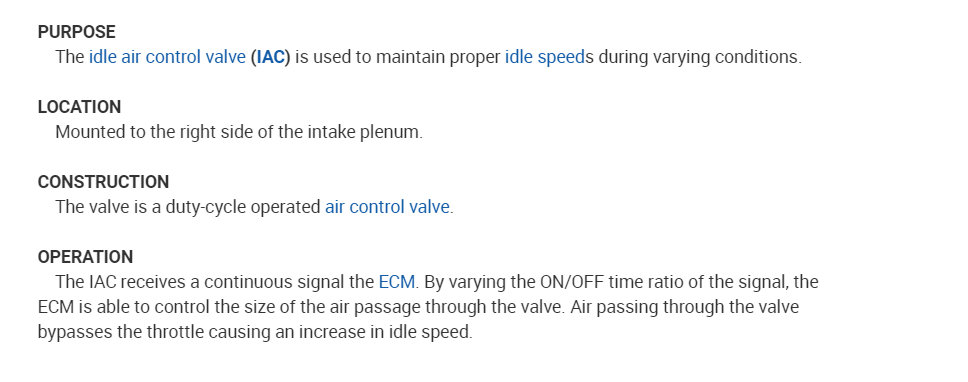

This could be a problem with your vehicle's Idle Air Control valve (IAC). This is the valve that let's air go around your vehicle's closed throttle plate at idle to keep your vehicle's engine running. In the diagrams down below I have included a diagram and factory description of your vehicle's IAC valve. Here is a link, also, for you to go to below:
https://www.2carpros.com/articles/how-to-replace-an-idle-speed-control-motor-iac
Please go through these guides and get back to us with what you are able to find out.

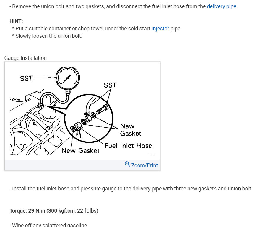

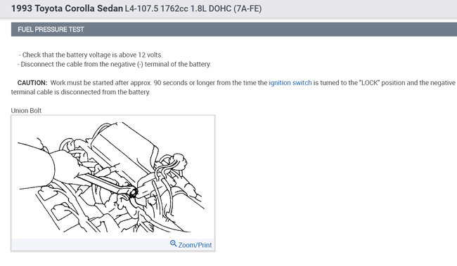

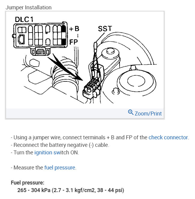

Oh yes, the fuel pump can cause this issue. I wanted you to loosen the head pipe bolts to the exhaust it would be a little loud but it would rule out an exhaust issue and it does not cost anything. Back to the fuel pump. Here is a guide that will help you see how to check the fuel pressure I used to have the gauge taped to the hood of the car and then drive it to watch the pressure.
Here is a guide to help you see how to test the pressure with diagrams below to show you how to hook up your car:
Please run down these guides and diagrams and report back.
