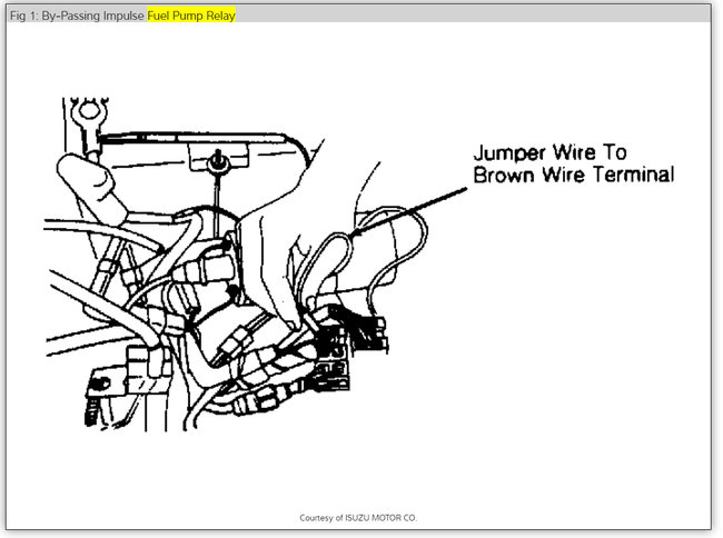

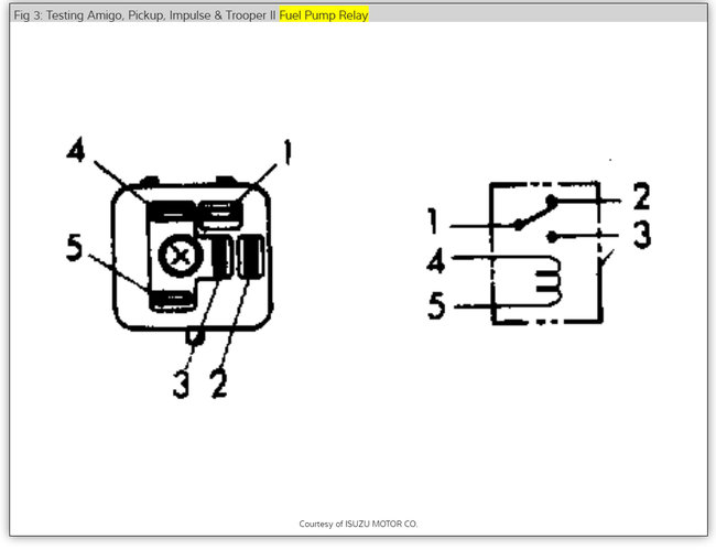

No. Starter works great. Engine turns over easily. Just no ignition. Jumped fuel pump because lines are dry. Next I'll jump the pump relay.I have no diagnostic tools so doing it old school
Nov 6, 2017 at 11:10 AM

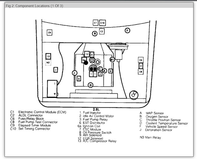

I would try replacing or jumping the ECM reply here is its location. (below)
Nov 6, 2017 at 11:28 AM
