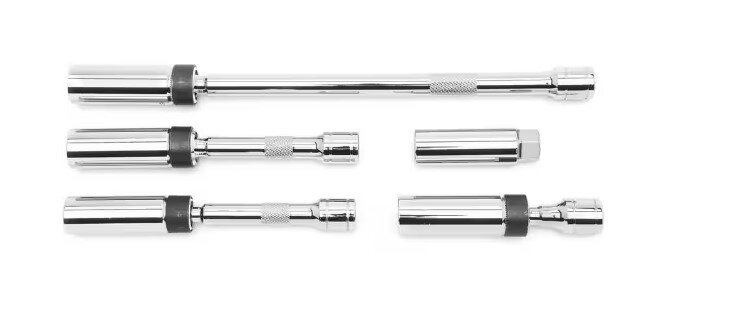

Could you tell me what ratchet or swivel tool you recommend for ease of changing the spark plugs in the back of the engine? Thank you

I use a magnetic swivel socket made for spark plugs. My current set is gear wrench branded. They work very well, and the different lengths fit 99% of the vehicles out there.
Be careful when starting the plugs so that you don't accidentally cross thread them.
