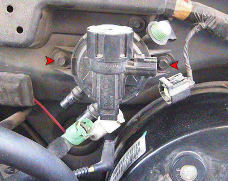

Is the P0443 the only code you found? That is related to the canister purge solenoid. Have you checked for a vacuum leak at that point or if something was damaged or left disconnected? It is located near the power brake booster on the firewall under the hood. See the attached pic.

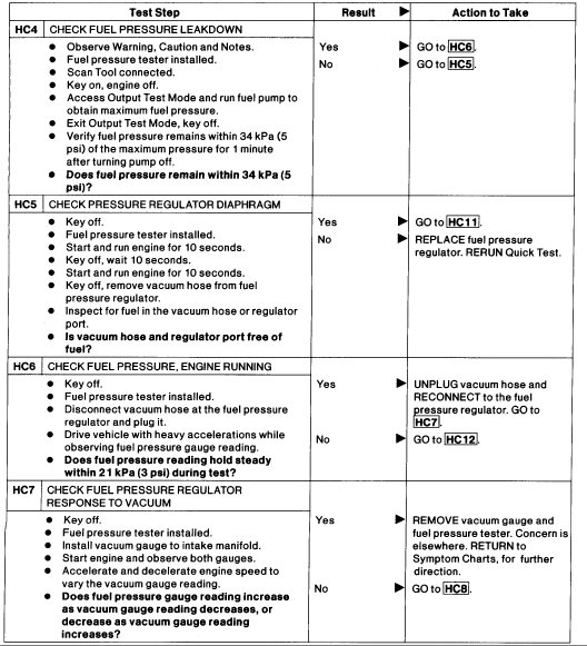

Truck will only start when the gas is held down and then will not stay running.
Jun 28, 2021 at 1:13 PM (Merged)

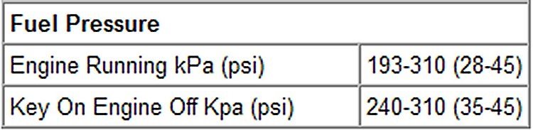

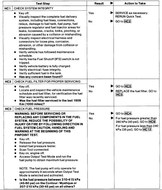

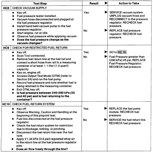

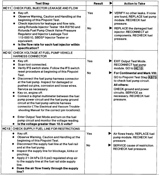

Hi and thanks for using 2CarPros.com. I will assume you mean you are catching the vehicle in gear. The first things we need to check are for a good spark to the plugs and fuel pressure from the pump. Here are general directions for checking for spark:
Here is a video showing how fuel pressure is tested:
https://youtu.be/peh7-pFycyc
As far as the fuel pump pressure specific to your vehicle, the first picture I attached indicates the fuel pressure specifications. The next four pictures are of flow charts if you find a problem with pressure.

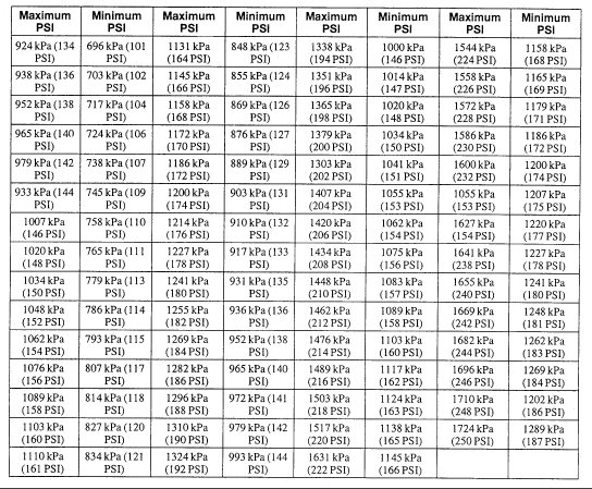

Picture 6 is of the acceptable range of compression.If you find the compression to be lower than 110psi, that is most likely the problem.
Let me know if this helps.
