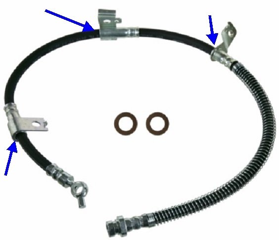

Good news folks!! The issue has been resolved with the replacement of the flexible front brake lines. I truly appreciate all of the support CARADIODOC and KASEKENNY1.

It could also be a failing flexible brake line. They can fail inside and act like a one way valve. You apply the brakes and the fluid either cannot return or returns very slowly.
These can be hard to find if it only happens once in a while because they will look fine on the outside. Sometimes you can find them if you jack up the vehicle and stomp the brake and have someone immediately try to spin the wheel by hand as soon as your foot is off the pedal. If the wheel is hard to turn and slowly gets easier I would suspect the line.

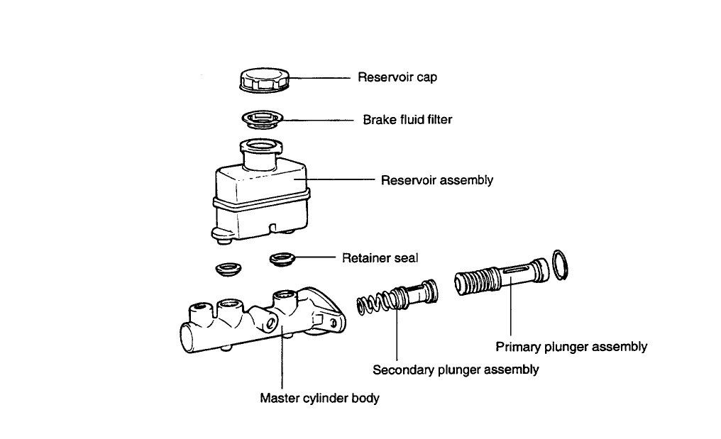

CARADIODOC
  • 34,306 POSTS
Brake fluid is trapped and can't get back to the master cylinder. When it happens again, loosen the mounting bolts for the master cylinder. If the brakes release, check the push rod to see if it's over-adjusted, or if the brake light switch is misadjusted and holding the brake pedal down. If they don't release, open the bleeder screws at the front calipers. If the brakes release there, check the rubber flex hoses.
Why did you replace the master cylinder? Any chance the fluid is contaminated with petroleum product?
Mar 15, 2021 at 6:05 PM (Merged)
LISA1515
this happened 3 months ago and the mechanic put master cylinder in it was fine for 3 months nows it started again this week
CARADIODOC
  • 34,306 POSTS
The first thing to check is the rubber bladder seal under the reservoir cap. If it's blown up and mushy, there' a petroleum-based contaminant in the brake fluid. The only proper repair for that is to replace every part in the hydraulic system that contains rubber parts that contacts the brake fluid, and all steel lines must be flushed and dried.
At 52,000 miles and six years old, it's very unlikely the master cylinder failed on its own. If it failed due to fluid contamination, that contamination will leach back out of other seals and hoses and recontaminate the new master cylinder. That typically takes a few weeks to a couple of months.
The way to prove or disprove this is to loosen the steel lines right at the master cylinder while the brakes are locked up. If they release, fluid contamination is the chief suspect. The misadjusted push rod or brake light switch that I mentioned previously wouldn't be okay for three months, then suddenly start causing a problem.

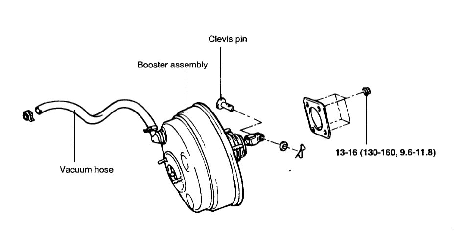

I’ve replaced everything in the braking system. when I take off the brake line and it returns to normal again. What should I try next?

Okay, so it locks up when you apply vacuum to the brake booster, correct? If you disconnect the booster and it releases, it sounds like the booster itself is bad.

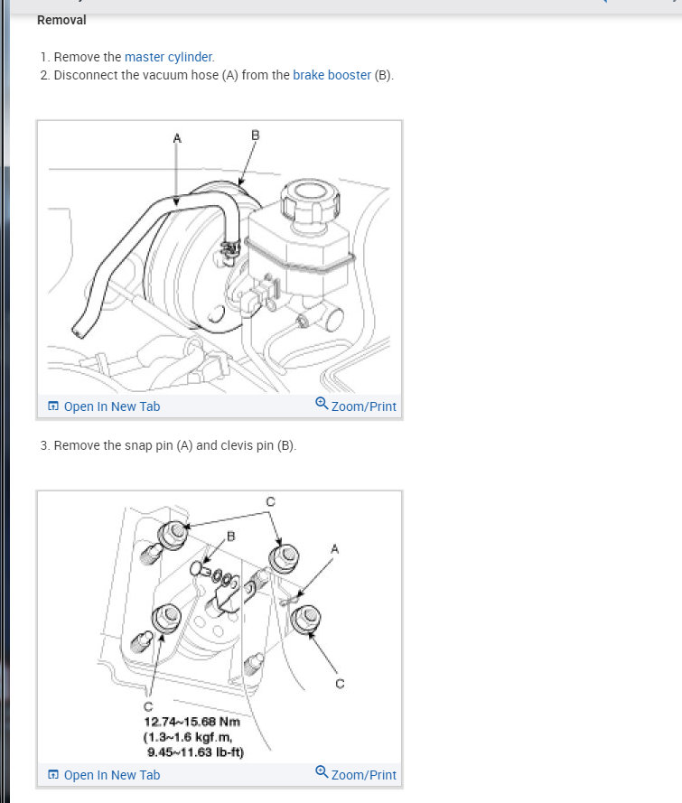

If they only lock when the brake booster is connected to vacuum, it sounds like the booster is bad. I realize you replaced it and it worked for some time, but it sounds bad.

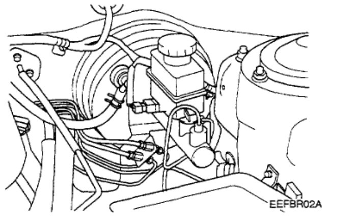

AJTHECARDOC
I have a 2002 Hyundai sonata 2.4 no abs. I drive about 5 miles and brakes lock up. I disconnect hose from booster and it release brakes. I replaced booster with a used one and it did the same thing. I inspect master cylinder and no fluid leak at master be I replaced power brake booster
When this happens, do all brakes lock up or just start to drag? Have you reciently replaced the master cylinder? Have you examined the booster check valve?
LUCAS343
  • 6 POSTS
How much pressure should the vacuum have?
LBERRY01
I have a Sonata 2005 2.7(V6)GLS NO ABS NO Traction Control drive about 4-8 miles depending on the temp. cooler it takes a little longer, the front brakes lock up till you cannot move. Have redone the whole braking system new everthing !!! This car only has 61,521 miles has been maintained well never experience anything else, no noises or anything. Replaced front pads last year. This started out of the blue while driving home, no indication of anything till all of a sudden. Frustrated, and confused cause noone seems to know what the problem is, I have replaced several parts from auto store to another. My car seems to use '04 parts and '05 parts.......Have not taken to dealer as of yet, have a personal mechanic by trade that does everything for this car and he cannot figure this one out. HELP! HELP!
The vacuum is right from the intake. Most internal combustion engine's hold between 15 and 18 inches of vacuum when idling. The will drop when the engine is under a load or when the throttle is pressed.
What happens is the internal valve inside the booster gets stuck so it wont release. The booster needs to the replaced or the booster rod is adjusted too far out. Try to undo the mounting bolts for the master to see if that releases it as well if so then turn the rod adjustment screw inward. If not here are some diagrams to help you replace the booster with a rebuilt or new unit.

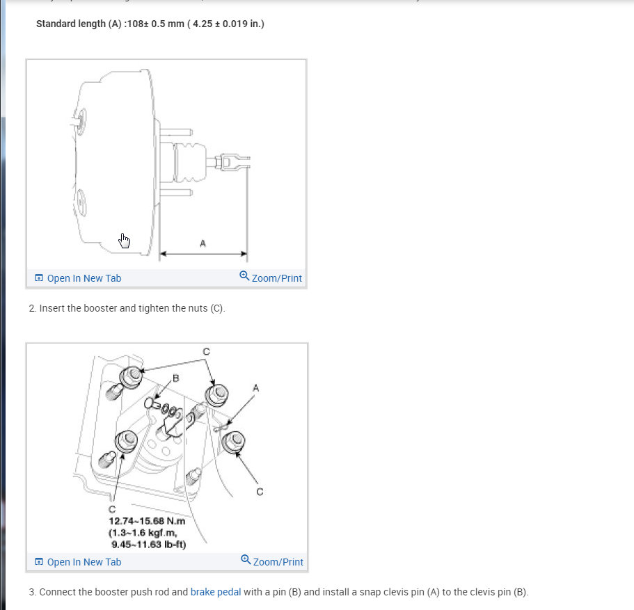

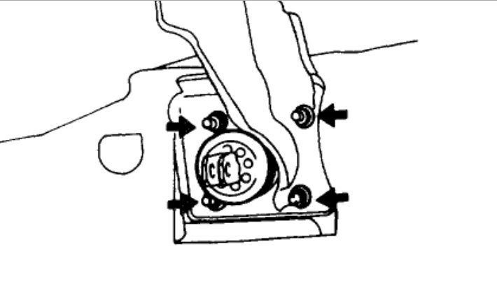

KHLOW2008
  • 41,814 POSTS

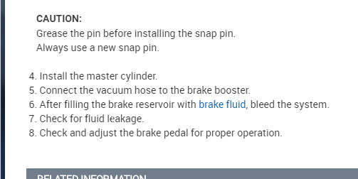

Check the brake pedal adjustment. If there is insufficient free play, the master cylinder would be partially depressed and this would result in the brakes seizing after the brake fluid heats up. Insufficient free play could be due to a mis-adjusted brake switch.
MATTHEW T WHITE

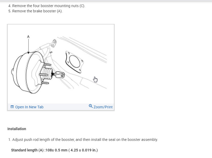

i figured it out it is the brake booster not sure if the pedal is adjustable or not. However, the screw is just have to take the master all the way off to adjust it.
Mar 15, 2021 at 6:06 PM (Merged)
KHLOW2008
  • 41,814 POSTS
Before adjusting the brake booster, check the brake pedal free play adjustment first. It is adjustable, either by the push rod or the brake switch if the pedal is low.
