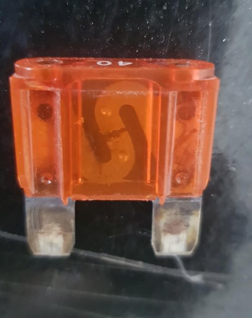

MERLIN2021
  • 17,250 POSTS
Check main maxi fuses in the power distribution center. Follow the heavy cables from The a UKlternator to the pdc. Install your original pcm.
