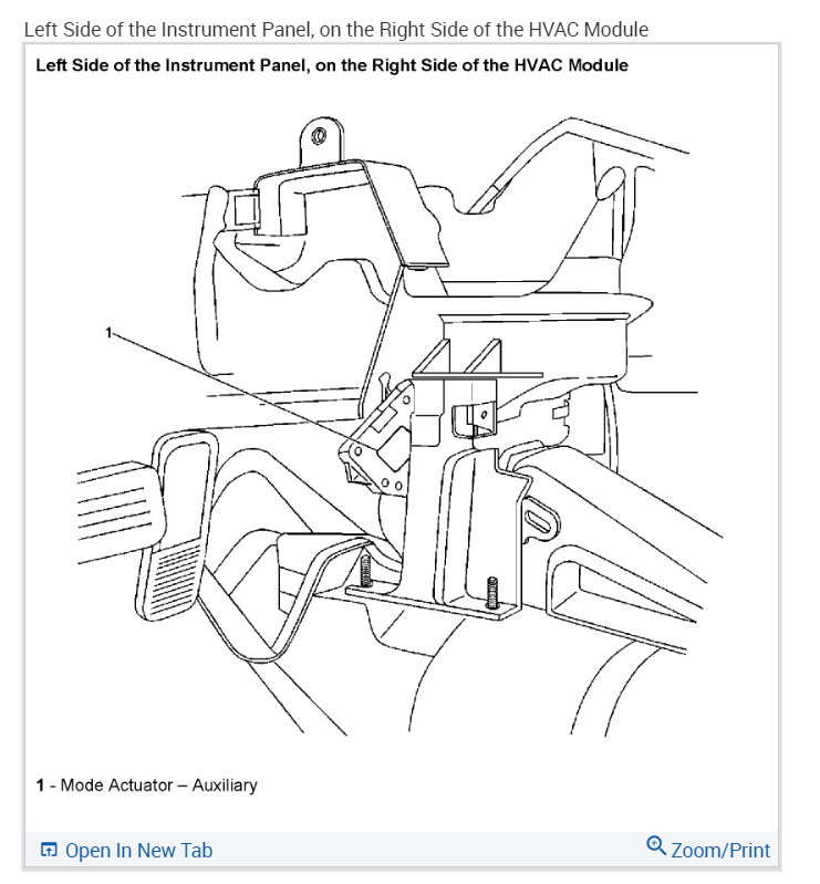

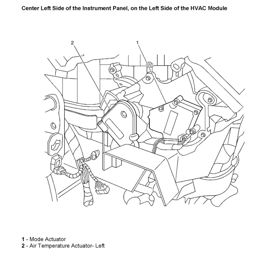

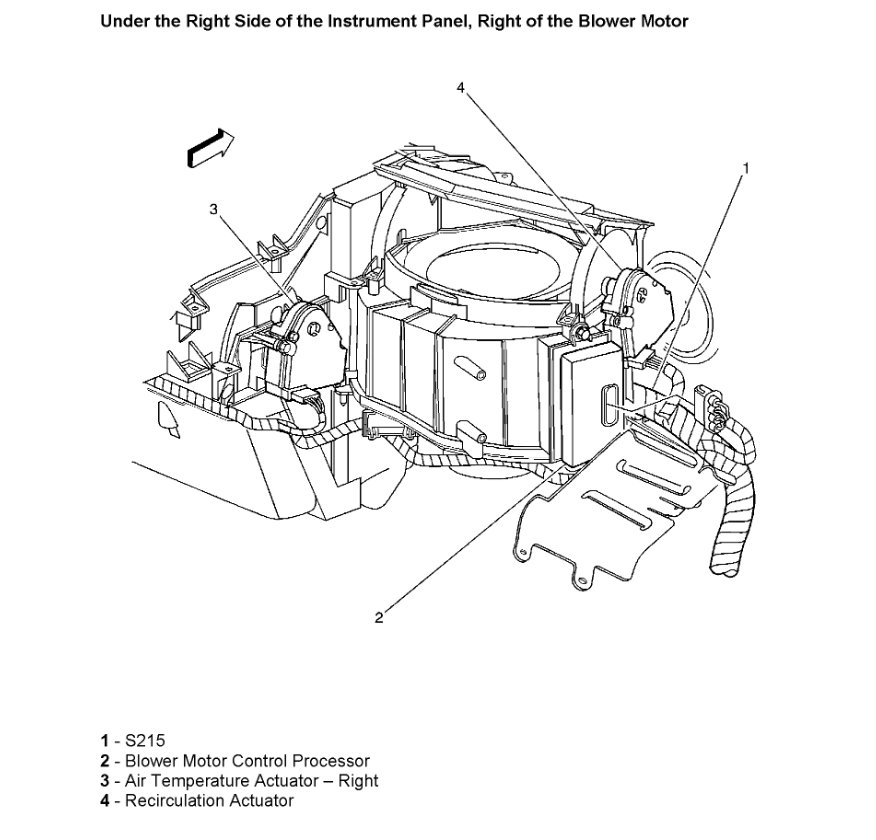

I'm going to assume you mean it blows cold from passenger, but not drivers side. Sounds like a left temp door actuator. It should have a code in the ACM(air conditioning module) that will correspond to a repair.
Here is a guide to help you see what I am talking about with the actuator location int eh diagrams below.
Check out the diagrams (Below). Please let us know what you find.

Please see pic of auxiliary blower motor has two wires both orange and will normally only connect one way. get this scanned for codes as it may be the blower control processor.

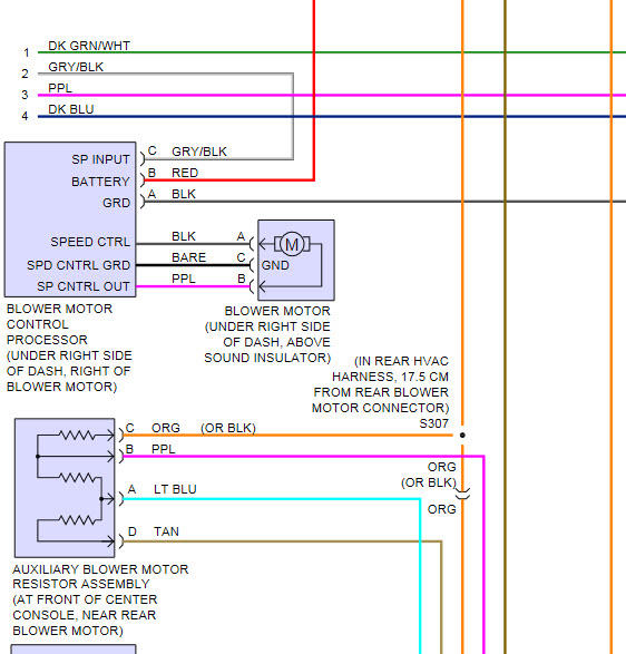

I pulled the blower motor control processor and it's burnt inside. I contacted the person who "fixed" it last time and he said the wires sparked. I said yup you made them spark idiot lol. Now where does the sp input come from? The control panel right? Also I'd like to get the rest of this wiring diagram to see where the wires go and other parts on the circuit. Is there any way I can see it? I believe the burnt processor is the reason for everything but I'd like to have it incase.

the blower module if that is what you are talking about goes to the instrument panel module a fuse, blower and ground. it may have more damage to instrument module maybe. if I'm looking at correct one it's $65-95 at rock autoand may need a pro with a scanner to install it.

I should be able to get the wiring diagram at my local library? I'm really hoping it's just the control processor and I don't need someone with a scanner. I have a pocket scanner but that's it lol. I will be installing a new control processor today and I'm hoping it does the trick. If I need any other help I will let y'all know.

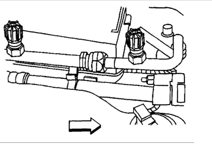

The two service ports are near each other on the refrigerant line headed from the condenser to the evaporator. Here is a diagram and a couple of guides to help you get the problem fixed.
https://www.2carpros.com/articles/air-conditioner-how-to-add-freon
and
https://www.2carpros.com/articles/how-a-car-air-conditioner-works
