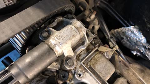

In the process of setting up the shot and seeing which tool would work best for this situation, I spun the engine over a few times. It seems to have gotten a lot quieter. It's more like a soft click than a pop now; I'm not even sure you could hear it over the background noise. Let's put this on the back burner until I get it running. I appreciate your putting focus on this.

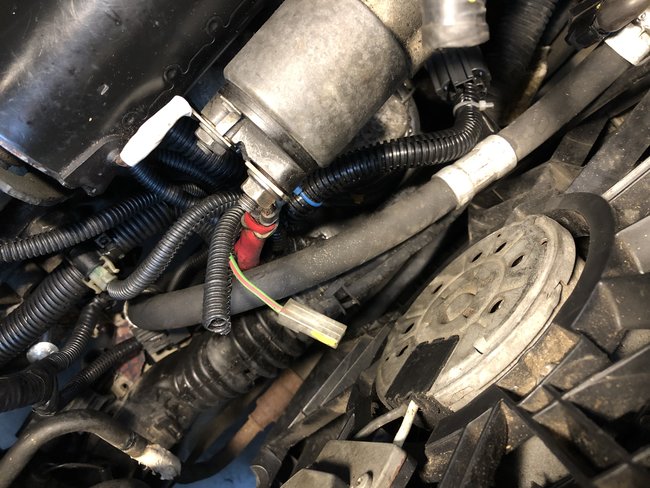

I need to know where the green/red wire with the female end goes, From what I can tell from the length, it either goes to the starter or the fan, but I can’t see the connection. Also, how should I approach the first start of the engine after doing this work. What should I listen for? Should I just let it idle for ... ?....and then drive it, or what? I’ve got my fingers crossed!

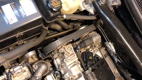

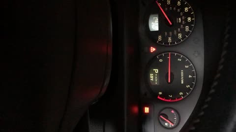

Lack of power and this is a video of the engine idling. Any idea of what could be causing this? Thanks for for excellent advice.
Sep 17, 2019 at 7:30 PM
JIS001
  • 3,412 POSTS
I see the Check Engine light came on. Scan it for codes to give us an idea as to what triggered the light.

Here’s a video. On cold start - before I took the video - it idled at about 900-1000 RPM for a minute, then started idling rough, like the last video. The picture: my crank marks are lined up but you’ll notice the cam marks are way out. The sticks point at the timing marks on the cams. The timing marks on the cam cover are highlighted in white. Looks like about 180 degrees. I hope I’m wrong.

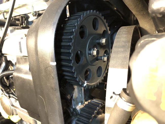

Tried to send you an update with a photo from my phone but the email function is screwed up right now. I'll explain what the photo shows.
I took a pic of the ends of the cams with the crank set on the marks. The stamped writing on the intake end is at ABOVE the center of the cam; the writing on the end of the exhaust cam is at UNDER the center of the cam. The slots are almost perfectly horizontal. I'm going to have to rotate them slightly to install the cam lock.
In review, you wanted me to take the cam sprockets off and reinstall them with the marks lined up with the cover, correct? (Using the install method for the exhaust hub that you mentioned in the last communication). Then take a pic and send it to you for you to inspect before I fire it up. I'll do that when I'm done - if this glitch with my phone is straightened out.

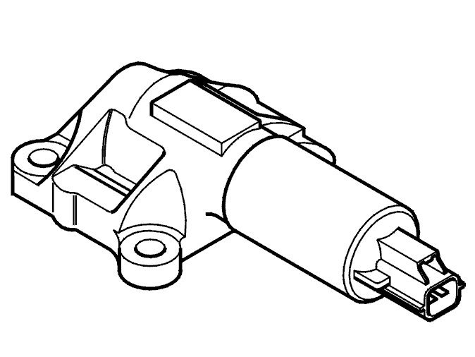

And what did you find with the oil control valve? Did you remove it, turn the engine over and see if oil pumps out? As stated earlier, I hope you did not go through all these for a faulty oil control valve (solenoid) since they always fail and set timing code due to low oil level or faulty solenoid. So please let us know why you started this big project?

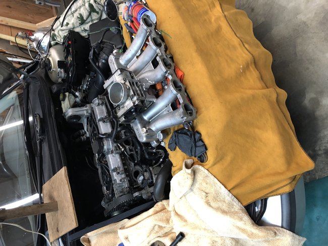

This is a 2-part answer. I'm doing this part on my PC because I have big fingers and a low tolerance for typos - which happens a lot on my iphone. I'll send you pics on my iphone after I finish this.
About this project: It began as a cam/crank seal replacement and PVC inspection and ballooned into a bunch of side fixes "because I'm in there and don't want to come back for a while."

About the oil control valve: Since I've never been low on oil, and, to be quite honest, I didn't know what an oil control valve was, I set that aside until you brought it up the second time. I Googled "oil control valve" and got results for "variable timing solenoid" and "camshaft adjust solenoid." They matched the picture you sent, so I unbolted it to look for oil. It did have oil. (I took a pic of it). Actually, the noise was coming from that area so that may be the problem. Question: How can I test it for functionality? Thanks again for hanging in there with me. I'm confident that it won't be long before I'm behind the wheel again.

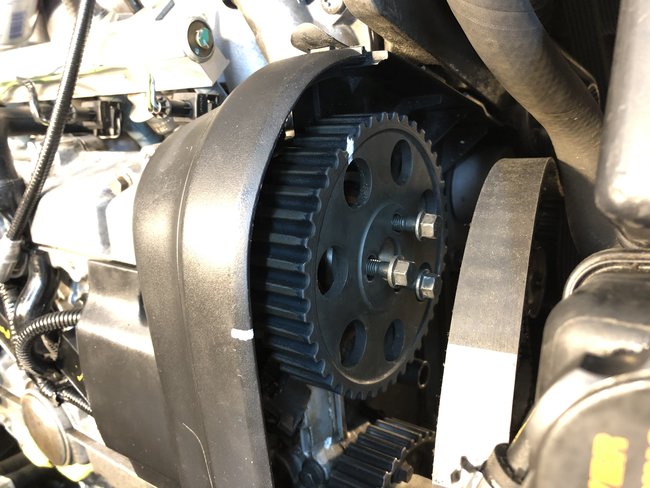

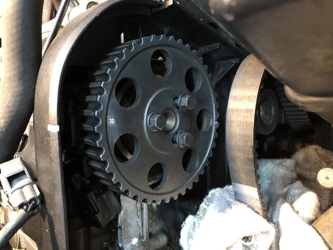

Here are pics of the cam sprocket marks in relation to timing cover marks.
Sep 24, 2019 at 11:04 AM
RICK ESTESS
  • 52 POSTS
The “M” mark on the sprocket lines up with bolts in; the thin mark does not.
Sep 24, 2019 at 11:08 AM
JIS001
  • 3,412 POSTS
That is all wrong. Lock the cam with the lock tool. The thin line lines up with the cover. How does the exhaust cam look?

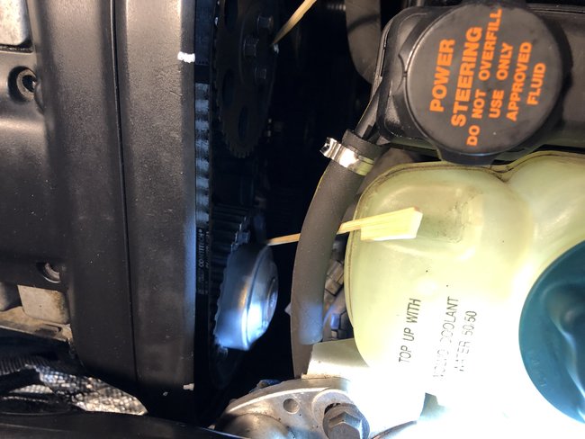

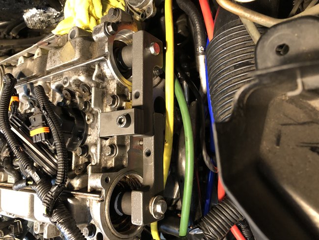

This is a photo of the cam lock tool installed at the time that I took the cam photos. With the cam lock tool on, the intake cam sprocket mark- the thin line - will not matchup with the timing cover mark when the three bolts are installed; its either an inch or so to the left, or the same distance off to the right. Not that I think it’s right, but the “M” mark does, and perfectly This is really messing with my head.
The exhaust hub/sprocket will spin wherever I want it to go, so it’s not at issue as far as I know.
The oil control valve/variable timing solenoid was full of oil when I removed it.

Can get a definitive answer on whether or "oil control valve", "variable timing solenoid", and "camshaft adjust solenoid" is the same part. I need to know in case I need to buy one. Thanks.
Sep 25, 2019 at 10:03 AM
JIS001
  • 3,412 POSTS
They are pretty much call either one of those names.
