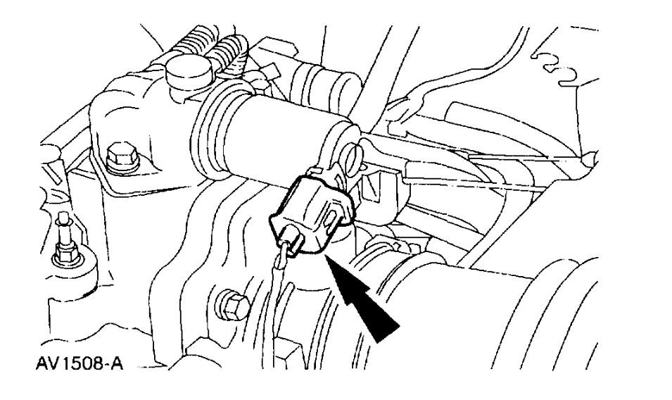

Hi
Think Idle Air Control Solenoid is at fault. Controls idle via ECM signal. Iac located on left side intake manifold try removing and cleaning with carb cleaner. Also cleanout passages.
Hope this helps

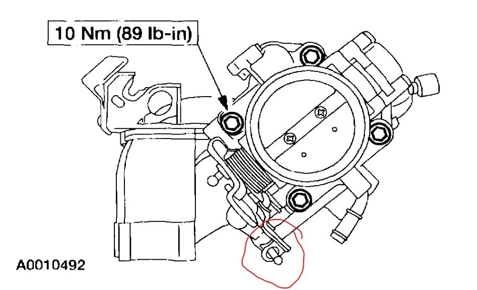

Good morning,
I would have the codes tested at a parts store to see what system is asking for help. Once we know the codes, we can help narrow the area of failure.
As far as the stalling.
I would consider the idle air control valve. It is a very common failure. You cannot clean this valve as the area that sticks is not accessible for cleaning. It is a replacement only. I controls the idle speed.
https://www.2carpros.com/articles/how-to-replace-an-idle-speed-control-motor-iac
Also, the base idle on the throttle body needs to be set at 500 RPM in neutral.
https://www.2carpros.com/articles/stall-at-idle
Check these and let me know what you find.

Hi, you have a vacuum leak or the IAC motor is bad. If no vacuum leak is pressent replace the IAC valve.
let me know how it goes,,, thanks for using 2carpros.com
https://www.2carpros.com/how_does_it_work/how_an_idle_air_control_iac_works.htm
