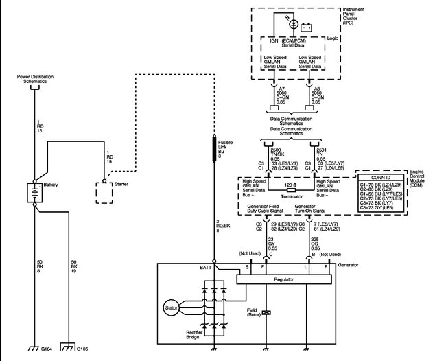

GM went from, in my opinion, the world's second best generator to by far the worst pile starting with the 1987 model year. The failure rate is very high, but that still did not satisfy the engineers. Now they added two not-so-reliable computers to the charging system. System information is calculated by the instrument cluster, then that data is transmitted to the engine computer. The engine computer controls the generator.
I do not have any information on this system's operation, but if the generator works as the diagram suggests, you can try taking some readings on the two smaller wires plugged into the generator. The orange wire is the turn-on signal that tells the voltage regulator to start running the generator. In the past, you would find about two volts on that wire with the ignition switch on and the engine not running. The other ten volts was dropped across the "battery" light on the dash, so that light was on. Once the engine is started and the generator is producing output, the regulator puts fourteen volts back out on that wire to turn the "battery" light off. If you find zero volts on that wire, suspect the engine computer or a break in that wire.

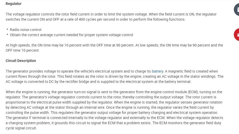

The gray wire is a duty-cycled feed for the generator's field winding. In the past that just had full battery voltage applied to it all the time. It is where the voltage regulator sensed system voltage and it was the supply for the field winding. There is no description to indicate how much this signal affects the generator's performance. To add to the misery, being a duty-cycle signal, it is a stream of voltage pulses that vary between zero and some maximum voltage, typically twelve volts, so it cannot be measured with a digital voltmeter.

To add to what Doc posted. This is the charging circuit. Because of the way it operates you really need a scope to tell if the charge signal is getting to the alternator from the computer. The OEM tests use a scan tool, battery load tester and the charts below.
A shortcut I use to find if the problem is wiring or ECM is to remove the ECM connector and test the wiring from it to the alternator with a continuity tester, While it is on the circuit I will go along the harness and move the wires/connectors just to be sure there are no breaks.
If the wires are good and you have tested the alternator for actual output then the issue is likely in the ECM itself.

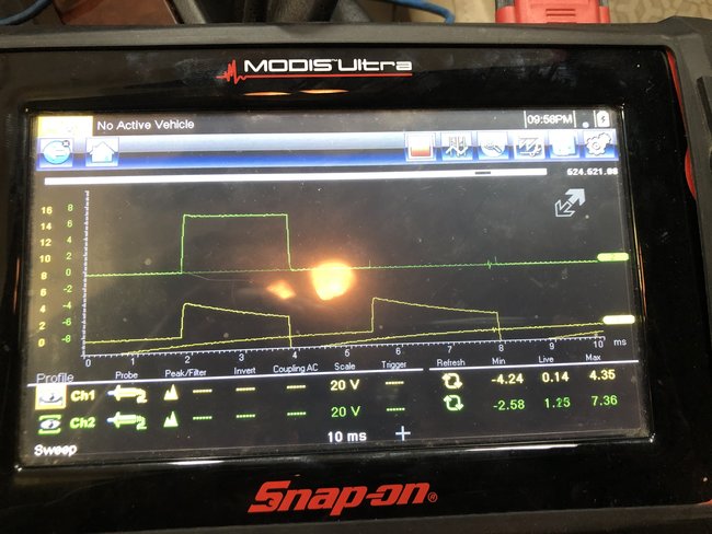

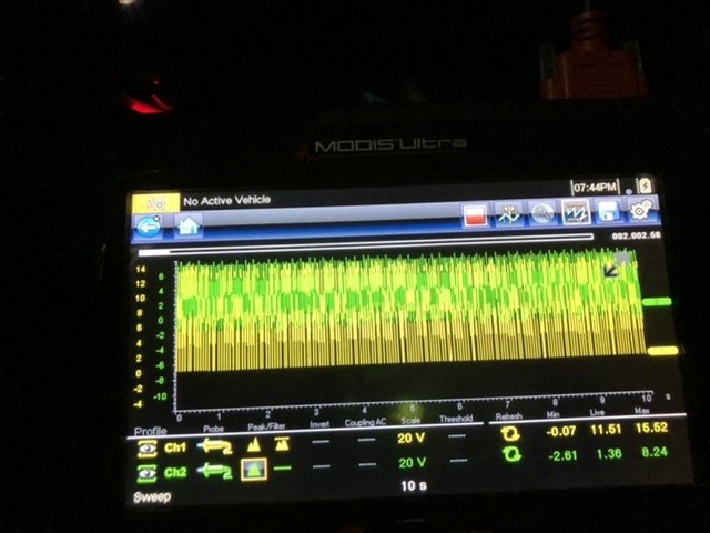

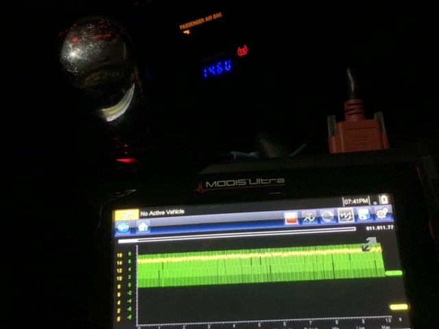

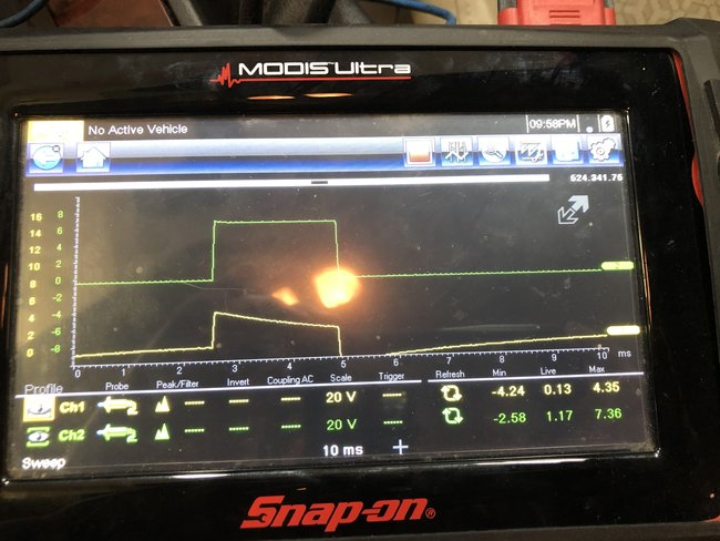

Okay Roy, I got home and set up the scope watching the orange wire (green trace) and the grey wire (yellow trace). The first image is cold start, normal charging. The second image with the yellow drop is the moment it stops charging, and the third pattern is not charging at all. Also, I cleared the codes and picked up a P0621 when the car was restarted.
Mar 6, 2020 at 4:40 PM

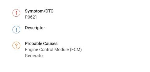

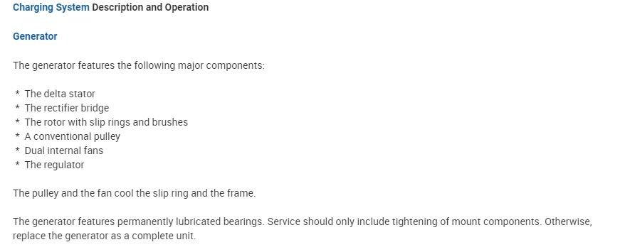

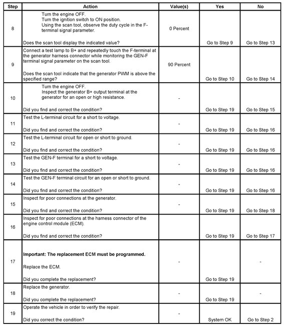

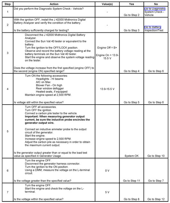

I attached the flow chart for the 621.
Were all the ECM flashed to the VIN?
Charging System Test

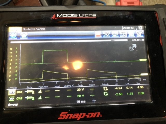

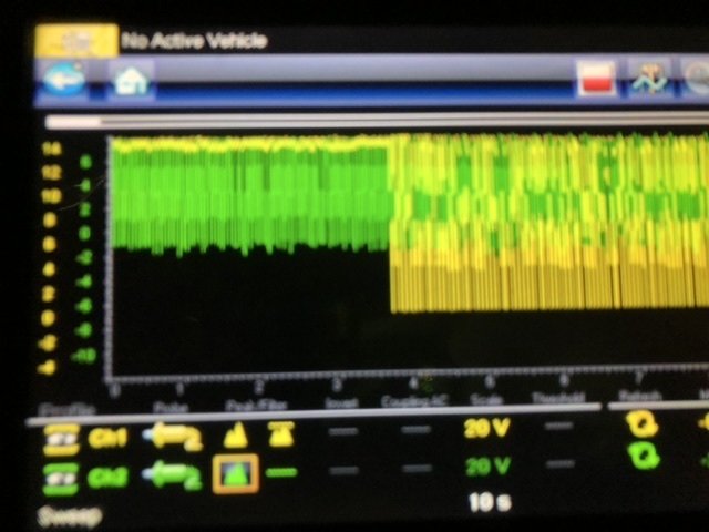

Hi Roy. I solved the p0621. engine running - the t pin i used to check voltage at the ecm on the orange wire must have shorted to a pin next to it. I had B+ on the orange wire KOEO with the alt unplugged - at the alternator. After the t pin was removed I get 4.01volts. I read that as correct for step 3 in circuit testing. Step 2 was 0.01 volts, I also read that as good. What I have left to figure out is low charging. I reran the lab scope test orange wire + yellow pattern, and it looks more like I would expect. I still drive the battery voltage down below 11 volts at Idle. I get to about 12.3Volts if I turn ALL accesories off. loads on I slowly drive the voltage down even at 2000 RPM. I will add the patterns from cell in a minute.
Mar 6, 2020 at 6:23 PM
JAYJAY3
  • 24 POSTS
Scope pattern engine running, idle, orange = yellow.
Mar 6, 2020 at 6:39 PM
Good find. I am concerned that the short you found may have damaged the alternator.

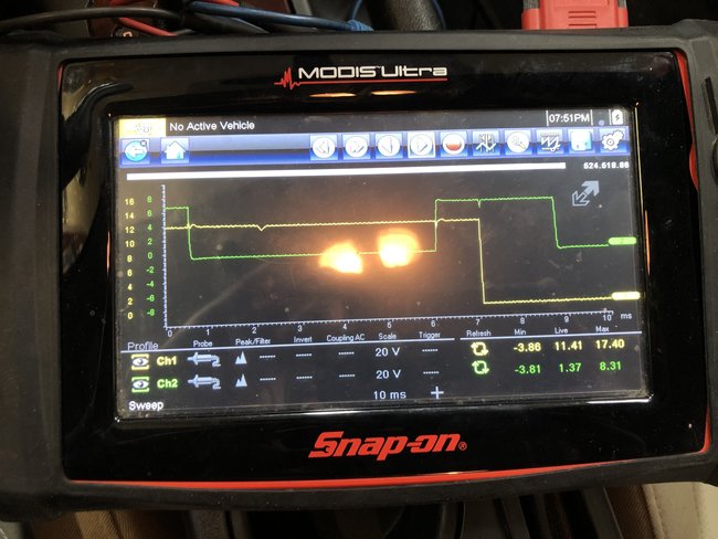

Yellow trace is orange wire.
Mar 7, 2020 at 5:03 PM
Yes, that is better. Looks good.
You only need a 194 bulb as it is 5 ohms. That is enough to load a circuit.
