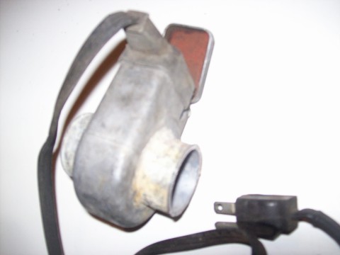

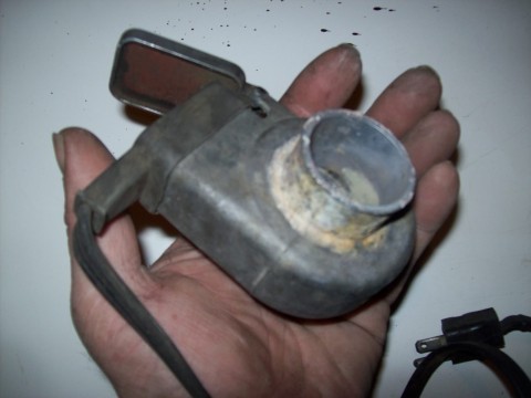

I don't live at the northpole as it sounds like you do, but it get's cold down here in s.c. too..........anything under 6o degrees is cold to me!.....but really, at 20s and 30s, just about any machine needs to warm up to operating temperature before you can expect tip top performance.
I mean like---artificial warmth or just let it idle for 5-10 minutes before you take off! Even way back, your horse didn't operate well till he had a warm up!
I really am trying to help....this is how i approach the old vehicle way---as i still drive....if you still think you have a mechanical issue and no one else jumps in with another answer....i will find you another expert, let me know if that's what you want.

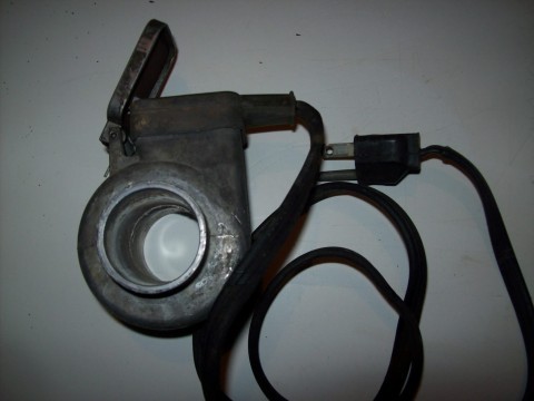

I'm sure you are probably familiar with this or something similar.....ex-girlfriends '82 mustang 2oo 6 cylinder was very cold natured.......i fell into this at a yard sale for $5 still boxed up. It installs on the lower radiator hose as close to the radiator as possible.......warm water rises!
I had it plugged into a timer and drove a post in where she parked.
She was a bit on the "lazy, inattentive" mode at times, so i kinda put a small hose clamp around the plug portion and a piece of 550 cord (parachute cord) and tied that to her car and tied the extension cord to the post
Presto!!!---if she backed up, it unplugged itself! (and the wires didn't get snatched out!)
I know they make "dipstick heaters" too---i know little about how good they work
But i can tell you this
The timer was set to come on 3 hours before she drove it
The window stayed defrosted because i guess that was "default" on the heater box, and the heater core got warm
And there was "warmth" coming out of the vents when you 1st cranked up
The engine and radiator were pretty warm
It ran a lot better, until it fully warmed up
This thing came from napa originally, and after seeing this one, one of my friends got one, i think it was under $40, but don't hold me to that ---i still have it.......it was used it about 8 years ago

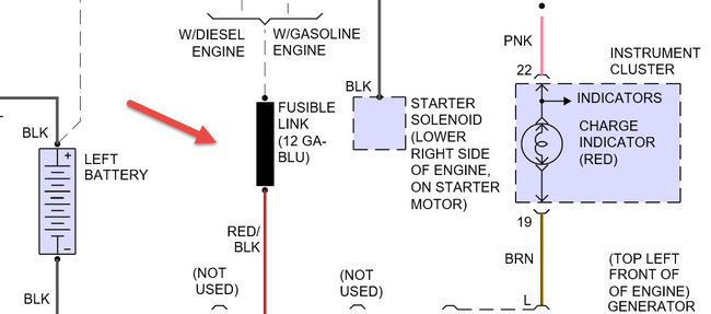

check fusible link for generator it may not get proper voltage with lights on maybe a strand holding it together. what is voltage at battery with lights on and off
