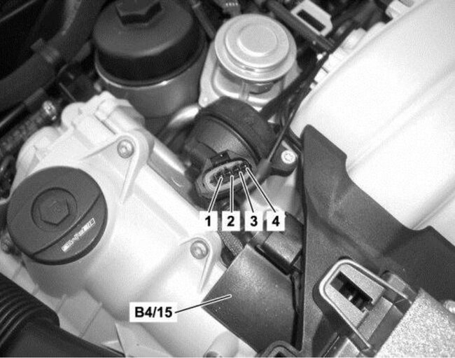

Checked the connector. It has 4 pins but three wires. Removed it looks ok. Tested the voltage by placing meter's pin on pin 1 abd the other on pin 3, got 4.21 then 4 then 4.06 just fluctuates. Started the car and it ran not sure if the pump is weak abd causing that. I want to read the codes again once it stop running

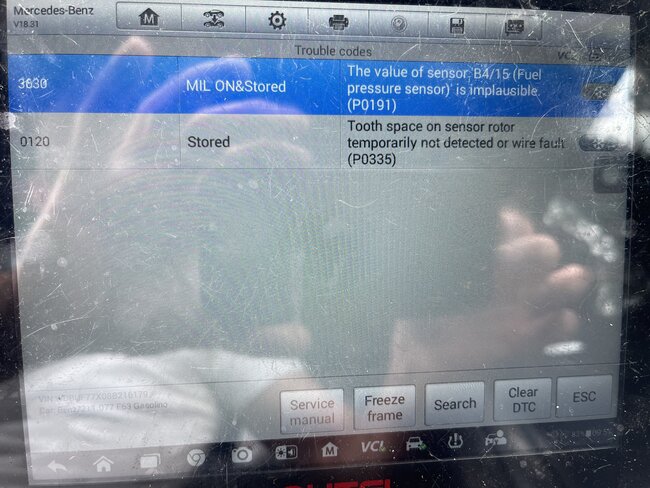

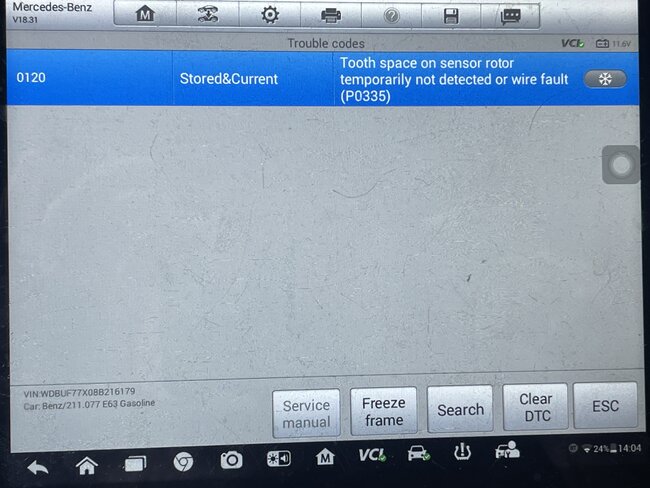

Will stay running a bit rough theb dies, also have code p0355

P0355 is a cylinder 5 coil implausibility code. It might share a circuit with the pressure regulator but the diagrams I have doesn't really show one. It does show a connection to the crank sensor and the oil temp sensor. No real way to test the pressure sensor other than replacement as MB keeps that info in the dealer network.

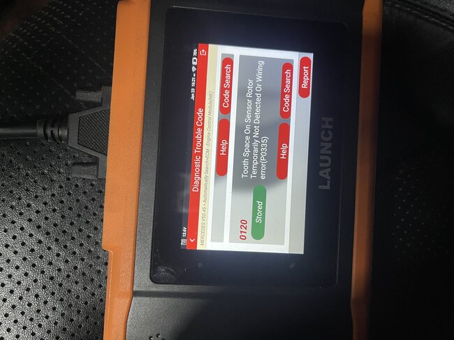

Sorry p0335 not 355
Jan 23, 2026 at 5:04 PM
STEVE W.
  • 15,113 POSTS

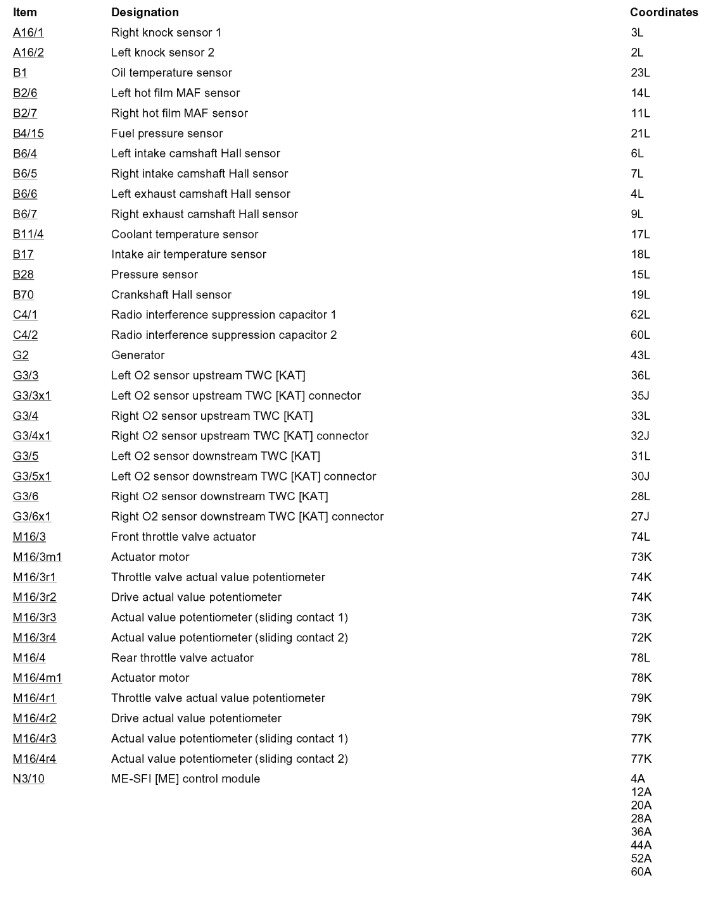

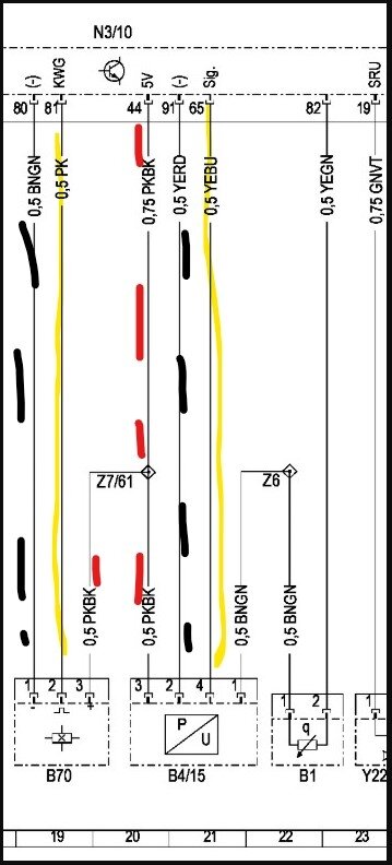

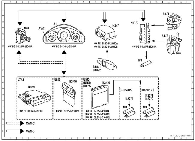

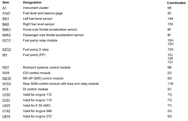

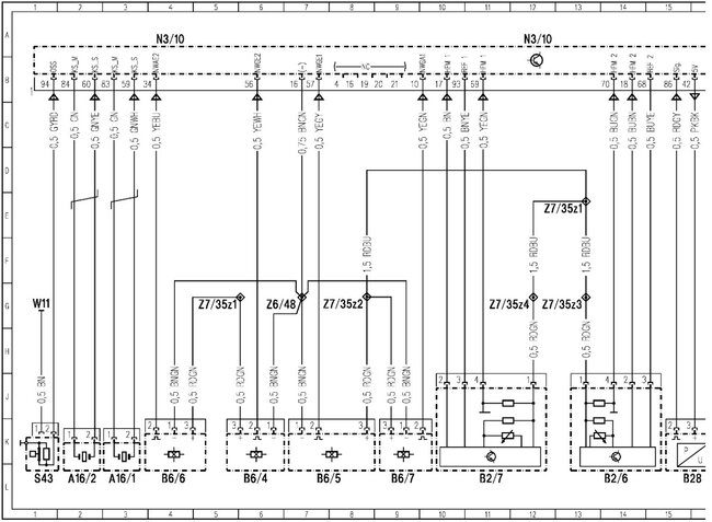

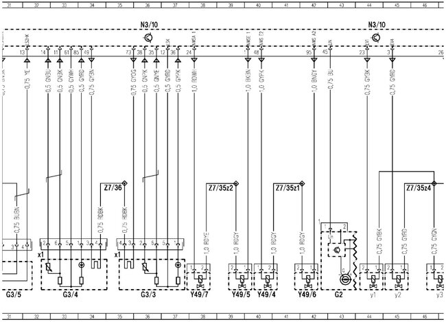

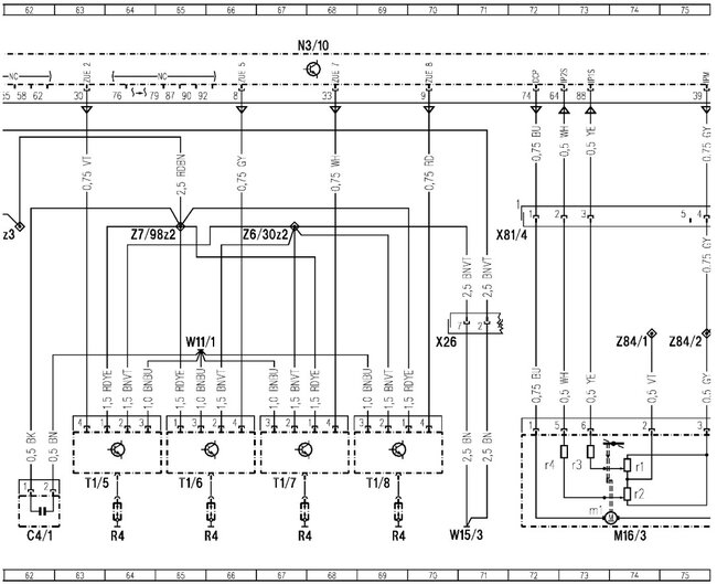

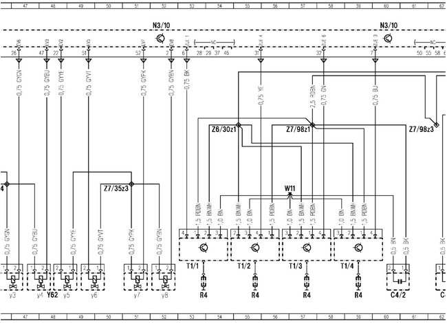

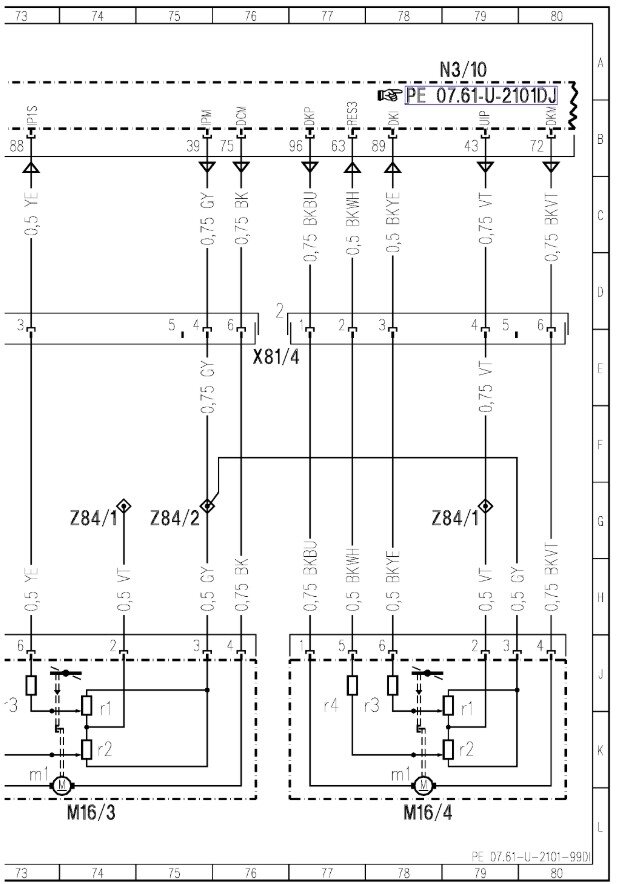

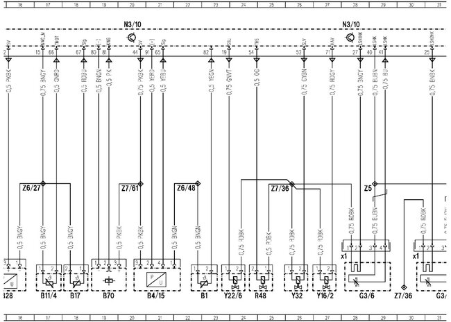

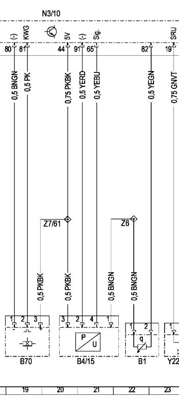

OK that is an odd code, Basically says that the spacing of the teeth on the crankshaft for the crank sender is wrong, or more likely there is a wiring fault to the sensor. You mention you only have 3 wires but there should be 4 and one is shared with the crank sensor.
In the earlier image, B4/15 is the oil pressure sensor, B70 is the crank sensor and B1 is the oil temp. Since you are showing a code for the pressure and the crank, I'd look at the shared parts which is pretty much the 5 volt feed and the PCM, but as your 5 volt feed was bouncy I'd check it right at the PCM pin 44 If it's steady there then I'd unplug the crank and fuel sensors and see if it still bounces with them unplugged. Could simply be a bad sensor pulling the bias voltage down.
Jan 23, 2026 at 8:44 PM

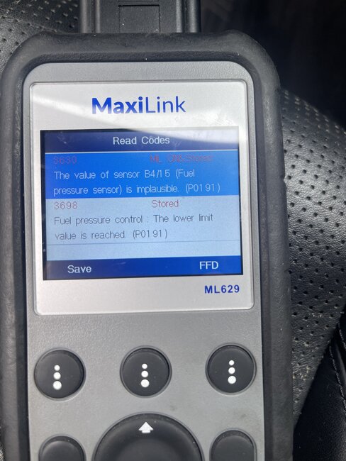

The code you have is fuel pressure sensor implausible. The pressure it is sending is higher or lower than the pressure it is requesting it falls into this tree of codes -
The value of sensor B4/15 (Fuel pressure sensor) is implausible. (P0191)
Fuel pressure is too high. (P0191)
Fuel pressure is too low. (P0191)
Fuel pressure control : The lower limit value is reached. (P0191)
Fuel pressure control : The upper limit value is reached. (P0191)

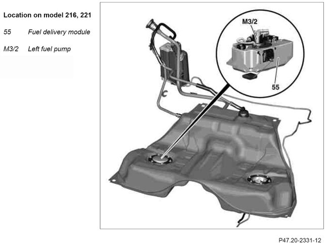

All of them start with testing the two fuel pump control modules for faults. Then they want you to use the scan tool to select a pressure for each module in turn and use the sensor reading to see if the modules operate correctly. So basically you turn on one pump to say 50 psi, then look at the sensor, it shows 50, now select the other control module at 50 and check the sensor, it reads 25, that pump module is the issue. Probably could do that using a pressure gauge on the rail in place of the sensor, then watch the gauge as you cycle the pumps on and off. If both pumps read the same then it's likely the sensor itself.

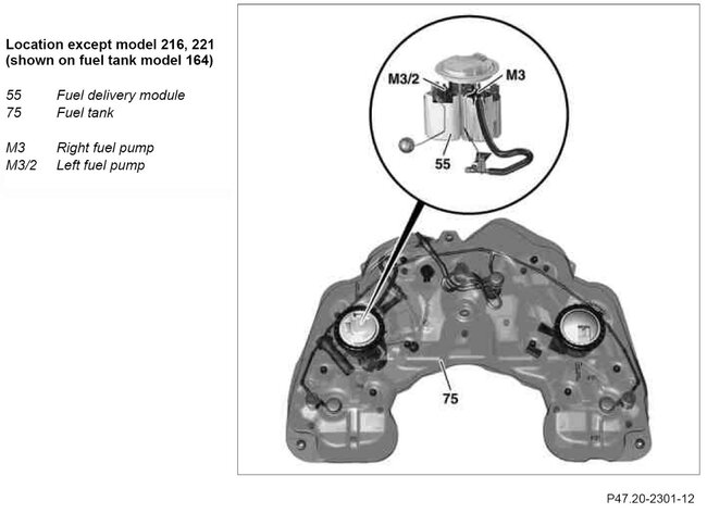

Both pumps are in the same pump module, there is a level sending unit and strainer sock on one side and the pumps are both on the same side with one pump connected to the other side with a hose in the tank.

So bot pumps are on the passwnger side. But how will i know which pump is sending which pressure when i connect the gauge to the fuel rail valve? So i can eliminate which one. And if both readings showing sane then module could be bad?

You should be able to power them individually using a scan tool as they can be controlled individually. So if you turn on pump 1 and get a correct reading, then pump 2 and get the same reading the pumps and control modules should be OK. The issue so far Is that nothing I've seen shows the actual fuel pressure, just the range the sensor reads and tells that you compare the requested pressure to the sensor read pressure.

Tight access could mean the harness has a spot that rubbed. You should be able to monitor the 5 volt from the fuel pressure sensor. Just back-probe it and see if it stays constant. Say it is 4.99 key on engine off, but when it's running it bounces around or drops to 4 volts, that is the problem.

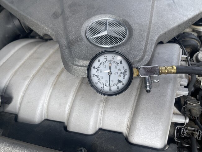

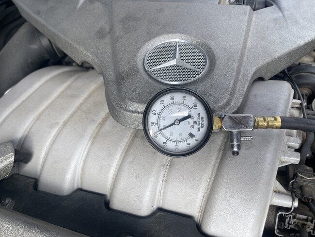

I checked the pressure. First reading is when ignition on, second one when started, Stayed around 40, 5 minutes later was around 35-38, when reved up goes to 40 again. After few minutes went to 32-34 and sometimes goes up to 38 or so. Now its hovering around 30. Will update again once it dies
Feb 17, 2026 at 9:34 AM
BHAMDOC1
  • 102 POSTS
Hovering" around 28-35. Now it wont stall lol. I shut it off and started it back up gauge was at 52, then idles down to 34.
Feb 17, 2026 at 9:44 AM
BHAMDOC1
  • 102 POSTS
I left it xonnected and cane back an hour after and found it at 50 psi with everything off, so the injectors are not leaking. But am not sure what is the range for the fuel pressure while running. I doubt the 30s is the right range and may indicate a weak pump
Feb 17, 2026 at 10:53 AM
BHAMDOC1
  • 102 POSTS
Cane back an hour after to see where the pressure is and was holding at 59 when off
Feb 17, 2026 at 11:03 AM
BHAMDOC1
  • 102 POSTS
Cane back an hour after to see where the pressure is and was holding at 50 when off. Now running and holding at 50
Feb 17, 2026 at 11:32 AM
BHAMDOC1
  • 102 POSTS
Still idling and pressure at 50. Started it 3 times and its fine. Not sure. Now check engine light went off on its own ugh
Feb 17, 2026 at 11:52 AM
STEVE W.
  • 15,113 POSTS
I would expect 50 to be about normal, but I would also look at the 5 volt signal to the pressure sensor. If it were lower than 5 volts the sensor would read wrong and tell the ECU the wrong info and give you the wrong pressures. Might be worth it to find the pump power feeds and test them without the control module adjusting them.

I rechecked the harness to the fuel pressure sensor and it reads 4.87v
Feb 18, 2026 at 7:24 AM
STEVE W.
  • 15,113 POSTS
That should be OK, the question is does it stay at that voltage or does it drop out while the engine is running and cause the issues you are seeing with the crank code and fuel pressure sensor because they share that 5 volt feed.

The 5 volts stays constant. The system controls the pumps via a PWM signal. the sensors however get a solid 5 volts on the pink and black and a ground. They only share the 5 volts. If it is dropping out or even just dropping lower it will change the signal back to the ECU.
