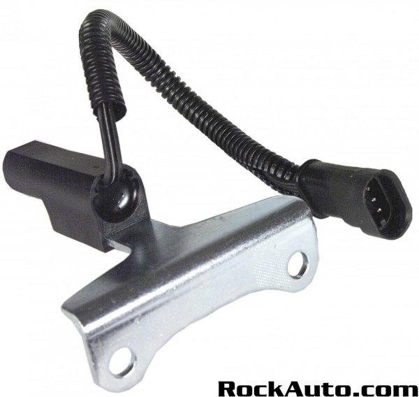

So the engine does turn, hence my confusion. It sounds like you are describing a simple case of forgetting to remove the crankshaft position sensor before working on the clutch. I am not sure why replacing the flywheel is necessary. There are differences in the numbers and locations of the notches in the ring around it that are detected by the sensor. Those pertain to different years and engine sizes which is why some people run into unexpected problems when they change their engines and use one from a different year. As long as you keep the original flywheel/torque converter, there will not be a problem.
It sounds like you are looking at a crankshaft position sensor for a different engine. Here is a photo of what yours looks like. I looked at applications two years older and two years newer, and other engine sizes, all for Dakotas, and there is no other sensor style shown. I have seen what you described with just one mounting hole, but those were typically found on front-wheel-drive cars and minivans.

The old sensor bracket was made of solid material (some type of metal) it had two holes for mounting.. We double checked OEM's Dodge dealer picture is what we were given. We attempted to use old flywheel and were told no must get new one. Dodge Dealer. Manual shop/Chrysler does not mention removal of sensor first but that is a logical step. When removed the metal crumbled. Went to "junk" parts and found same type of sensors and they were made the same as mine and they were crumbling, as well. New fly wheel notches are the same , however, there are marking lines midway from the center to edges of same. Dodge has not been helpful in this situation, either. All parts numbers were verified by Dodge The only difference with the photo of sensor is the color of the metal bracket. They have two mounting holes and they line up with old mounting plate. Plate on body of truck dates it manufactured 03/1996 and I have a 3.9L engine.

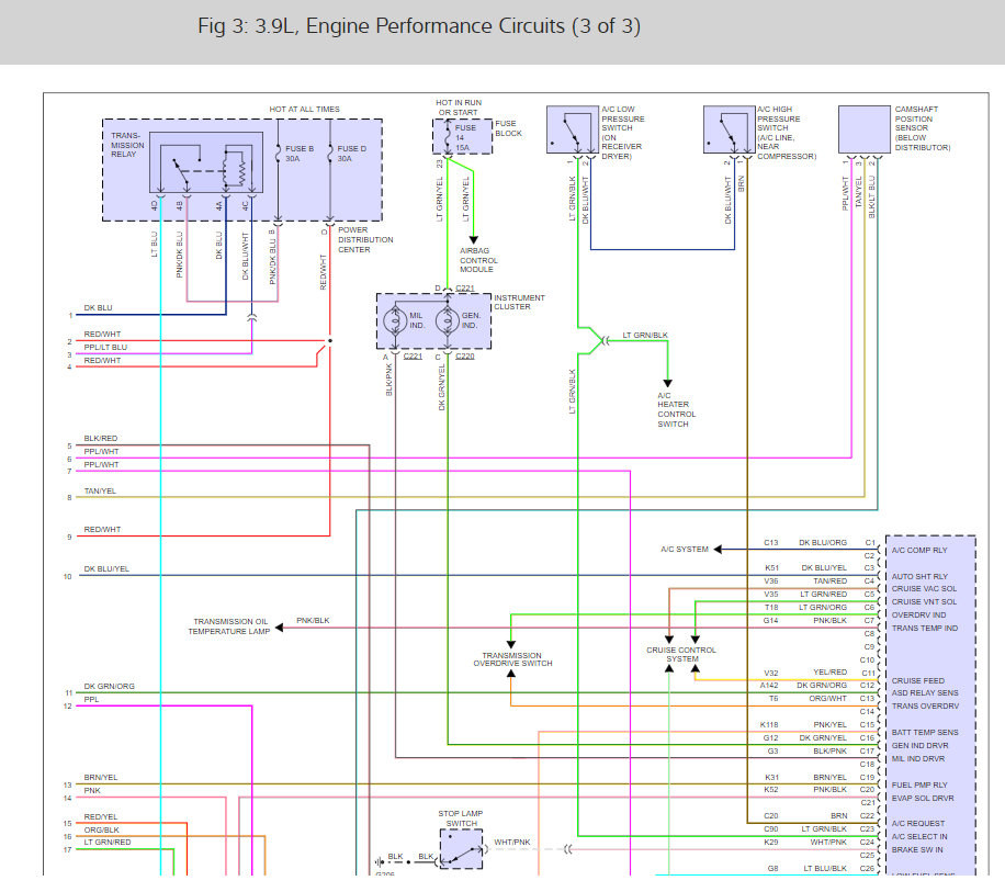

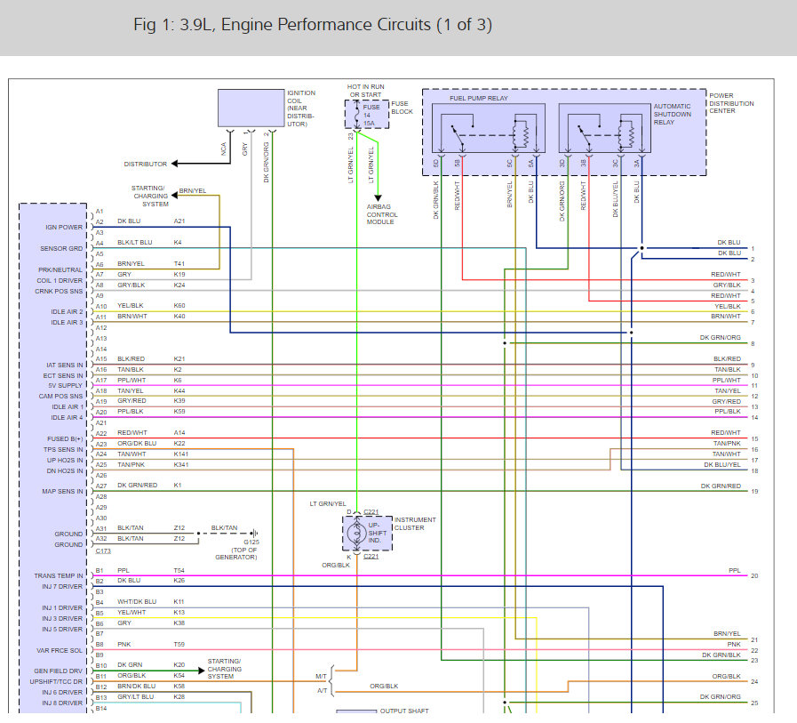

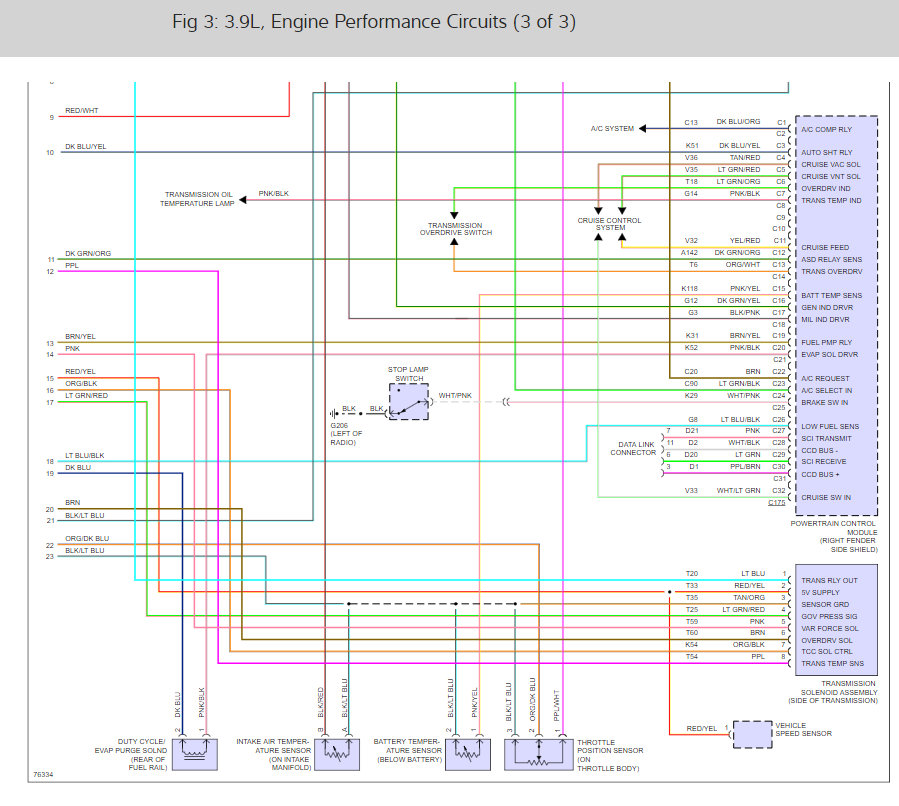

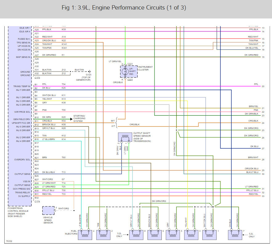

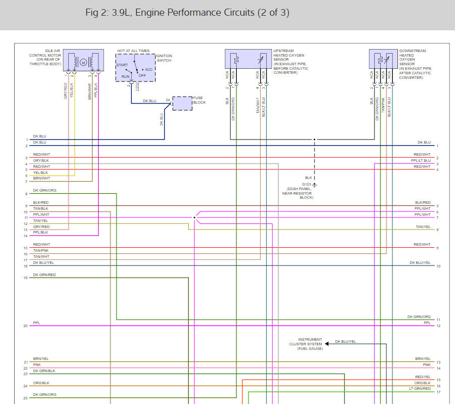

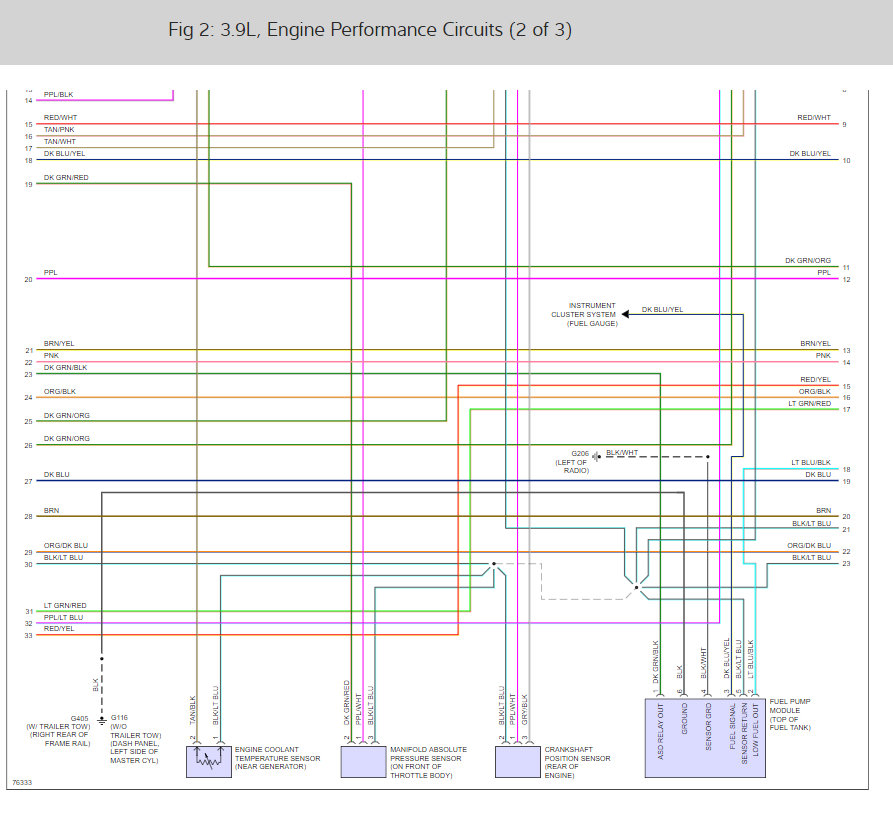

We are missing something here, does the engine have compression? if so spark and you can hear the fuel pump in the tank prime for five seconds?
Has Mr Compo tested the wiring harness for connection power and ground. If not I think that.
Has the ASD relay been checked?
Check out the diagrams (below). Please let us know what you find.
