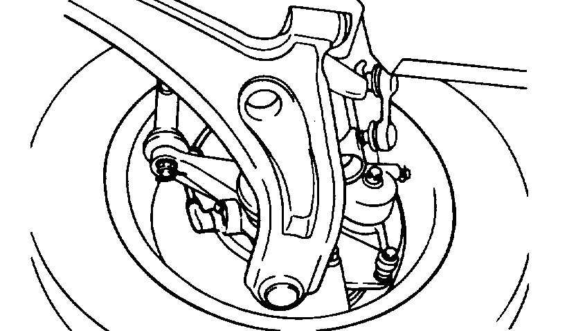

FRONT
pic 1
REMOVAL

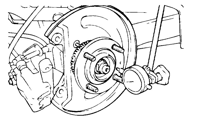

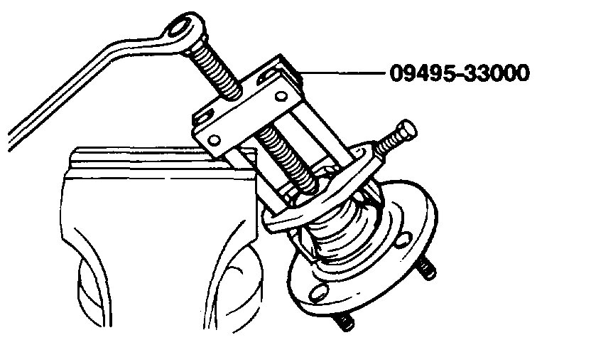

pic 2
2. Remove the drive shaft nut.

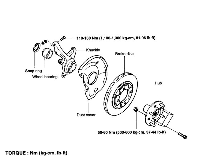

pic 3
4. Remove the front brake assembly from the knuckle and suspend with a wire.

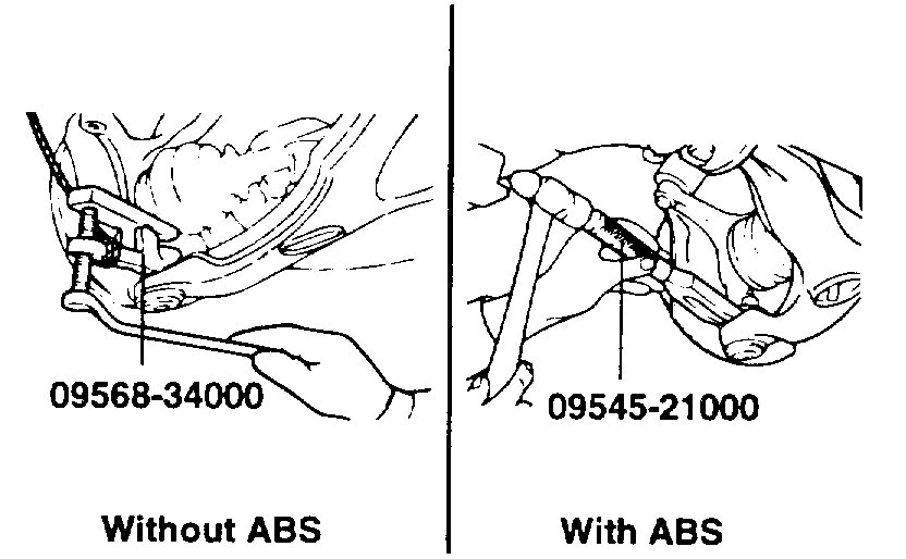

5. Disconnect the lower arm ball joint from the knuckle using the special tool.

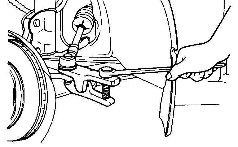

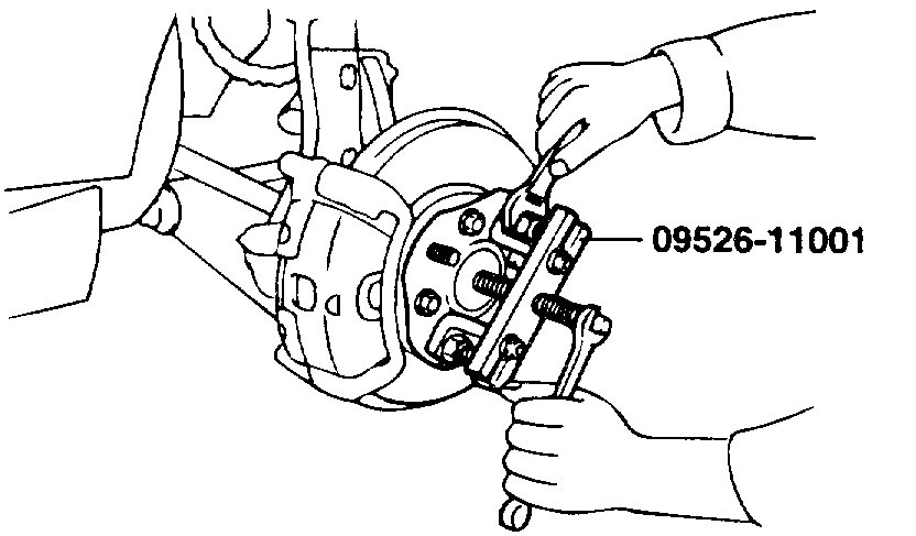

pic 4
6. Disconnect the tie rod and ball joint from the knuckle using the special tool.
NOTE:
1) Be sure to tie a cord to the special tool and to a nearby part.
2) Loosen the nut but do not remove it.

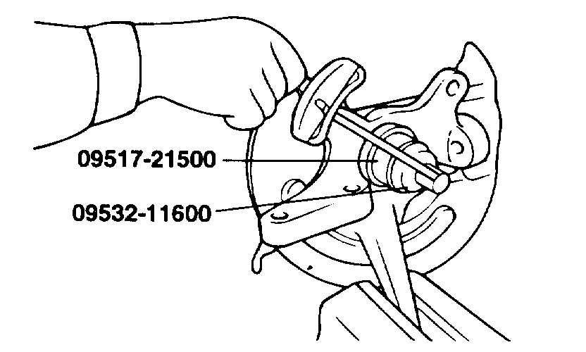

pic 5

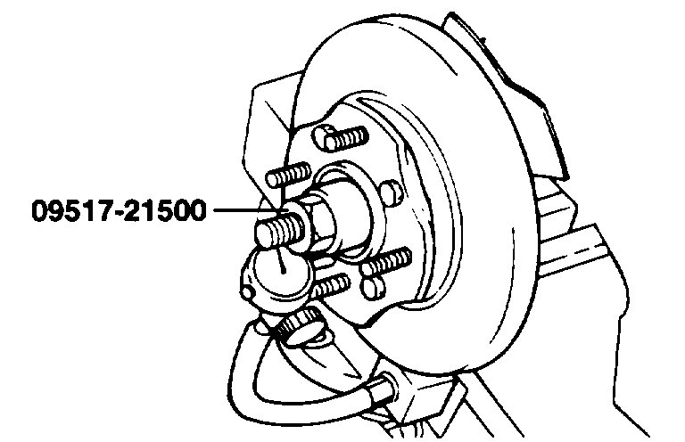

7. Disconnect the drive shaft from the hub using the special tool.

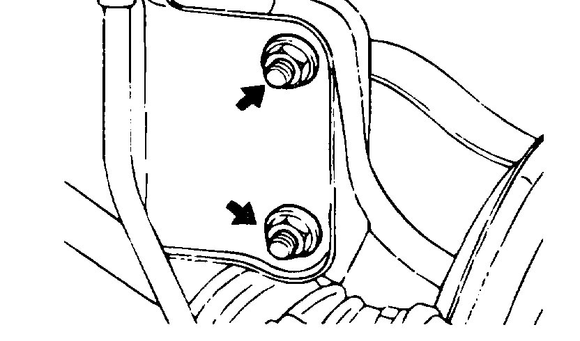

pic 6
8. Remove the hub and knuckle as an assembly from the strut.

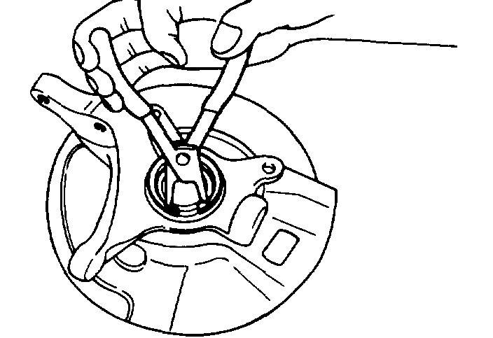

pic 7
1. Remove the snap ring.

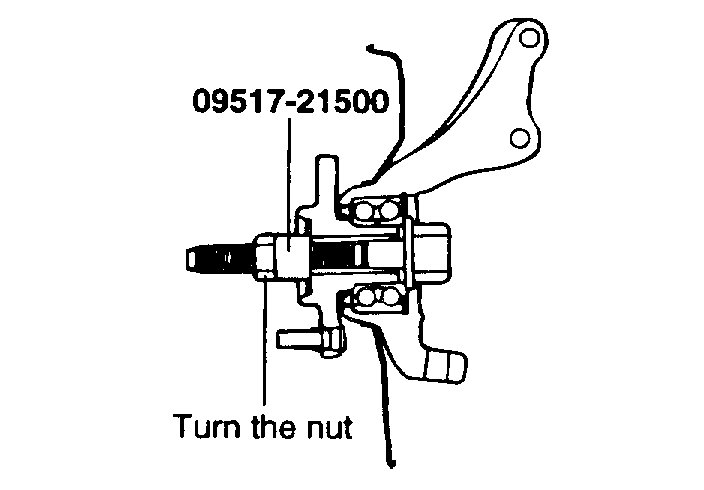

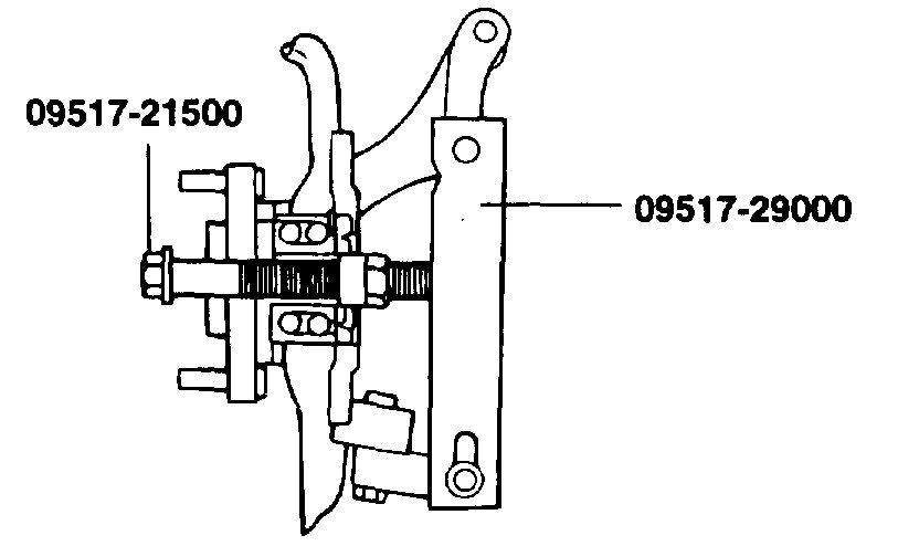

2. Attach the special tools to the knuckle and hub.
3. Secure the knuckle in a vise.
4. Tighten the nut of the special tool and remove the hub from the knuckle.

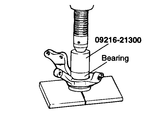

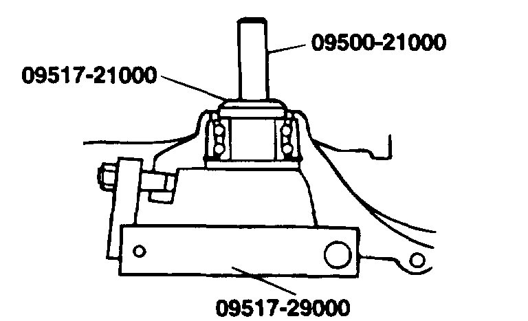

pic 11
3. Press-in the bearing by using the special tool.
NOTE: Do not press inner race of wheel bearing assembly.

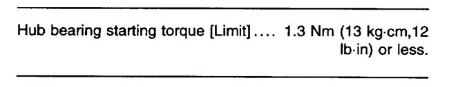

5. Measure the hub bearing starting torque.

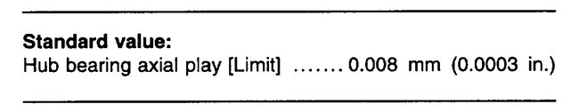

6. If the starting torque is 0 Nm (0 inch lbs.), measure the hub bearing axial play.
pic 16
7. If the hub axial play exceeds the limit while the nut is tightened to 200 - 260 Nm (2,000 - 2,600 kg-cm, 148 - 192 ft. lbs.), the bearing, hub and knuckle have not been install correctly.
Repeat the disassembly and assembly procedure.
