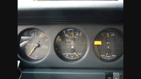

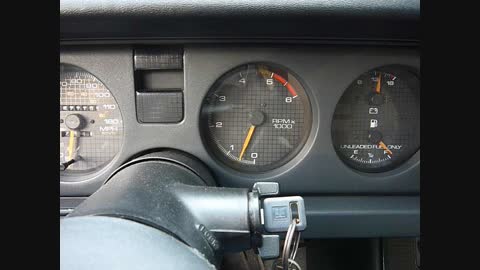

Hello. The engine codes gave nothing but '12'. The first attached recording is a cold start. The second is a subsequent start after it had warmed a few minutes. I normally don't hear anything when I turn the key to 'on', but with the jumper wire in place the fan would come on when the key was on. The car hadn't been started in about two days so it wasn't warm.
A couple months ago, before I started using the additives, the first start did not start it at all. On the second try there was no cranking before it caught. It was as fast as it usually is, as if it had been primed by the first try even though it didn't sound like any priming was happening because it wouldn't start at all on the first try.
Now that I'm using the additives it sounds more like it wants to start. On this cold start, I held the starter and the engine caught at thirteen seconds. It idled rough and loud gradually smoothing out as it warmed up. I've never needed to hold the starter on for this long. Every time I tried it started better.
I'm on my second tank of gas with anti knock additives. I went from 13.7 MPG 2 months ago to 19.4 MPG this week. That's a normal number.

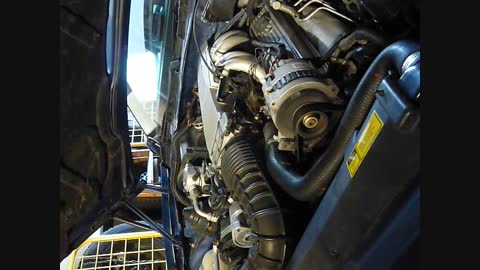

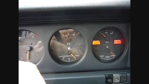

Hi Ken. I couldn't do everything you described, but I could see nothing wrong with any hoses, found no leaks. TB & MAF had already been cleaned a few weeks earlier but I did it again.
It's been slowly starting better on its own over time. Then I realized all the symptoms I was seeing could be due to carbonization in the
cylinders & on the plugs so I did a thorough cleaning by spraying different cleaners into the TB of the running engine 3 separate times.
The results were immediate. The next day it had no trouble on it's cold start and it idled smoother. Here are audio recordings and videos of dash from the first start the day after the triple cleaning. Recordings are inside car, windows open, but not in the garage as were previous recordings. The 3 attachments are just sections from the first cold start after cleaning.
#1 Started by itself, no help from me, gets quieter, camera braced on steering wheel-can see the shaking, sounds like a truck. Trouble codes after check engine light came on were 33 & 36.
#2 About 4 minutes. Warming up, smoother. Temp gauge shows it's not yet fully warmed.
#3 About 7 minutes. RPM a little low, usual about 750 stopped & in gear. Smoother, quieter. Pulling back into garage.
Last couple days no starting problems, no preignition under load. I don't understand the initial shaking & loudness in first video. Maybe because this was the first start after cleaning and it's not used to the new conditions yet? Sometimes I've heard the strange "wet" sound again on mild acceleration too. Kind of a gurgling sound, maybe from passenger side. It sounds obvious to me but nobody knows what I mean.
