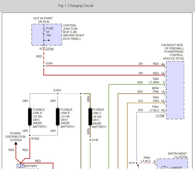

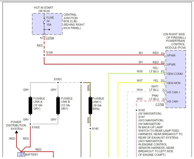

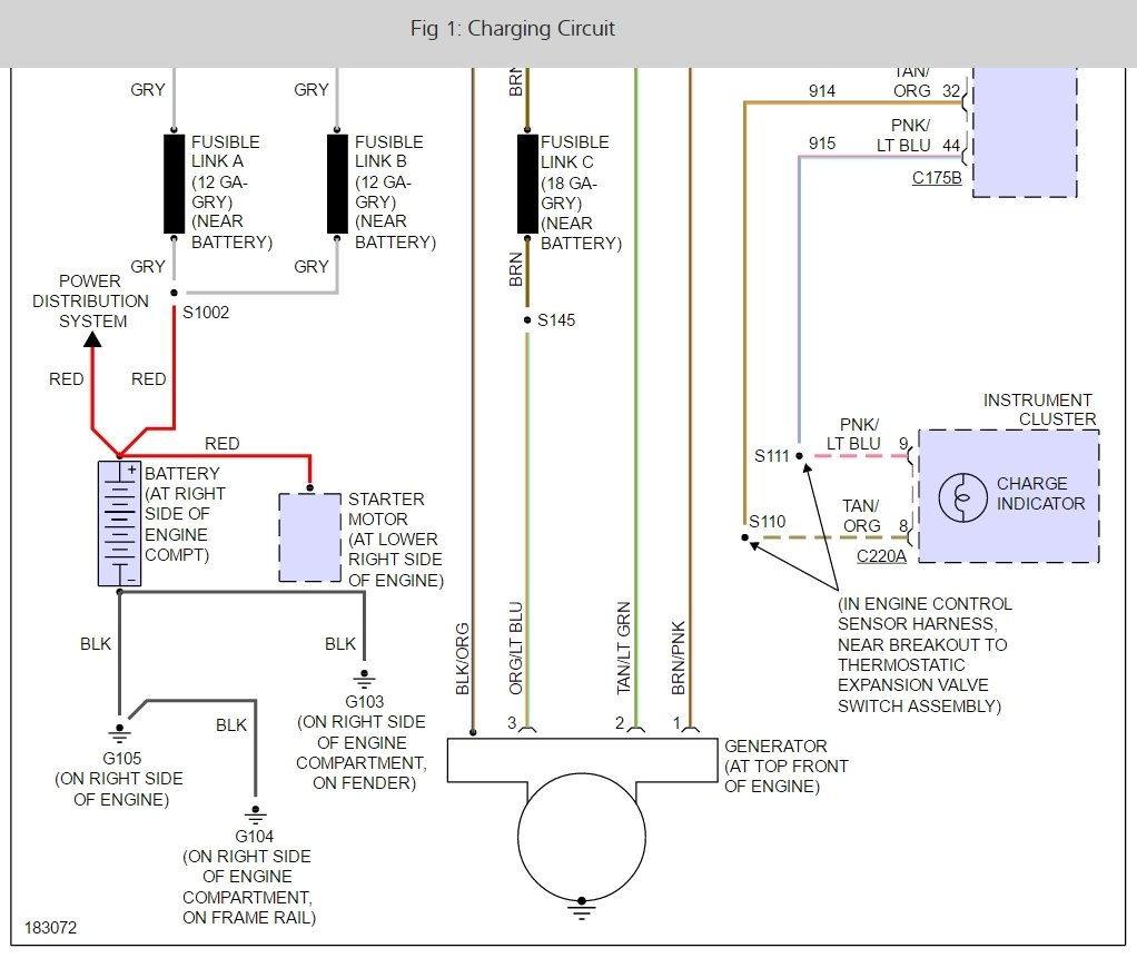

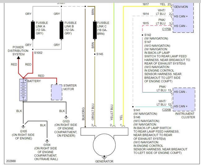

Here is a guide and some diagrams to help us find the problem:
and
and
Cheers,

I found this wiring diagram for you, look at the connector at the alternator to see if they have been over heated which will cause a bad connection. Also, check the fusible links,
Below is a wiring diagram that will help.
Please let us know what you guys find so it will help others.
Best, Ken

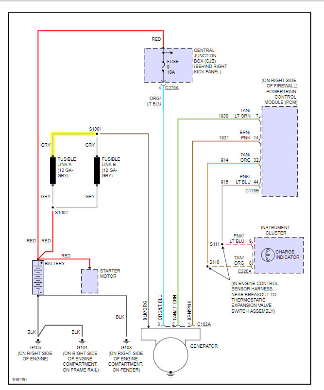

RASMATAZ
  • 75,992 POSTS
Check fuse no.34 15amp again it has a computer also called powertrain control module and see below
https://www.2carpros.com/forum/automotive_pictures/12900_alty1_20.jpg
https://www.2carpros.com/forum/automotive_pictures/12900_alty2_13.jpg
