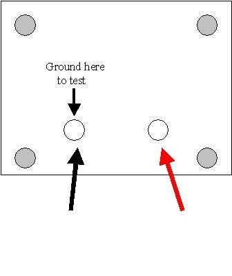

Here is a drawing of the regulator. There is always four screws in the corners that bolt it to the back of the generator, then there are two screws that hold the brush assembly to the back of the regulator. Those are the two screws to take the readings on. When looking right at the regulator, the screw to ground is the one with the black arrow pointing to it. The other one, with the red arrow, must have twelve volts all the time, but often there is a round, gray plastic cap on it that must be popped off.

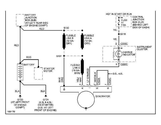

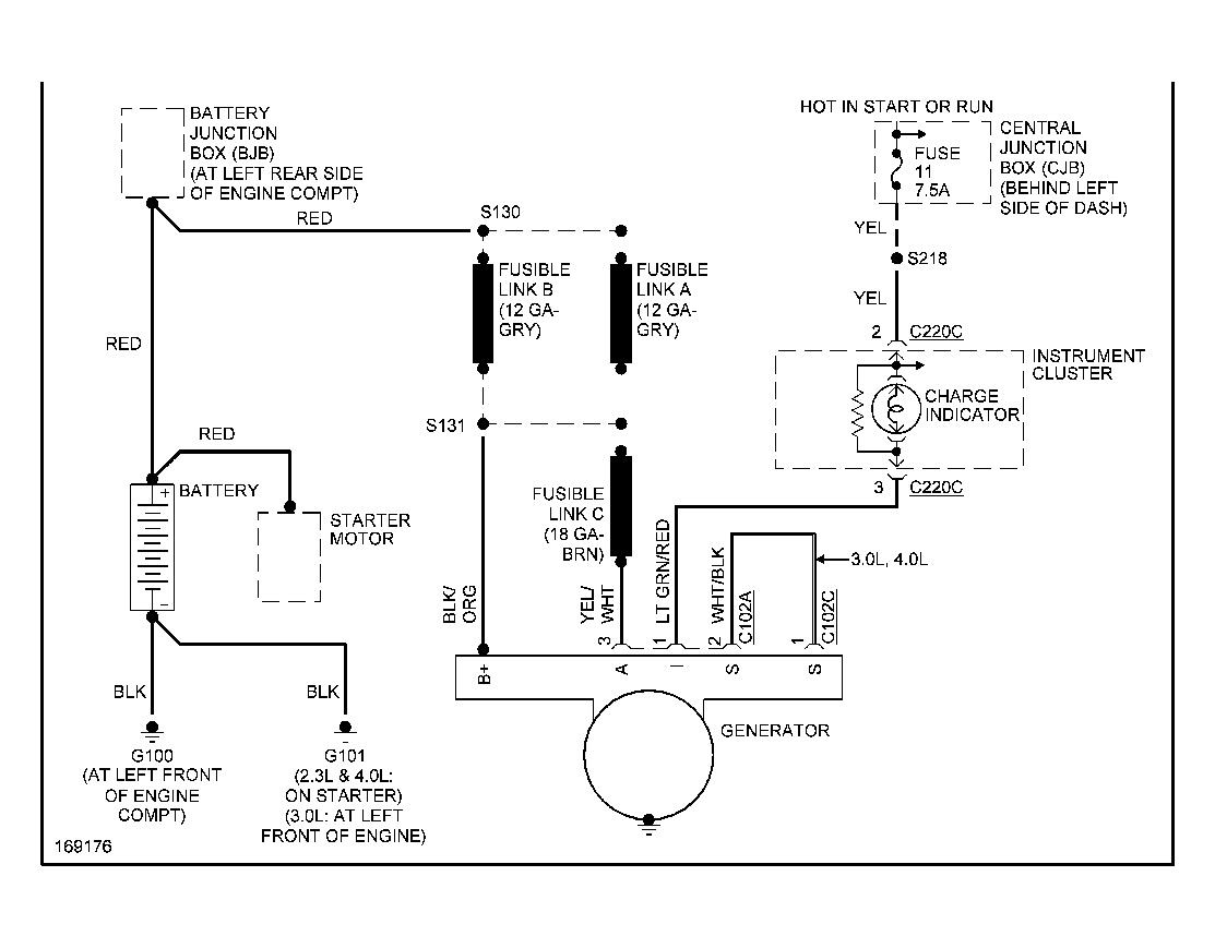

it's either a bad connection........or a component in this diagram from "mitchell i" ("charging system")
i'm sorta betting on a fusible link
Check out the diagrams (Below). Please let us know what you find. We are interested to see what it is.

I checked the voltage @ the battery and it ws the same on the hot wire at the alternator so, I wouldn't think it would be the fuseable link. Do you?

Yes I had the battery tested twice and it passed with flying colors. I noticed the same thing that you noticed that there are 3 fusable links so, I'm gonna break out the light tester and hopefully find the problem. I really appreciate all your helpful advice and if you have any more suggestions please feel free to let me know. I can use all the help I can get...lol thanks again. I will keep you posted.

one of the fusible links ends is just about corroded off this happened to me it was a real head ache
