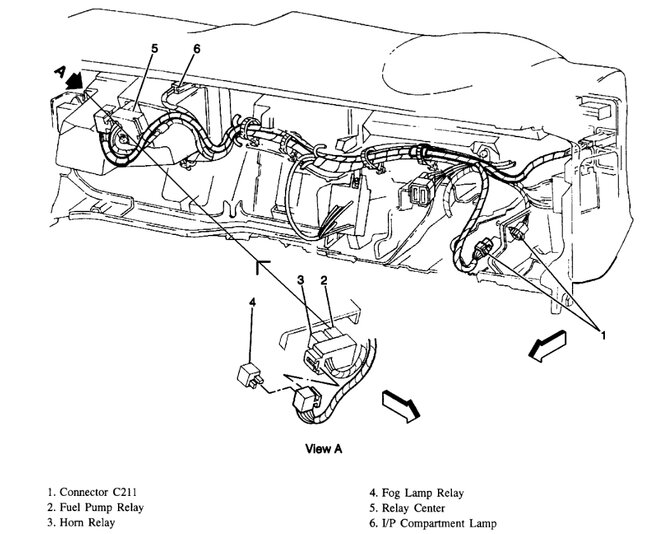

I would swap out the fuel pump relay. here is the location so you can make the swap to see what happens. You can use this guide to test it as well.

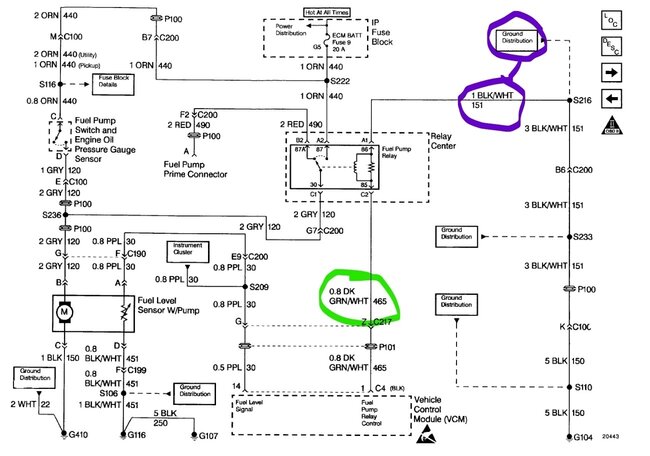

Okay, attached you will see the wiring for the pump. Dark Green w/white stripe at 85 should have power during prime and then in run. 86 runs to ground through black with white stripe. It triggers the relay on. Pin 87 should have power from fuse 9 ECM BATT on the orange wire and pin 30 takes that power and sends it to the pump. You say the prime wire will power the pump, which should mean the circuit from 30 to the pump is good as it uses the same wire.
If jumping to 87 doesn't power the pump, then I would start at the fuse. Then if it's good but no power to the socket itself go to the oil pressure sender and find the orange wire on it, check it for power. If it has power but 87 has no power, then you will want to look at the wiring under the relay center. If there is no power at the switch the problem is between the instrument panel fuse box and the relay center.

To install it nicely you should be able to reach up to the relay box and slide it off the metal tab and bring it down to get to it. The fuse box end is a bit harder, but you remove the two screws in the opening and then the box drops down, the hard part is usually snaking it through the other harnesses. Testing looks like the power is there, just not getting where it should go.

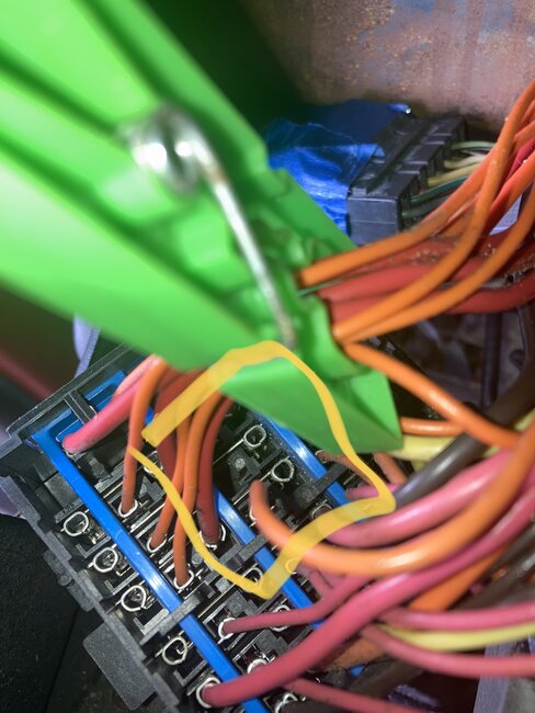

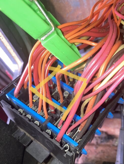

Well, glad to have last night behind me. Figured I’d go back to my original problem, take it from there. I have continuity from the only wire connected to fuse 9 (orange) to the relay center where the fuel pump relay plugs in. There are 5 wires connected to the spot relay plugs in with red in the middle spot and I’m assuming it goes to the fuel pump test terminal under the hood, drivers' side. I have continuity from PCM to relay center in glove box. I guess I need to check continuity from black and white wire between relay and pump and if any other color goes to pump as well. Once again, thank you for the help.

Both pics are of the fuse box spot 9.
Apr 26, 2023 at 3:37 PM

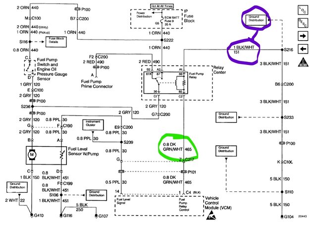

The red wire will be the prime wire, basically it is there to bypass the relay in test cases, like if you needed to pump out the tank or test the wiring and can be used to run the truck if the oil pressure switch fails. The power between the relay and the pump will be the gray wire, it is also the power from the oil pressure switch.
In your picture test the orange wire, which is the output from fuse 9. It sends power from there to a splice (222 in sch) where the power splits with one leg going to the pressure switch and the other to the relay.

That shows that the gray wire from the relay out to the pump is okay. The orange wire should run to the relay at pin 87 and out to the oil pressure switch with that same voltage.
The power to the pump should only come on for a couple seconds when the key is first turned on, if it does the relay, isn't the issue. A quick way to test the oil pressure switch feed is to simply jump the pins with the orange and gray wires, if the pump runs the wiring is good. If that works but it doesn't come on at all when you turn the key, then there is an issue on the relay side. Your testing already said it didn't prime, but that you did have power at the oil pressure switch. Correct? If that is the case and there is no power at terminal 87 on the relay, then that branch is the problem.

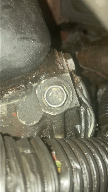

Lol, okay. well, I believe I’m making some progress and I finally found what and where the ground wires were online, and I think it’s possible (mostly since I can barely see one and haven’t found the other yet) that my ground wire to the rear of the cylinder heads might lead me to the promised land. I’m super excited about the fact I can’t see them and hardly get to them with a wrench. What size bolt head (wrench size) am I needing for this and is there any particular way of going about this? I’m trying not to remove the distributor if I don’t have to because I’m not eligible for another up in pay grade for at least a year (joke). Any advice is surely appreciated. Oh, alright, tornado warning just appeared, you know what they say, when it rains, i guess you might get a tornado.

I've repaired so many of those grounds I lost track. It's normally either a 10 or 11 mm, guess it depends on who grabbed the bolt, a flex head ratcheting wrench is a good thing there. Keep your head down those atmospheric vacuum cleaners can cause problems.

This one on left side facing trans dipstick tube is ever so special to try and get a wrench on, I haven’t located the other yet, it can’t be too far, just behind something.

Do you happen to have an image of the other bolt? because if the land of milk and honey is behind the pic I sent, I’ll never see it.
