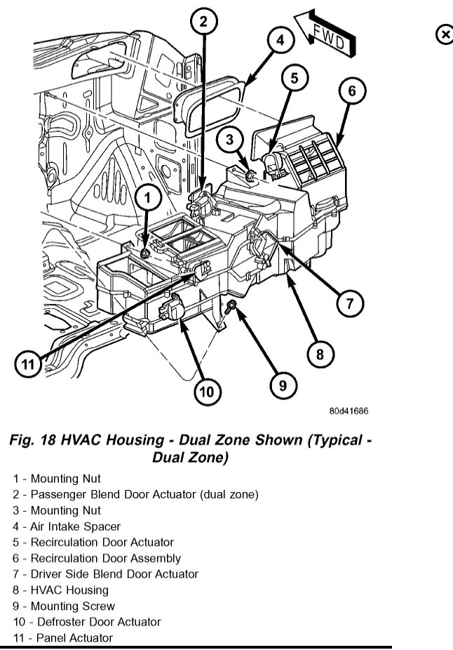

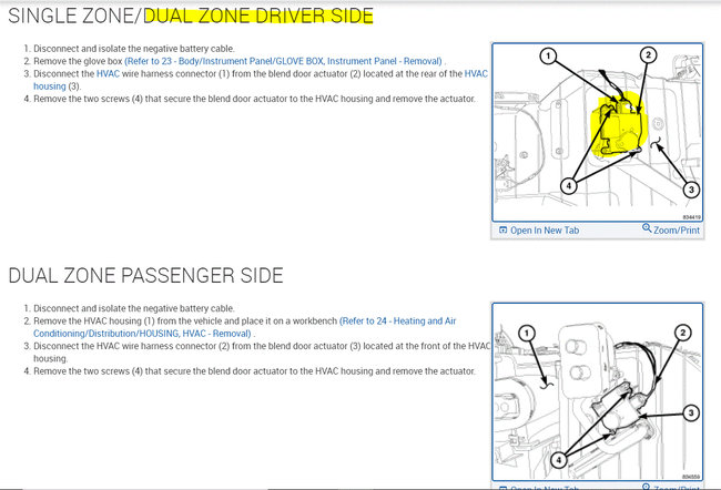

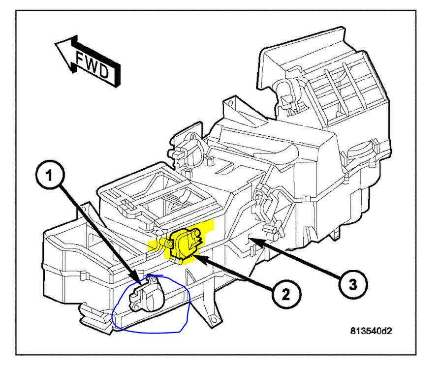

Where is the blend door actuator located for the heater on the drivers side on the truck listed above 1500?
Aug 1, 2020 at 4:00 AM

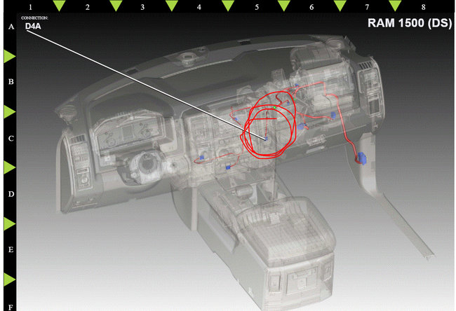

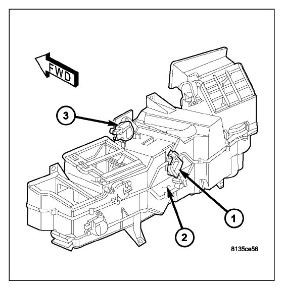

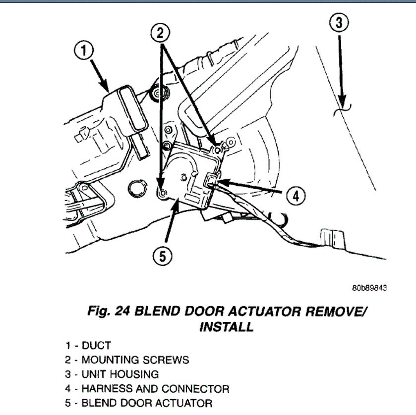

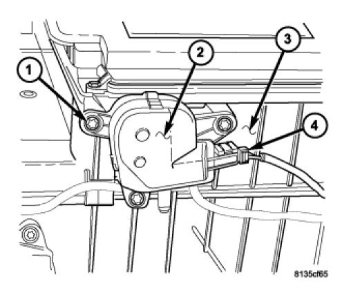

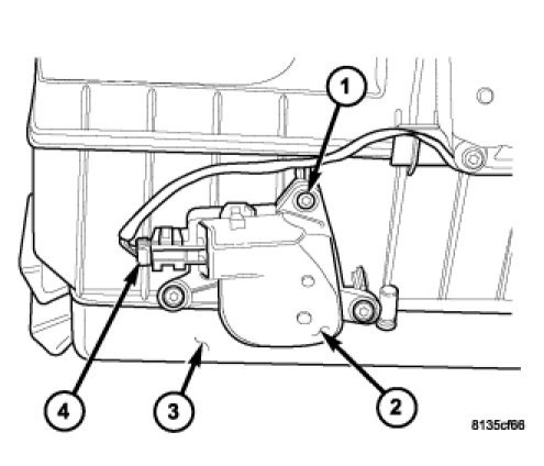

Pic 1 below shows the locations of both. The second pic gives a general location.
The directions for removal are in pic 1 and the install are in pic 3.
Here is a link that shows in general how one is replaced. I'm adding it simply because it is more descriptive.
Aug 1, 2020 at 11:20 PM
MARVIN BERGMAN
So is the blend actuator on my truck is behind the center dash panel or behind the glove box?
Aug 2, 2020 at 10:47 AM

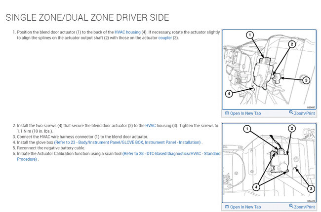

The one for the left side of the vehicle (driver's side), will be behind the glove box and to the left toward the rear of the HVAC box. The passenger side actuator will be toward the front of the same HVAC box. The directions indicate that the glove box needs removed. If you need help with that, let me know.

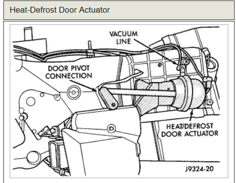

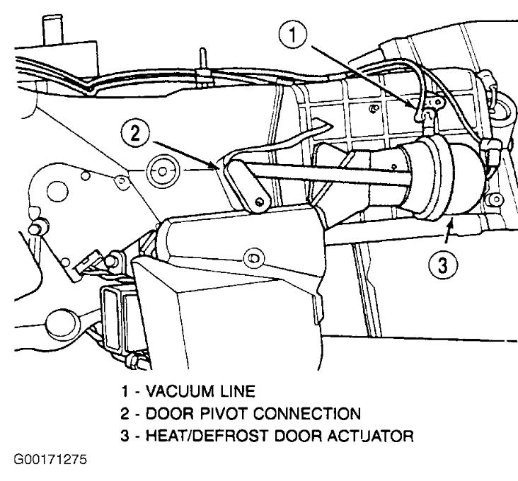

RGR_RAM2500

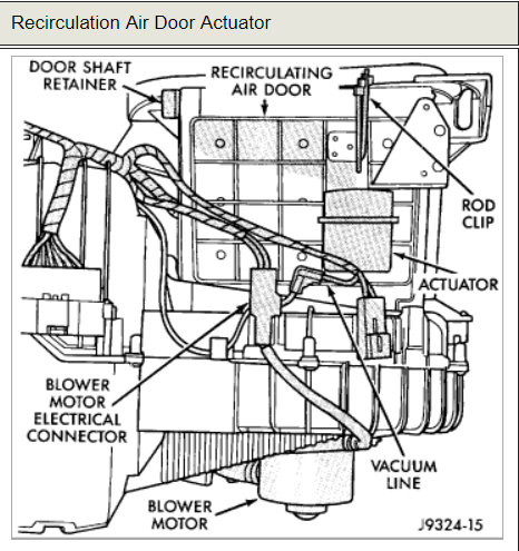

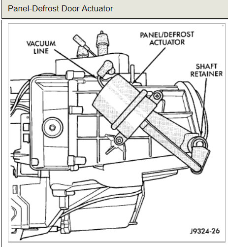

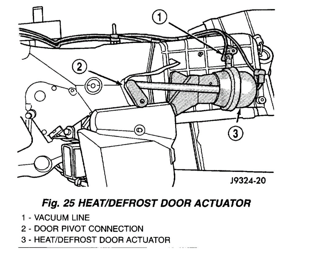

The airflow in my truck only comes out of the front ducts. It will not come out of the defrost or floor heat ducts no matter what mode is selected on the selector switch. I get good air flow in all fan speeds and the heat/cold switch works fine. I get hot and cold air normally, but I cannot get the flow to change from the front vents to anywhere else.
Apr 23, 2021 at 10:20 AM (Merged)

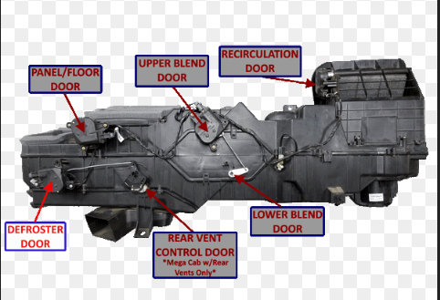

It sounds like an issue related to the mode door actuator. On this vehicle, there is one that directs air to the vents on the dash and on the floor. There is another mode actuator specific to the defroster.
If you look at pic 1 below, I circled the vent/floor actuator and highlighted the defroster actuator.
What I would first do is remove one at a time and see if the actuator responds when you change the mode you want. If it doesn't, then check for power to the actuator. If there is power, the actuator is likely bad. If there is no power, then we need to work backward. A bad ground doesn't seem to be the issue because that would also be affecting the air temp actuator, and you said that works.
Do this and let me know what you find. Also, let me know if this is automatic or manual temp control and if you have dual climate control or single.
I will watch for your reply or let me know if you have other questions.

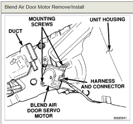

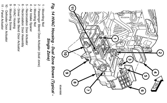

Hi
I suspect the blend air door actuator isn't working properly. The actuator itself may be bad or you may have a door hanging up.
The actuator is electric. Here is a link that explains how in general one is replaced and common symptoms. Take a look through it.
Here are the directions specific to your vehicle for replacement. The attached pics correlate with the directions.
The single zone heating and air conditioning system is equipped with a single blend door actuator. The dual zone system has two blend door actuators, one for the driver side blend air door and one for the passenger side blend air door. The same service procedures can be used for each of these actuators.
1. Disconnect and isolate the battery negative cable.
2. Remove the instrument panel assembly.
Fig. 14 HVAC Housing - Dual Zone Shown (Typical - Single Zone)
Pic 1
3. Disconnect the HVAC wire harness connector for the blend door actuator from the actuator connector receptacle..
4. Remove the screws that secure the blend door actuator to the distribution housing.
5. Remove the blend door actuator from the distribution housing.
INSTALLATION
1. Position the blend door actuator into the heater/air conditioner housing. If necessary rotate the actuator slightly to align the splines on the actuator output shaft with those in the blend air door linkage.
2. Install and tighten the three screws that secure the blend door actuator to the distribution housing. Tighten the screws to 2 Nm (17 in. lbs.).
3. Reconnect the HVAC wire harness connector for the blend door actuator to the actuator connector receptacle.
4. Install the instrument panel assembly.
5. Reconnect the battery negative cable.
6. Perform the heater-A/C control calibration procedure.
Apr 23, 2021 at 10:22 AM (Merged)

Your truck does not have a heater control valve it has a temperature control actuator that does the same thing. Here is a guide to help you see what you are in for when doing the job.
Also check for vacuum at the HVAC check this guide that shows what to look for.
https://www.2carpros.com/articles/air-vents-stay-in-the-defrost-position
and
https://www.2carpros.com/articles/car-heater-not-working
Here is the location for your truck (below)

The passenger side defrost door must not be closing quite all the way. If I’m on anything except defrost, there’s an annoying whistling coming from there. Is that an actuator or something else and how do I access whatever I need to repair/replace?
Jun 17, 2022 at 7:30 AM
I am thinking you have an issue with the actuator or the door itself.
Do you have a dual zone or single zone temperature control?
If you have a single zone, then I suspect you have an issue with the rod that is connecting the blend doors to the actuator. Basically, they use the same box for dual and single zone, but connect the doors on a single zone with a rod that you can see in the picture below.
Also, you could just have a door issue as these crack and fail all the time.
Here is a site that sells repair kits with metal doors so that this does not happen again if this turns out to be the issue.
https://www.blenddoorusa.com/
Unfortunately, the noise on all settings except defrost typically means the fresh air door is not sealing but let's start with this and go from there.
Thanks
