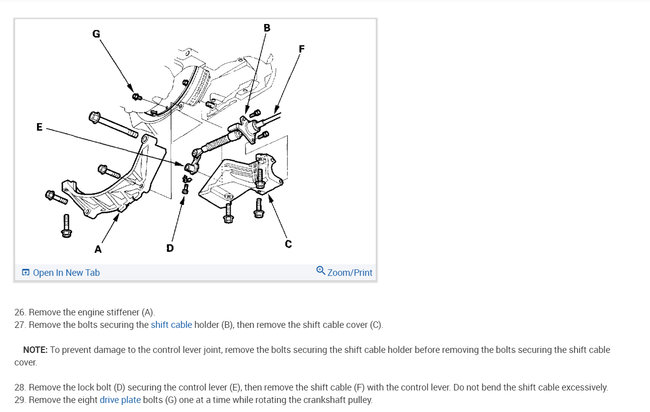

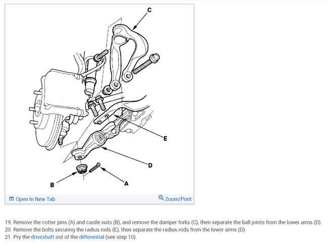

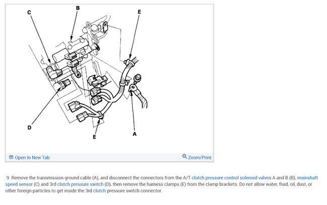

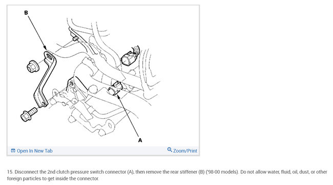

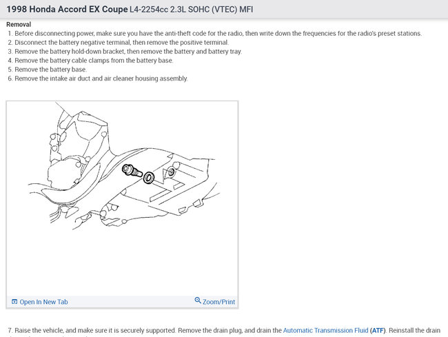

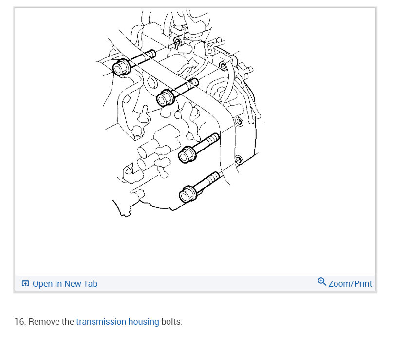

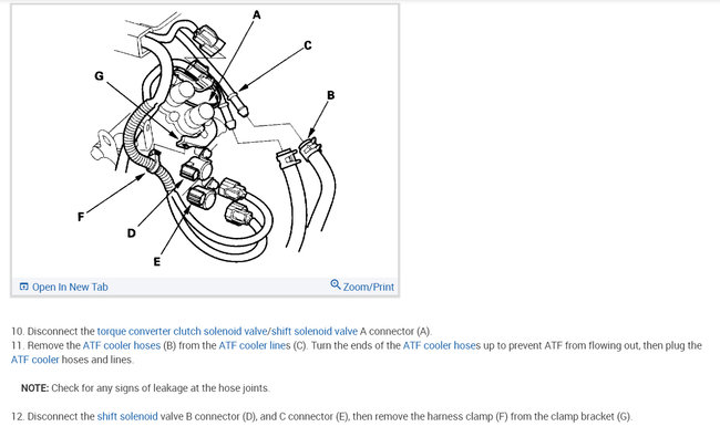

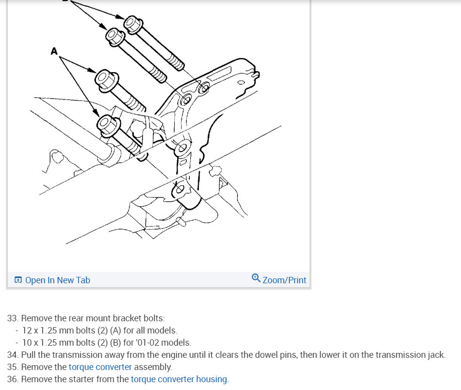

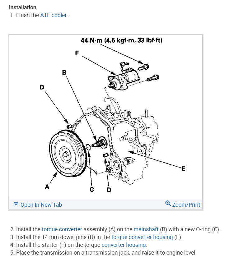

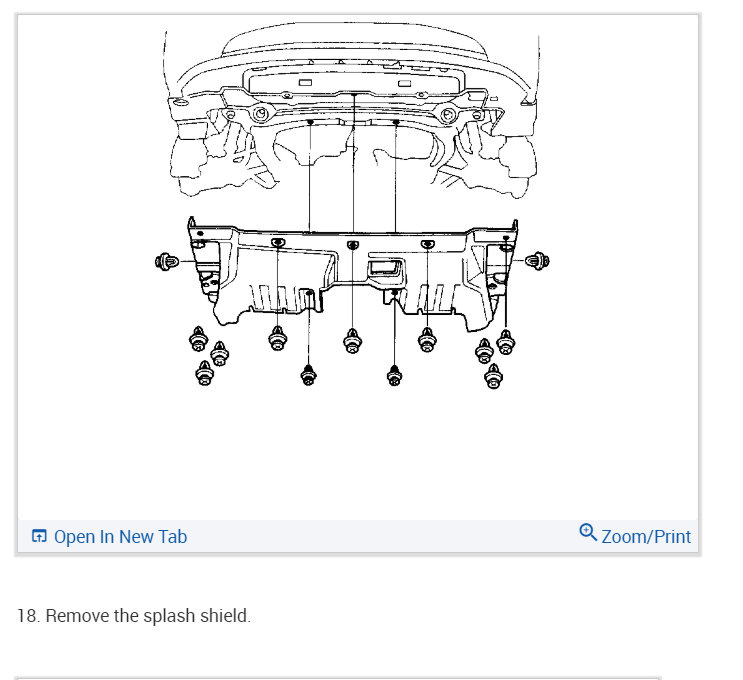

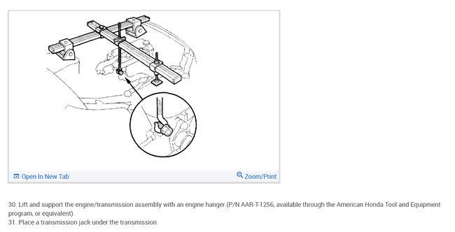

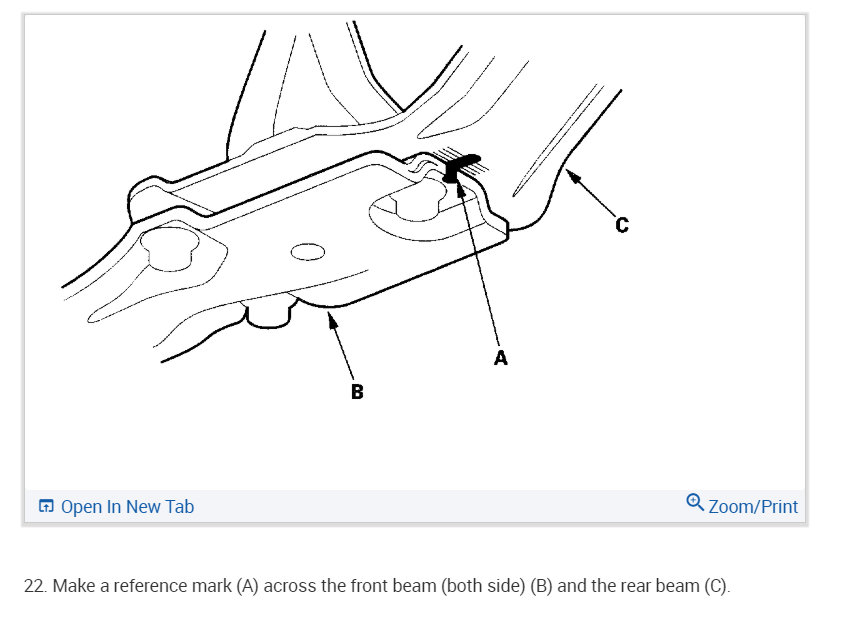

I need to change out the shift sensor but I cant find it can you help me please its driving me nuts! its suppose to be on the trans! but its m.i.a! I think I need to replace the transmission?
Apr 17, 2010 at 1:54 PM
KHLOW2008
  • 41,814 POSTS

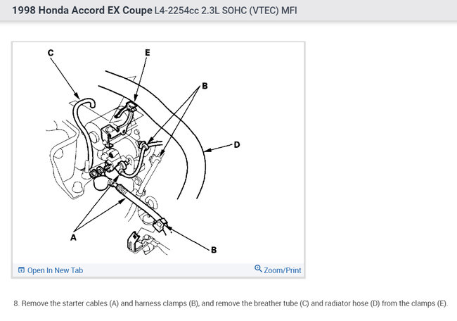

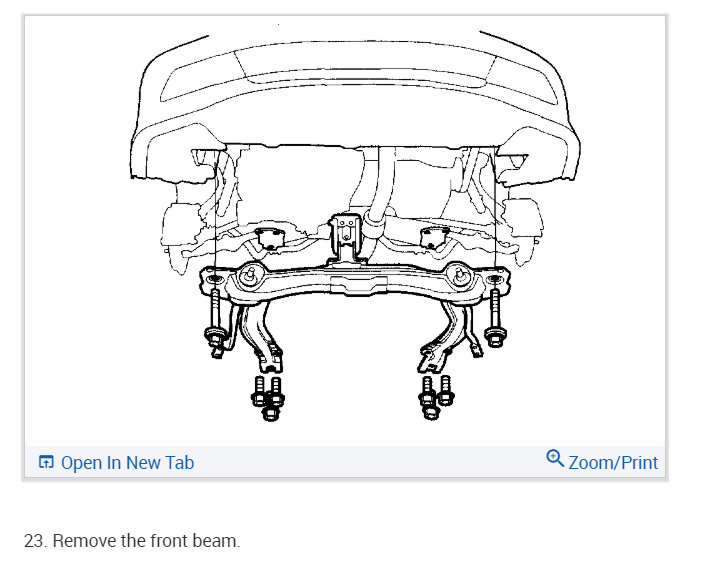

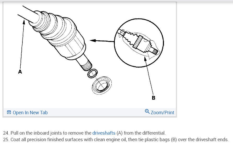

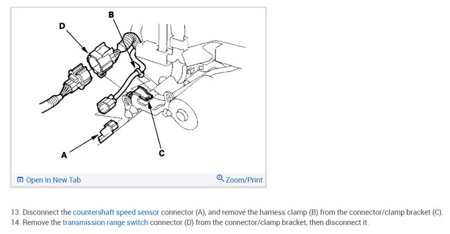

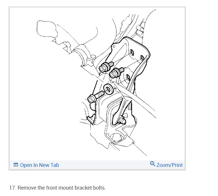

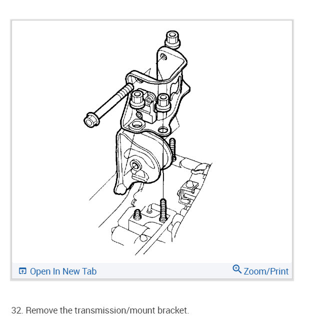

Hi val_mar33,
It does sounds like the transmission could need replacement here are the instructions in the diagrams below. Check out the diagrams (Below). Please let us know what happens.

I will when I get home, I was reading on other sites the shaft speeds sensor can cause this problem?
Jul 7, 2020 at 2:55 PM (Merged)
SATURNTECH9
  • 30,869 POSTS
These are the same sensor. Here is a video of the job being done.
https://youtu.be/f3bETtCIdxM
RUDY2000
  • 4 POSTS
Yep that did the trick once I replaced the sensor the transmission started shifting again.
Thanks for your help this site rocks!

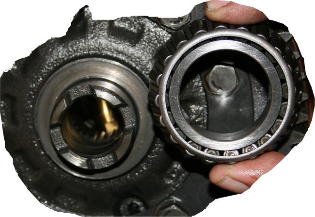

I will show you pictures of the smaller surface diameter of the inner end of the cv axle how it looks like.
however i took of the transmission from the car and i disassembled it .i could take off one of the baring of the differential by hand and put it back what this tell you please ?

Your pictures didn't load. Other people are having the same problem. I don't know what the answer is, but I think they have to be in .jpeg form. I used to be able to use Microsoft Word to draw pictures, then copy them to Microsoft Paint and save them as a .jpeg file in the drop down menu. Maybe that still will work.
Jul 7, 2020 at 2:56 PM (Merged)
ZEMORZEMOR
  • 486 POSTS
ok i upload one picture of the axle end . the problem was the size of the picture the website does not accept big size pictures so i had to cut it using paint
CARADIODOC
  • 34,308 POSTS
Wow. You definitely do have an issue there. Look for a bushing outside of that splined gear that's chewed up. The gear can be loose. It meshes with two other similar gears. Along with the one on the other side, they all rotate inside the differential assembly as a unit. They won't cause a vibration, but that bushing will let the inner cv joint move away from the axle seal too much and cause the leak you found. You might be able to replace that bushing by using a special tool to pull it out once the seal is removed. The new bushing is tapped in but be careful to not twist it or push it in crooked. That can deform it and cause it to rub on the cv joint and fail again. Use a new seal too.

i disassembled the transmission i found metal shaving where the outer bearing race lives ( transmission housing) . i could remove one of the two bearing by hand i know these bearing should be pressed in . what is the issue here i could not figure out .
CARADIODOC
  • 34,308 POSTS
Not sure what issue you're referring to. That bushing is pressed in but to my knowledge, there's no bearing that's pressed in. If you remove the small bolt in the differential that lets the large round pin slide out, that will allow the two axle gears to fall out or be lifted out. That large pin also has two similar gears on it. Those will fall out too. None of those four gears ride on bearings. The outer two do turn with the cv joints, but in relation to the housing they sit in, they only turn a little, and very slowly, when the two front wheels are going at different speeds, (turning a corner).

this is the picture of the bearing that i talked about
Jul 7, 2020 at 2:57 PM (Merged)
CARADIODOC
  • 34,308 POSTS
I don't see anything obvious there, but it's hard to tell from a picture.

i know they press in those bearing on the differential house, but mine i can put it in and take it off by hand its not tight on the differential anymore . what could causes that?
