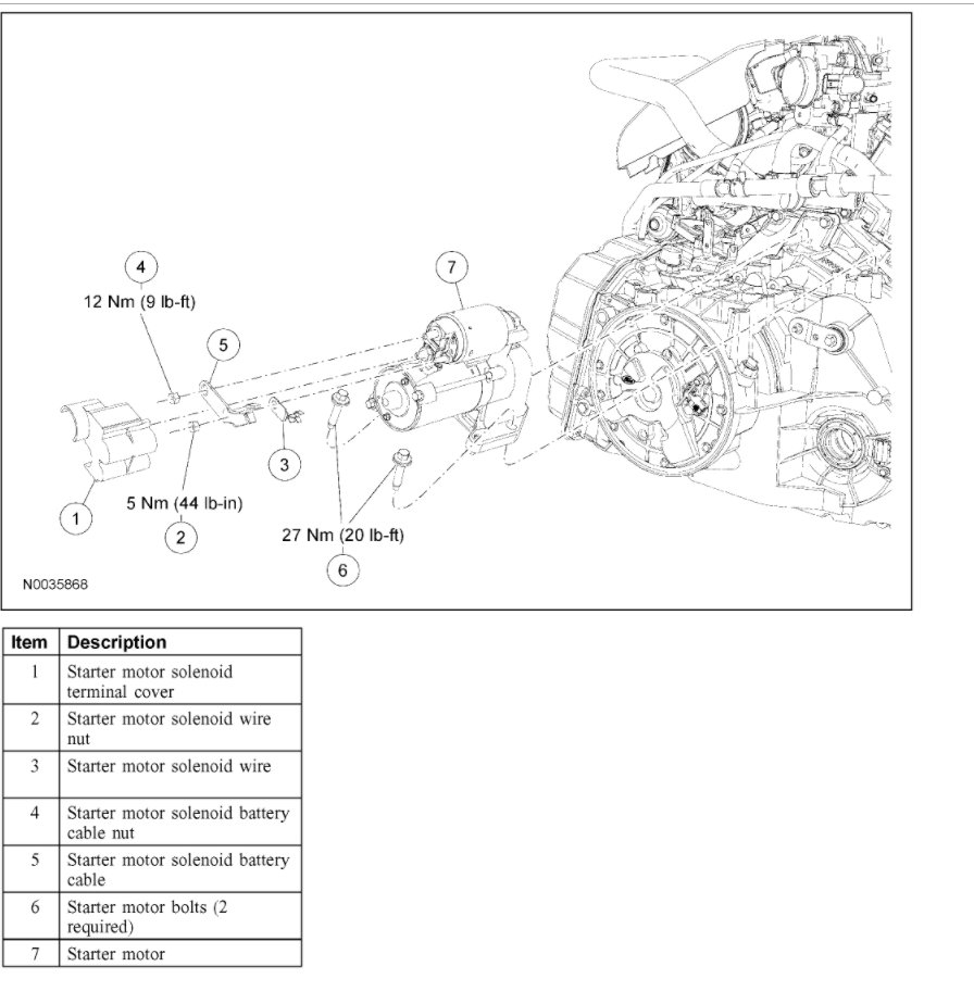

My daughter's vehicle listed above wont start. When I turn the key, I get a spinning noise. I have put in a new battery, then a friend put on a new crankshaft , we have checked that its getting fuel, checked the camshaft , we even took the front clip off and took out the radiator and replaced the starter, which was a bitch. Still nothing but a spinning noise. Please, I need help, my daughter and granddaughter have been sleeping on my floor the past month while I've been trying to do what i can to fix her car, I'm at a total loss, thank you Tammy.
Also, the alternator was replaced about 4 months ago. I'm not sure if this matters, but when the friend put the crankshaft on, they were suppose to use a certain ford tool to get top dead center, I don't think he did that. And the instructions had gotten thrown away. Not sure if that could mean anything or not.
Aug 19, 2020 at 7:14 PM (Merged)
I think this sounds like a loss of compression. Normally when you say it is just spinning that is the starter but if it sounds like it is spinning faster and not actually cranking then this is due to the fact that there is no resistance from the compression of the air/fuel.
If you can get a recording of what it sounds like when you are cranking the engine that will help identify this.
