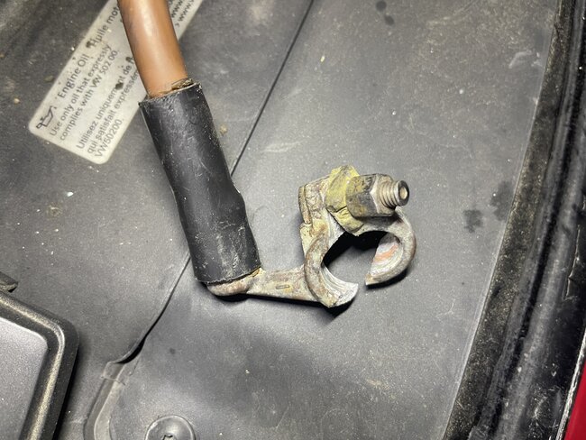

I bought this car as is. When I checked it the battery was dead, so we jumped it to see if it would run and it ran smoothly. Towed it home, put a jumper box on it and it would act if the starter were bad, clicks hard as trying to rotate the motor but the lights on dash flicker and sometimes the connection is lost and then back on. I put a new battery on, negative cable post is broken into half, but I can still place it on the battery post and tighten it a bit, but I noticed while starting it would get hot and get sparky and a very small amount of smoke, so I removed it. Not sure if these cables can go bad as they attach to the transmission as ground don't they? How can I test the cable for issues before removing the starter as a suspect?

Hello, the battery cables need to be tight and secure. If the cable is getting hot and smoking, there is too much resistance, most likely between the battery post and negative cable itself. The proper way to check the connection is to check for voltage drop from the negative battery post to the engine block with the key on, and engine running for a minute if it will start, if not, then just key On, and turn the headlights on as well to load the electrical system some. set your multimeter to DC volts and make sure the meter lead is on the battery post, not the cable, you need to see the voltage drop that's occurring between the battery post and cable and put the other meter lead touching the engine block. So, it's a ground side voltage drop test. If the cable end is broken, it needs to be replaced. A bad ground like that can damage other components. The starter is clicking because there isn't enough current flow due to the high resistance at the broken negative cable end. Can you take a picture of the negative cable so we can see what the broken end looks like?
The starter motor pulls hundreds of amps, that's why the cable is getting hot.

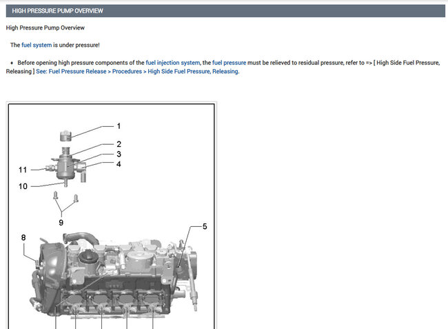

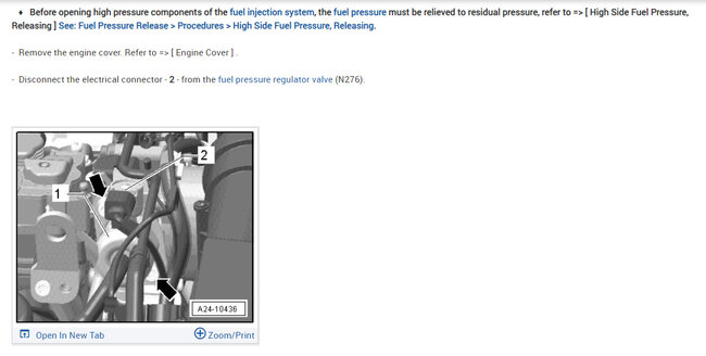

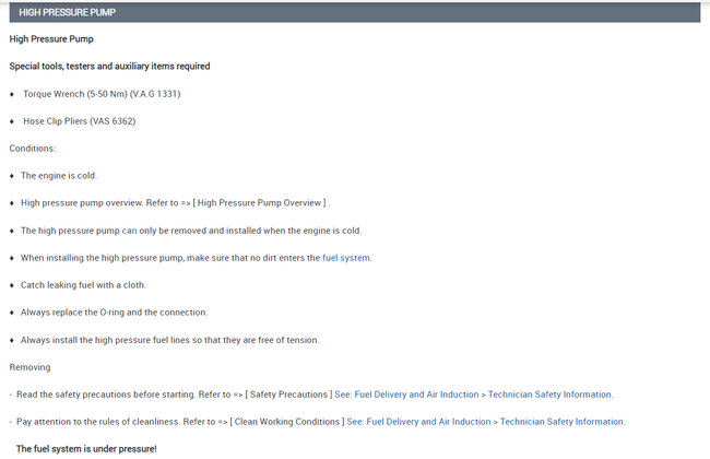

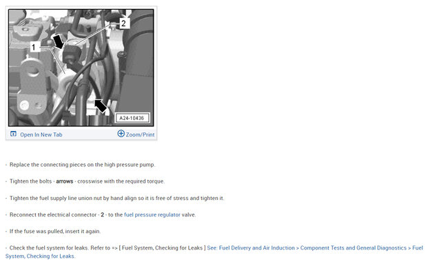

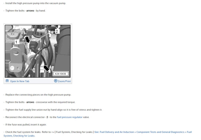

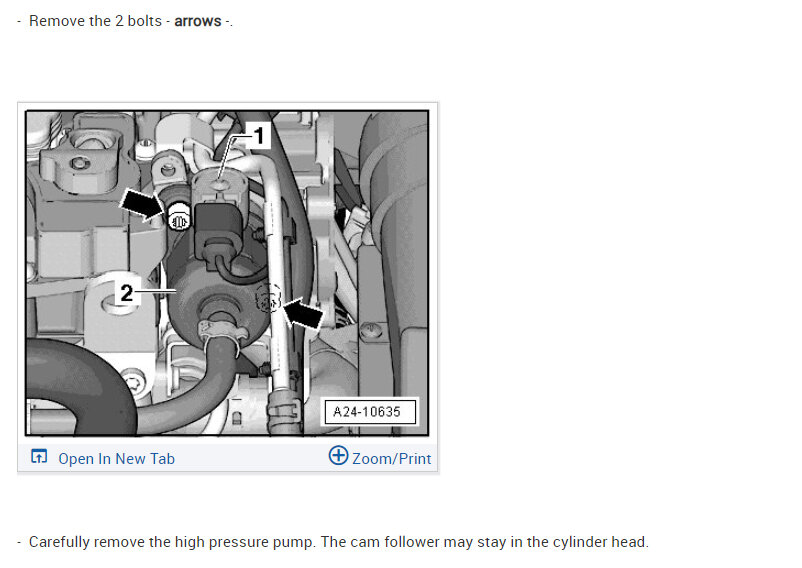

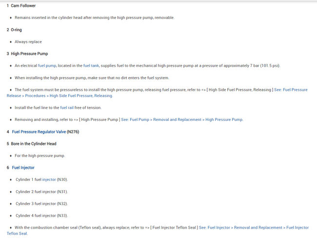

Well it's difficult to say what happened at this point, you did have it running, and the HP pump has to be reinstalled at a certain position and service info here at a quick run through is stating the crank needs to be rotated until the cam follower is at its lowest point, And then install the cam follower into the vacuum pump and then the high pressure pump into the vacuum pump. So, this is no easy task to take apart, just to verify the engine will rotate.
I'd say pulling the starter is the easier thing to do, I take it this was an auction vehicle.

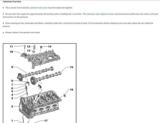

This looks like a serious job to replace this pump, some of this service info is talking about removing and installing a camshaft adjustment valve, there's pages here for just the HP pump. This requires special tools listed here as well.
I do hope you find the starter jammed up into the flex plate, when you get the battery cable hooked up, go in and check the live engine data PIDs and see if there's any fuel pressure reading. I'm trying to find some info on the starter location, there's quite a few design variations listed. ( 2.0L FSI manual, TFSI manual, TDI manual trans,) Those are the 2.0liter listings.

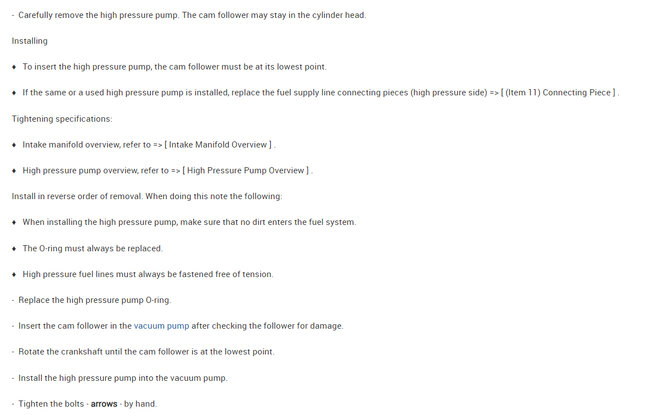

AL514
  • 5,465 POSTS

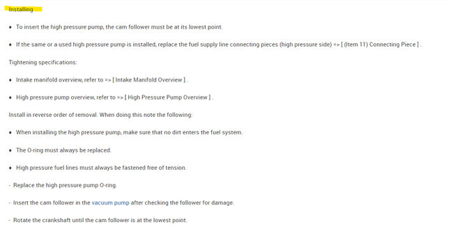

Well, the HP pump needs to have the cam follower at its lowest point, so when you bolt down the pump, there's no pressure being put on it, and then working the bolts down each a little at a time, which is how most of these pumps are installed. It's just odd that there's a vacuum pump that seems to be driven off the same part of the cam, I'll post this section on the vacuum pump really quick. Below is the info on reinstalling the HP pump.
Feb 21, 2024 at 7:00 PM
BHAMDOC1973
  • 2,008 POSTS
Yes, that's how i usually install them, make sure it's all in and slowly screw in the bolts one at a time from side to side until it's in.

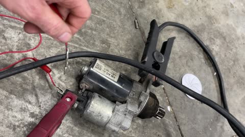

Installed the used cable, went to try it, I got a different noise this time, it's a push button start, so tried it3 times, stopping between each turn and got a lot of smoke coming from around the starter so I stopped. Nothing from the battery cable this time. But I didn't do it long enough for the starter to develop this heat already, very strange. I had my share of bad starters, and they usually have different symptoms or noises, sometimes no noise at all, sometimes a click. When I tried here the noise was weird, grind noise maybe...I removed the + cable coming from battery to starter, and the negative cable from the ground to starter and the harness as well as top bolt, will remove the bottom bolt soon to see what is going on. Is it possible the starter is bad, or the engine just seized and therefore the starter isn't able to turn it and creates this much smoke?
Feb 24, 2024 at 3:55 PM
BHAMDOC1973
  • 2,008 POSTS
Looks like the starter is also not working if how I am testing it is correct. If i pull the gear it comes out by hand. The engine is still not turning by hand. Is it possible even if gear is in neutral that transmission maybe has something preventing it from separating? Driver said car shut off as soon as he changed into 3rd gear at low speeds.

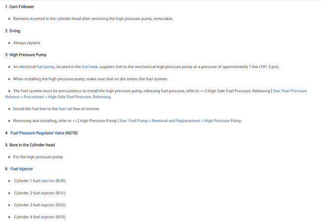

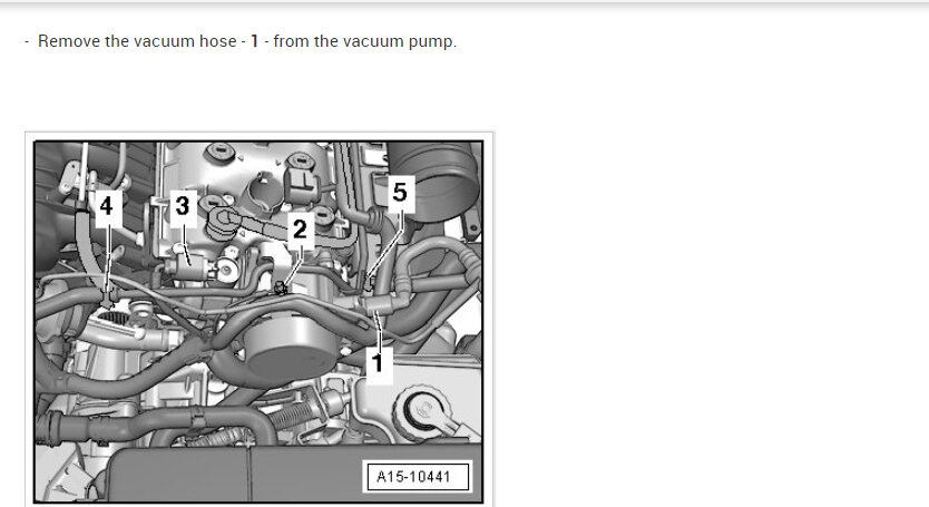

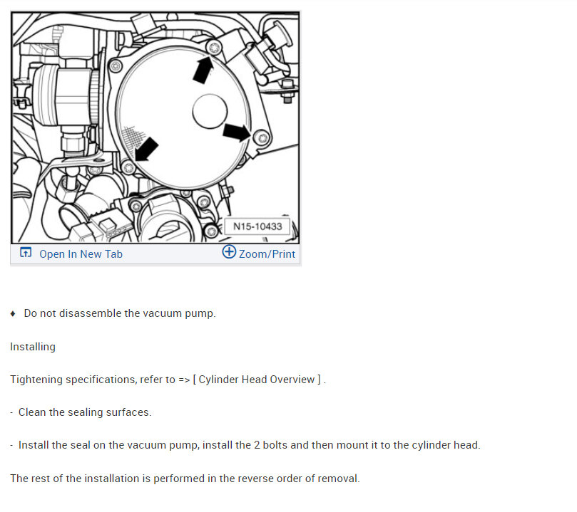

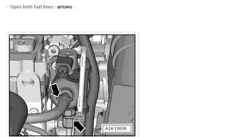

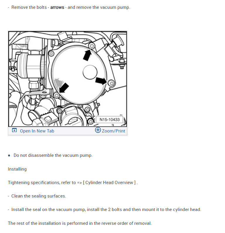

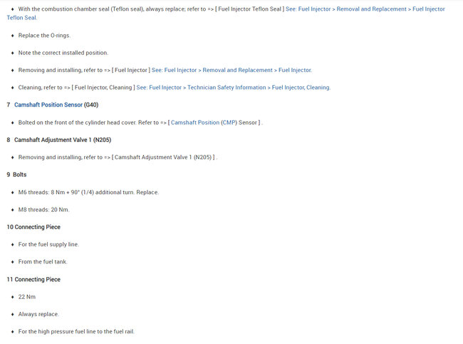

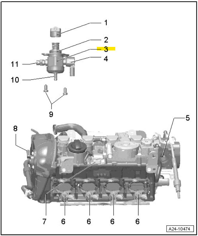

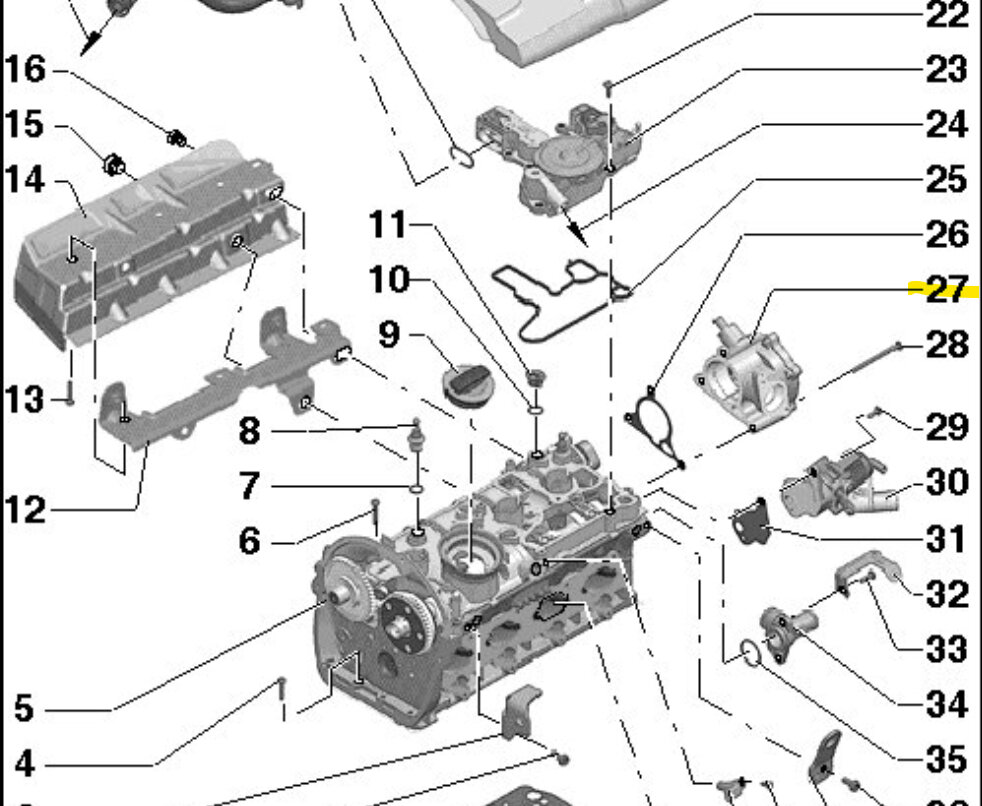

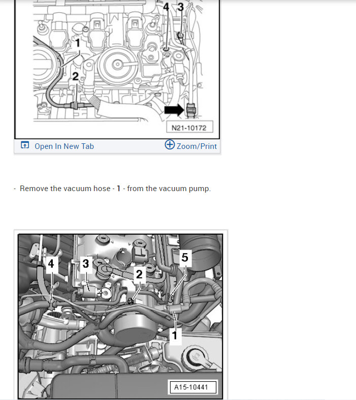

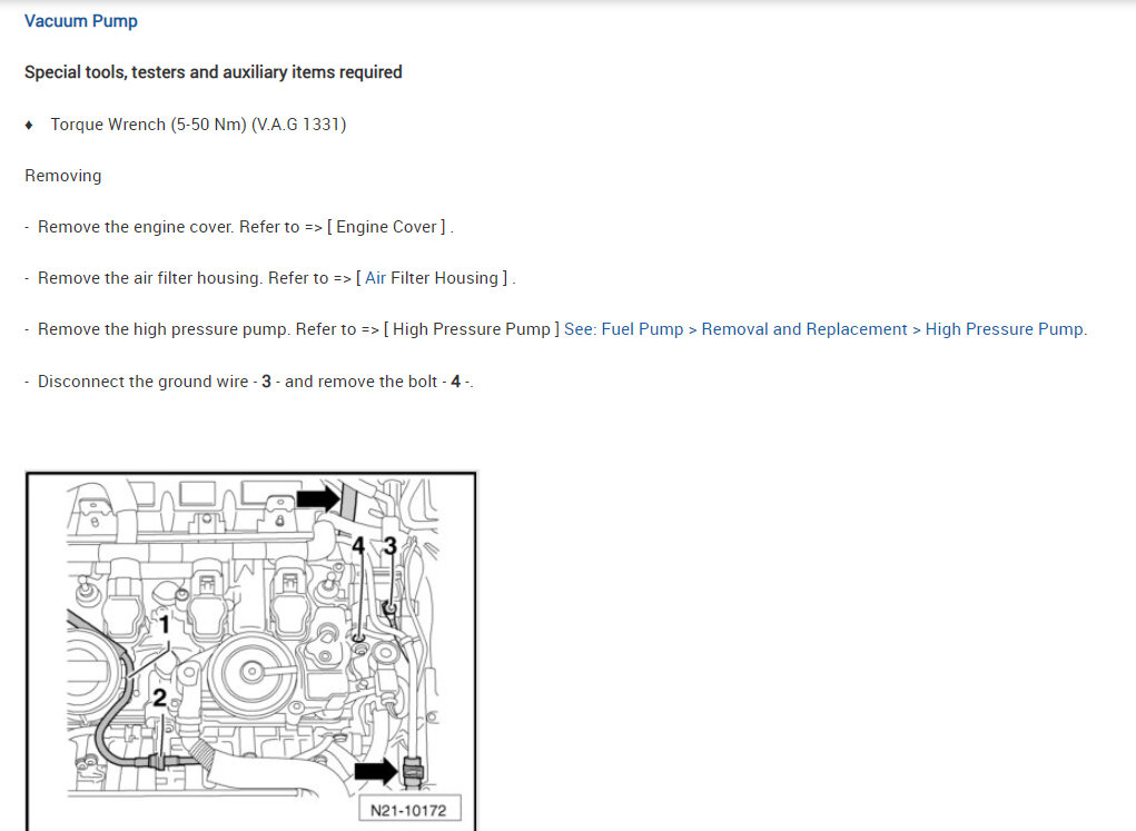

#27 in the first diagram is the Vacuum pump, and the 2nd and 3rd the HP fuel pump. So, it could be either of these seized up, or a cam bearing. So, I wouldn't throw in the towel yet, we just need to figure out what happened.
Do they give you any idea of the condition of the engine at the auction, or is it pretty much take it as is? It seems very odd it would start and run, then whatever happened. The seller must have seen something or known something was up. The whole situation seems strange.

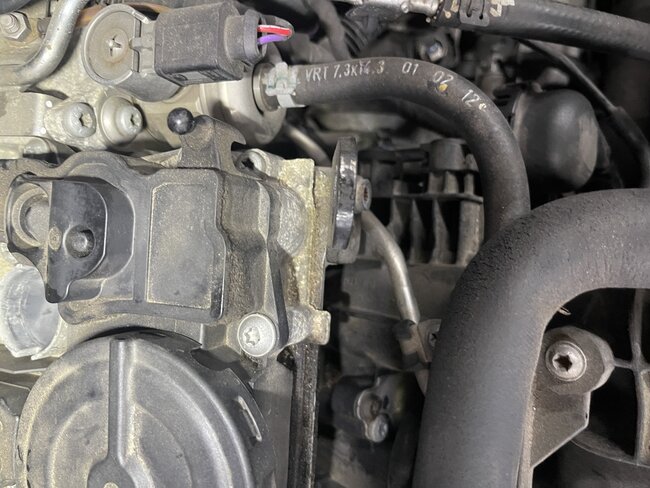

BHAMDOC1973
  • 2,008 POSTS

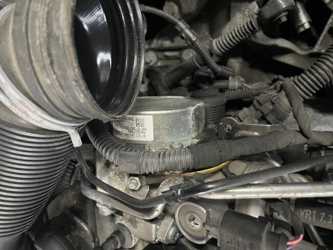

Moved it by a screw driver and it moved same amount that the engine did, couple of inches or so. I actually hear a bump stop around the vac pump whenever the engine stops. Something prevents it from moving either like u said a frozen component or something inside the head. Ugh. I hate these vve covers and their design but i did remove them before including the vac pump and fuel pump. Am just afraid removing them and not finding anything and trying to turn the motor that i mess with timing of the cam, if i only removed the vac and fuel pumps.

BHAMDOC1973
  • 2,008 POSTS
Can i mark the location of cam from inside the cam lobe follower and try turning the engine after removing the pumps and if it does or doesn't take it back where it was? We only talking about couple of inches of movement.

AL514
  • 5,465 POSTS
Let me check service info on that, I believe it said to have the lobe that drives the pump at its lowest point, which in your case you can't do right now. But let me look through some Info, on it again. To me it looks like either the vacuum pump or HP fuel pump being seized up is going to cause the same effect. I don't work on VW, but I'll see what it says about replacing either of those pumps, they do list 2 different 2.0L Turbo versions here though, and I'm not sure what the difference is. If you want, you can leave the VIN it might make finding the correct info easier.
They have a 2012 VW Jetta GLI (162) 2.0L Turbo (CCTA) or the (CBFA) and those are the differences I'm not sure on, and that vacuum pump is for the brake booster.

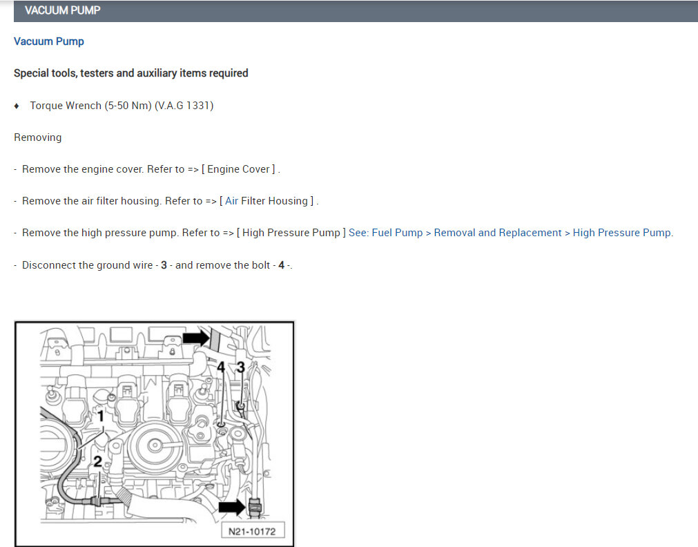

Okay, so diagrams 1-6 are for the HP fuel pump and 7-9 are for the vacuum pump, now obviously the only issue you will have here is the high-pressure fuel, if any in the rail. Since you can't pull the low-pressure feed pumps fuse and run the vehicle out of fuel. I would hook up a scan tool and see if you can check for a fuel rail pressure data PID to verify the pressure is not still high.
