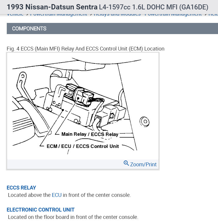

I would say it is the ECU that is bad because I have seen this problem before I would try a used one. Here is the location.

I do not believe it I tried the ECU you said finally and I have been running the car it has never run better I think we got it! I will report back if it does it again wish me luck.

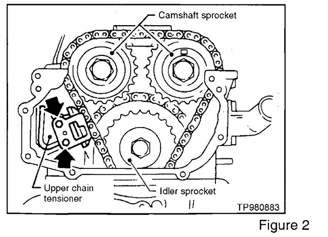

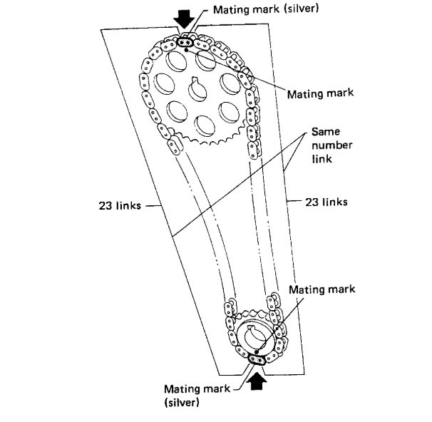

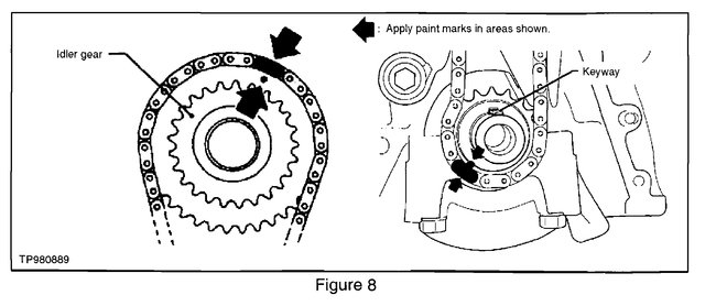

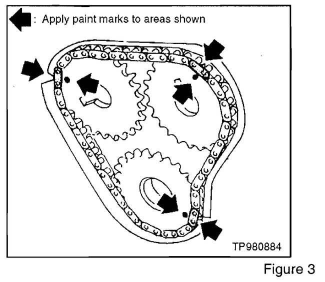

After repairing the cylinder head and put car back together car starts and idles but immediately shuts off when gas pedal is pressed.
Aug 28, 2020 at 9:50 AM (Merged)
Welcome to 2CarPros.
Have you checked for vacuum leaks? Also, does it idle smoothly? Have you checked fuel pressure?
Next, I attached three pics of timing marks. Make sure they were where you set everything.
If possible, can you record what is happening so I can hear the engine idle and what happens when you hit the gas?

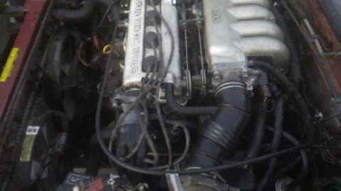

Thanks Joe. Okay, here's a clip maybe you can shed some light end end my weeks long headache. also there's no check engine light on. Thanks again
Welcome back:
Did you upload something? If so, it's didn't come through.

Okay, I'll try again having some phone issues.

I think I got it this time. also the check engine light is not on. thanks again
Welcome back:
It honestly sounds like I hear a knocking. Any smoke from the exhaust? Any coolant usage? What was done to the head? Also, are you certain you have the timing right?
If you could, let me know what was done to the head and if it was removed completely.

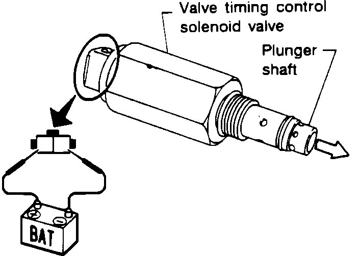

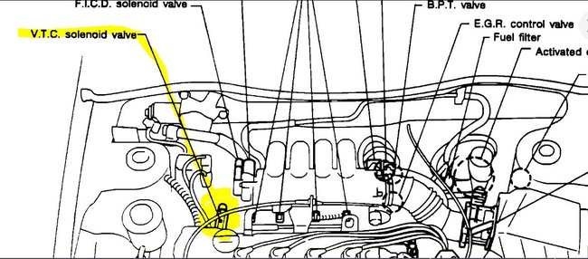

Are you confident about the timing? Also, did you replace the variable valve timing control solenoid?
I attached two pics. the first shows the VTC solenoid location. The second shows how to check one. Here are the directions for testing:
__________________
1. Disconnect the solenoid connector.
2. Apply battery voltage to the terminals as shown.
3. The solenoid should make a clicking sound when voltage is applied and released.
4. Make sure that the plunger shaft protrudes.
Replace the solenoid if it fails the above test.
_______________

Thanks a lot. well the timing I want to say yes I feel confident, but I'm not certain maybe 98%. I did three times I believe and no I didn't replace the valve it failed. so I'm going to replace I'll let you know what happened.
