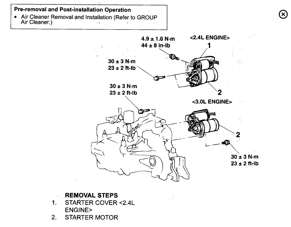

It sounds like you have a starter that is out. Here is a guide to help you check it out. Look toward the bottom of this guide:
https://www.2carpros.com/articles/car-engine-will-not-crank-over
If the starter is getting power with the key in the crank position is it bad. Here is a guide to let you know what you are in for when doing the job:
Here is a diagram (below) on what it will be like on your car.

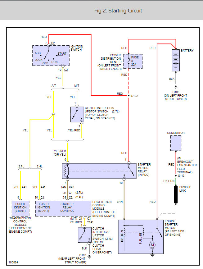

CARADIODOC
  • 34,306 POSTS
The starter circuit can be split into three smaller circuits for troubleshooting. There are a couple of different ways of going about this depending on whether you have a voltmeter or test light and know how to use them. As an alternative, to narrow it down, you can remove the starter relay to bypass it with a jumper wire, or you can pop the cover off, reinstall it that way, hen squeeze the contact to see if the engine will crank. If it does, we will know two of the three circuits are working and the battery is good.
It is sounding more like you have a bad starter motor more and more.
Here are some guides that will help you and a wiring diagram below:
See where you are losing power.
You will need to jack the car up safely as well.
Please let us know what you find.
Cheers
