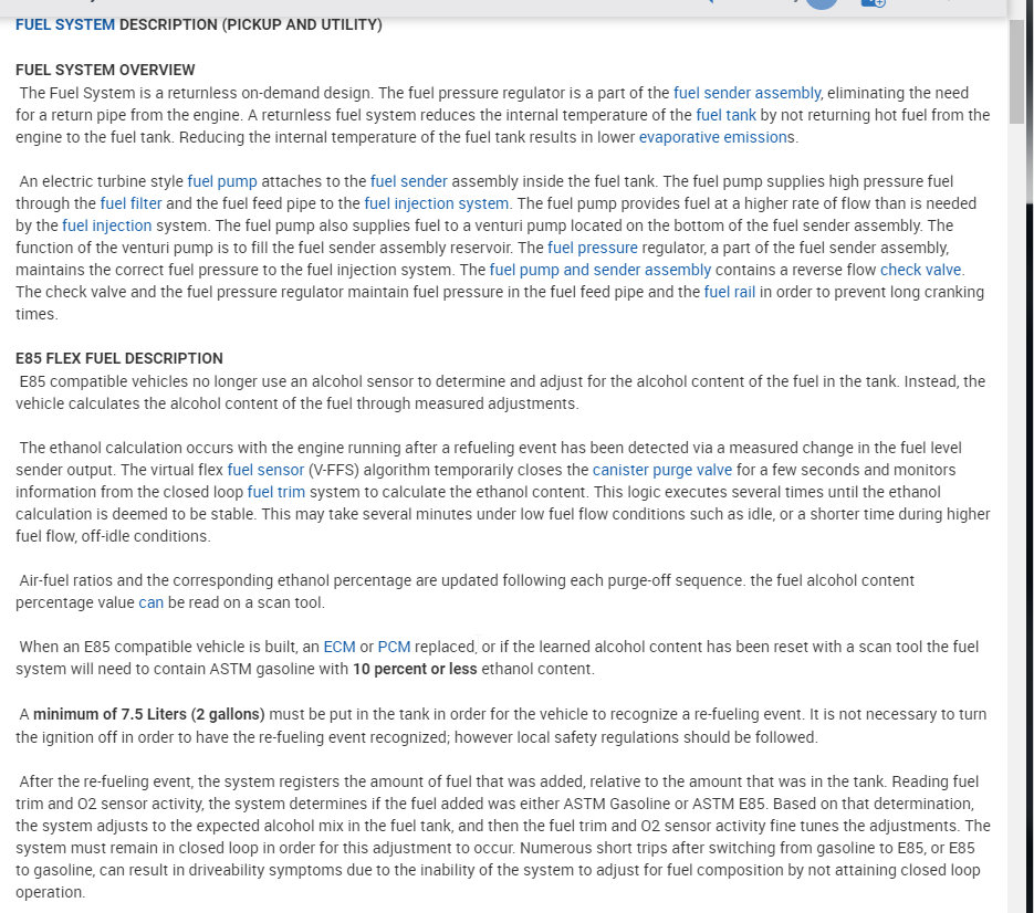

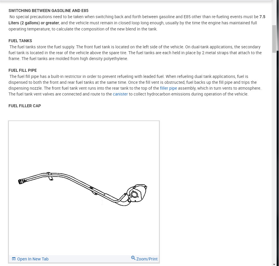

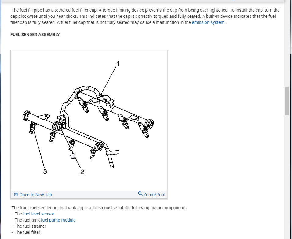

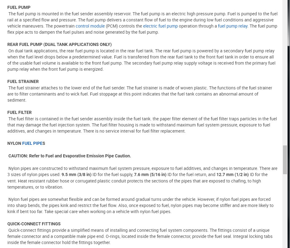

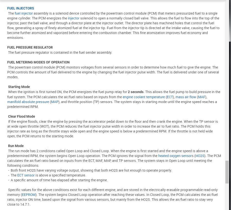

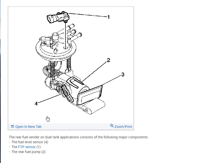

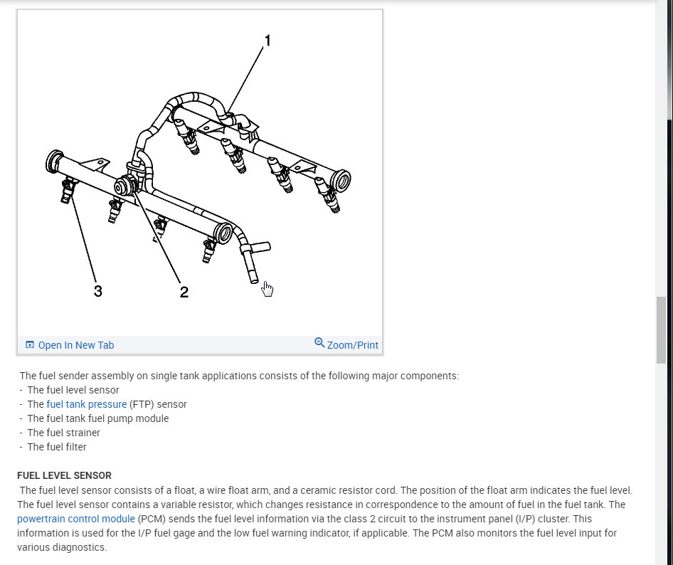

The fuel filter is part of the fuel pump assembly on this vehicle. I attached the detail about the fuel system for your review.
Just so I am clear on what the issue is, the vehicle stays in the same gear until it reaches 4,000 RPM's in every gear? Or are you saying that it feels like there is low power until it reaches 4,000 RPM's?

There is no inline fuel filter for this vehicle. Check the diagnostic service codes and the data list it could have a faulty sensor causing a lean condition. Check the quality of the fuel it could be contaminated. Check fuel pressure should be 50-60 with key on. Check intake manifold vacuum should be 17 to 21 psi. if lower than specified check air intake manifold for leaks and exhaust back pressure. I'm attaching service guides below for you to reference.

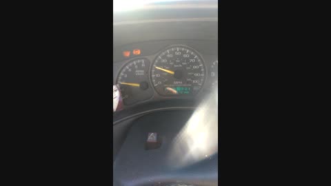

Truck just revs once it hits 3,000 rpm's and will not speed up. Drives fine in first and second gear. We changed the transmission filter but it is still doing it.

SARAH ELIZABETH CHENETTE
Video.
Jun 8, 2021 at 6:54 PM (Merged)
Good afternoon,
It could be a couple of things.
If the catalytic converter is clogged, it will act like this.
The other possibility is low fuel pressure from a bad fuel pump.
The pressure needs to be checked to verify.
The catalytic converter needs to be tested as well. You need a back pressure gauge to verify.

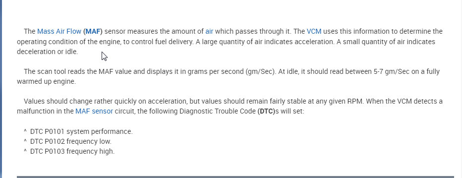

Your probable causes could be the MAF sensor. Please go over this guide
https://www.2carpros.com/articles/engine-has-low-power-output

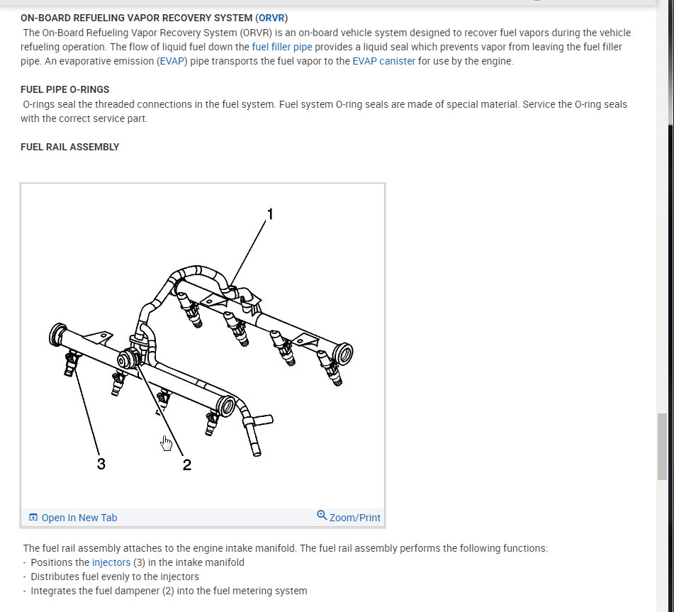

I suggest starting with checking the fuel pump pressure. You could do it yourself to save labor. Many of the parts stores now lend or rent tools, so try that to get a fuel pressure gauge. Also, if you have never done this before, check out this video. It explains what to look for, and it shows how to perform the test.
https://www.2carpros.com/dia/test_fuel_pressure.htm

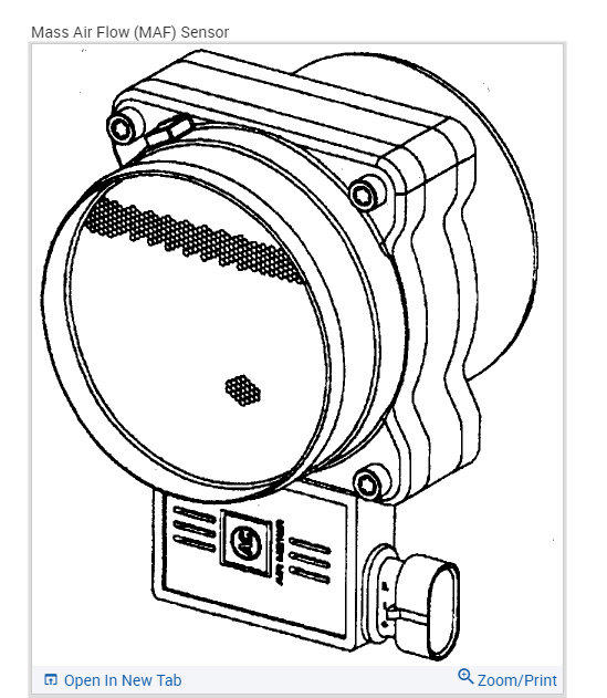

Yes the mass air flow sensor can be dirty causing a problem while not showing any codes.
Here is a guide to show you how to clean it.
https://www.2carpros.com/articles/mass-air-flow-service
sometimes this doesn't work due to the condition of the sensor and you may need to replace it.
https://www.2carpros.com/articles/how-to-replace-a-mass-air-flow-sensor-maf
